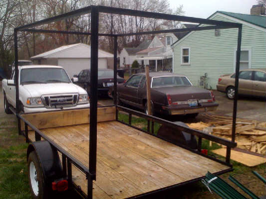

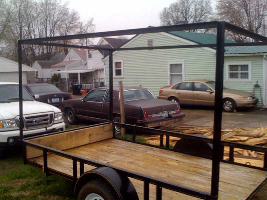

1. A 2009 6x10 trailer with 3500# single axle and PT deck
2. Basic framework welded to the trailer to support roof/walls

I purchased the trailer for $450, registration $25, steel and welding $350 for a total of $825 spent so far.

I would like to begin with the upper walls. I was thinking 2x2 framing to fit inside the rails...possibly 1/4" bolts through the wood framing and steel to secure the completed wall assembly to the framework.. Then possibly skin it with 1/2" cdx. The door will be in the rear as in a traditional Vardo.

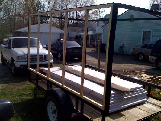

Postby Blotto Bros » Sun Apr 03, 2011 4:45 pm
I had the day off so I was able to get started today. Spent 4 hours of actual work not including "dry time".

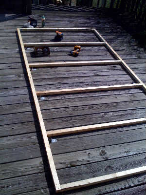

Started out ripping 2x4s down to 2x2 and then cut them to length for the first side panel.

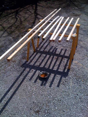

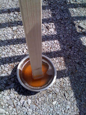

Next I used an idea from this forum and mixed mineral spirits/spar urathane in a 70/30 mix and began brushing on 3 coats with 3 hours dry time between each coat. I also came up with an easy way to REALLY saturate the end grain.
When everything was dry to the touch I assembled the 1st insert using Titebond3 and screws. I also installed huicane trype corner connectors in such a way that every board had at least 2 connected to it.
Test fit the side and it was perfect..I hope that this is a good omen of things to come.
The second side is just a copy of the first. I also was returning from the hardware store and noticed a new roof going on a Macys store...what was interesting was the huge pile of 1.5" poly insulation near the dumpster. I stopped and was able to purchase 8 sheets for $50. There are some small holes in it..but nothing I cant work around.
So now I need advice on how to secure the panels to the frame. I am still thinking 1/4" hex head bolts with washers and nylon stop nuts. Any suggestions???

Postby tsmiley23 » Tue Apr 05, 2011 9:11 pm
For what it's worth your build is going to be bullet proof. 1/2" ply will give you a very strong wall and bolting it together with a steel corner is really over the top. I would probably just use wood screws counter sunk through the steel and into the wood. Either way it will not lack strength.
Here's some of my ideas on a similar build, not a toy hauler but a similar size and configuration:
http://tnttt.com/viewto ... 463#799463
You've got a great start and I look forward to your ideas,
Keep up the good work :applause: :thumbsup:

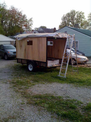

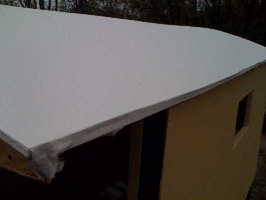

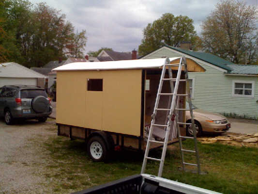

I was able to get the roof on. I fabricaed this by cutting 4 identical arcs from a sheet of 1/2" plywood. I then glued and screwed them together with 70" 2x4 lumber. I made the roof in 2 sections since I had no help in lifting it up onto the top. I then screwed the 2 sections together and then screwed the whole structure to the frame. I finished the basic structure by screwing 3 pieces of 1/2" ply over the frame to form the roof.
I then started to stretch my EPDM sheet over the roof and I must have goofed when we cut it...too short!! :x

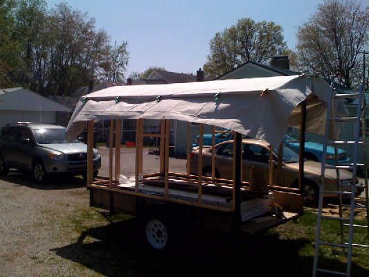

So I decided to go old school and use canvas and glue much like the old deck covers from old wooden boats. First I found an old canvas drop cloth and stretched it over the roof.

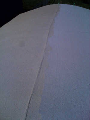

Next mix 1 gallon of Titebond(2) with 2 quarts of warm water. Next I used a clean paint roller to roll on a thick coat of the glue solution. Be sure to work it into the fibers evenly. This is my roof half glued down.
While that was drying I put up the outer wall skins. They were 1/4" Luan.
Next comes 2 coats of tinted primer.
Then 2 coats of white elastomeric roof paint after the glue dried overnight.
I did take advice given and used 3" treated construction screws to connect everything instead of bolts...seems like it will be plenty strong. I was able to walk on the roof and it was as strong or stronger than my house roof.
Next week I will be fabricating the swing out rear door. Well on my way to campable...a LOOONG way from done!

The first call for suggestions is here.
If the elastomeric paint proves a failure what type of roof to cover it with? I was leaning towards metal roofing available from big box but not opposed to other options. My main concern is wind getting under it and tearing it off while in tow....has anyone ever used used this?
Even those souls that are found must occasionally become lost to appreciate what they have.

Postby StandUpGuy » Mon Apr 18, 2011 8:55 pm
Looking good! You are making great progress. If you end up being unhappy with the canvas roof, you can always add over it later.

Postby StandUpGuy » Mon Apr 18, 2011 8:58 pm
I posted my response while you were posting your question.
I would suggest simply buying another piece of rubber roof membrane. You could glue it right over the canvas later.

Postby Blotto Bros » Mon Apr 18, 2011 9:01 pm
Thanks, thats probably the most cost efective...next time its measure twice cut once!!! I have found another use for the other piece so it won't be a total waste.

Postby StandUpGuy » Mon Apr 18, 2011 9:03 pm
The canvas is going to work fine. They used to build row boat hulls that way.

Postby Deryk the Pirate » Tue Apr 19, 2011 7:58 am
Looks Greeat Man! Im so envious.
There are flexible epoxy out there that you could paint the roof with which will seal it and give it a little flex. Cheapest is probably getting another piece of EPDM and going that route. They do sell something to join 2 pieces of EPDM togther...that would be probably the cheapest solution.
I really like the over hang, is that for getting out of the elements or do you have another plan for it? Overall this is looking to be a real strong build with the welded metal framework!

Postby Blotto Bros » Tue Apr 19, 2011 9:32 am
The overhang is my ac on the roof...er in the roof hidey hole. The exhaust portion will be "outside" in the overhang and the cold stays in the 6x10 enclosed portion. If it works out people won't even know it's up there. Translate that to not gonna get stolen or bashed off by trees.

Postby bobhenry » Tue Apr 19, 2011 9:52 am
I think you will find the rubber roof coating will work well.
I have a sweat shirt that has been washed 50 - 60 times in the last 3 years and the polar seal I slopped on it is surviving real well :rofl2:

Postby Deryk the Pirate » Tue Apr 19, 2011 8:48 pm
Thats an awesome idea for hideing the air conditioner and its an overhang over then door.
But I agree the EPDM roof is the best of ideas.

Postby StandUpGuy » Tue Apr 19, 2011 9:14 pm
Blotto Bros wrote:The overhang is my ac on the roof...er in the roof hidey hole. The exhaust portion will be "outside" in the overhang and the cold stays in the 6x10 enclosed portion. If it works out people won't even know it's up there. Translate that to not gonna get stolen or bashed off by trees.
So it is a window unit? That is an interesting idea.
