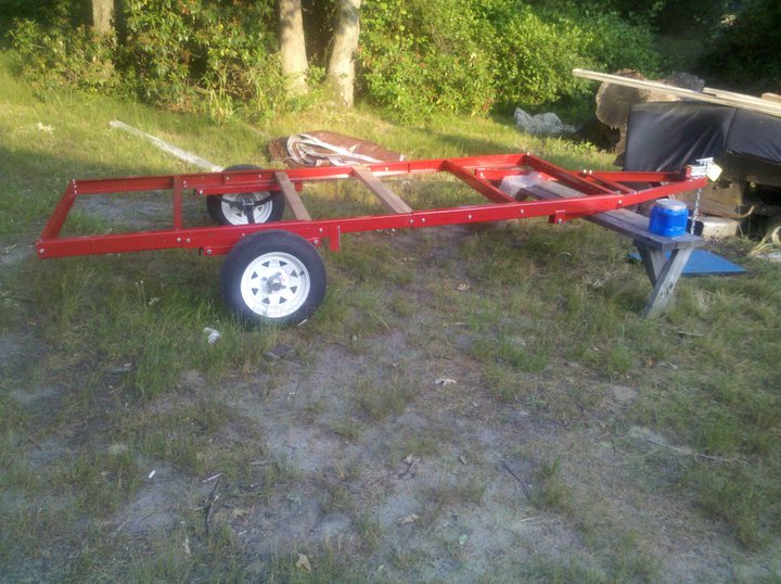

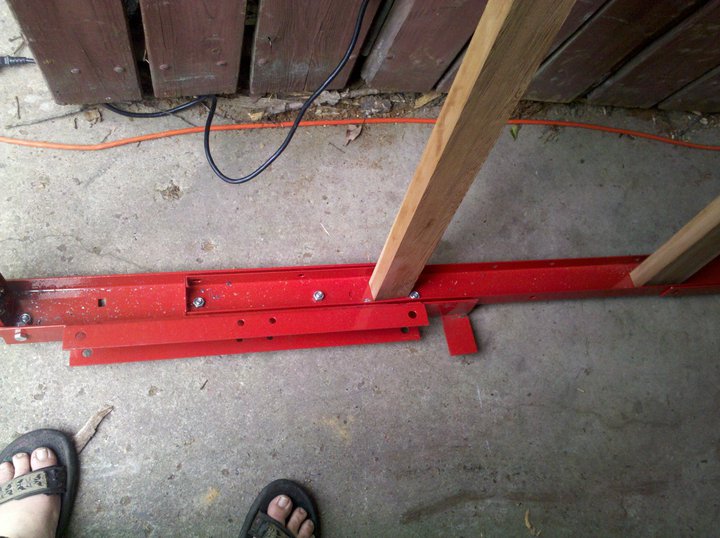

Im takeing Steve's idea of stretching the frame to a 4x10' size and picked up a 65" wide axle to give me a little extra width. My plan next weekend is to bolt a 2"x4"x10' on the outside of the frame to widen it and also give it extra strength. I think Im gonna add 1 more down the middle between the supports to have something else to screw the floor down onto it.
