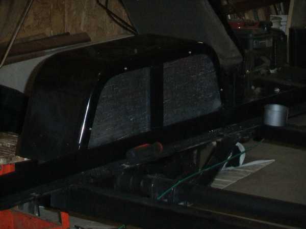

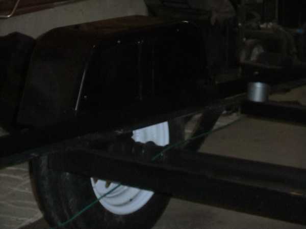

I did a little work on the trailer today, restrung
the taillights to get the wires out of the way, and filled in
the fender openings with tin and sealed them.

Postby Deryk the Pirate » Wed Jun 22, 2011 7:36 am
Interesting... Does fillingin the back of the fender cut down on water kicking up on the bottom/sides of the trailer?
Deryk the Pirate
Posts: 809
Images: 158
Location: Parlin NJ
Postby JohnnyH » Wed Jun 22, 2011 9:41 am
I got a how-to book from Big Woody trailers out of
Wisconsin, this is on of their tips. I don't know if it's
nessesary but it seems like a good idea to me.

Welcome to the forum and the madness. I'm also located in western MN and also started my build with the identical trailer. Others on the forum recommended reinforcing the tongue with diagonal bracingHERE ...something for you to consider maybe.
I like the idea of filling in the fenders. It seems like it would help protect the finish on the sides of the trailer. How did you attach the tin? Welding or glueing it?

The fenders were done with scraps of old ductwork,
cut to shape, drill 4 holes for 8-32 1/2" bolts, lay a bead
of black silicone inside the fender, line it up and bolt it on
[use lockwashers] the seal the inside edge with black
silcone then paint or undercoat.

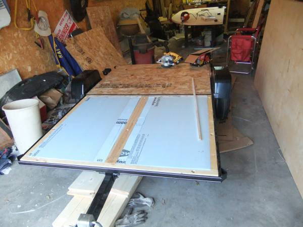

Got the floor just about ready for covering.
ImageI Have a friend who is going to beef up the tongue for me before
I put the walls up.

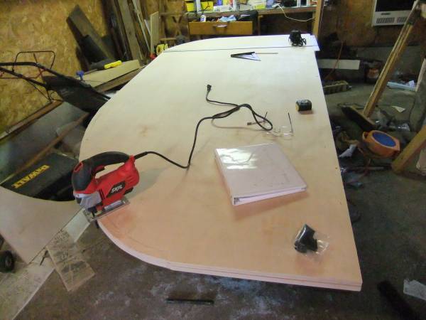

My Birtch plywood came the other day but its been way too hot and humid
to do anything until today. I drew out my profile and did the rough cut.

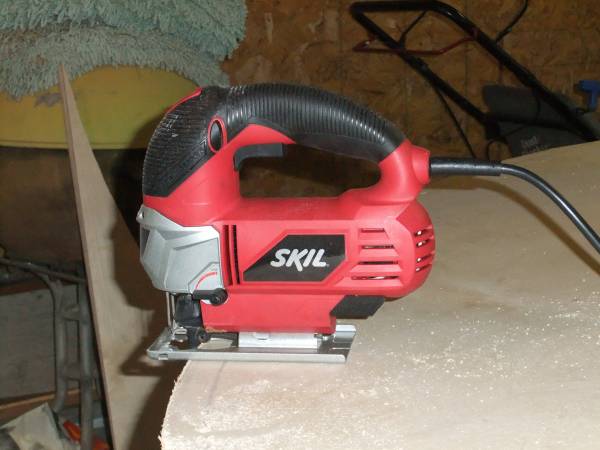

ImageMy cheapo Skil jigsaw worked very well, it cut through 2 sheets
of 3/4 birtch nicely.
