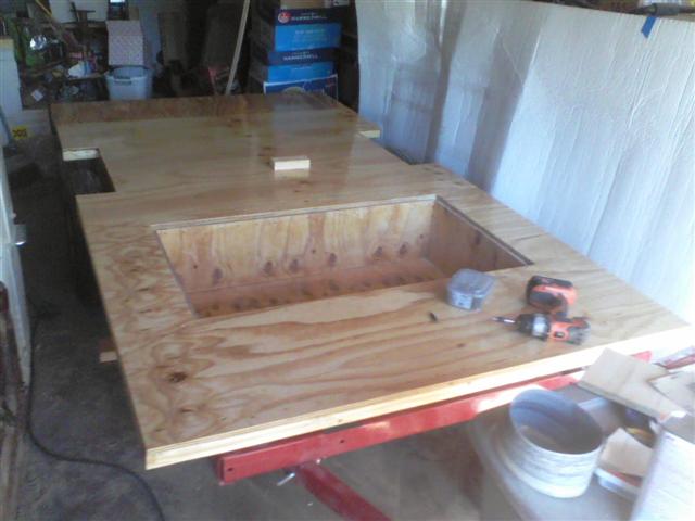

Bought the HF 2K lbs trailer, extended it to 9ft by using the cross members on the sides, plenty strong. The tear will have a foot print of 9 x 5, but over all 11 x 5 (counting the nose an tail). Used 2x3s for the deck frame, attached them with locktite and a Kreg tool. The 2 1/2 inch deck screws worked great, love the Kreg tool. I'm in the process of completing my drop down floor at the moment, its about 10 inches deep. Two coats of RAKA epoxy to cake that baby, then had to re-drill the Kreg holes. The RAKA UV inhibited epoxy soaks in like mad, felt it strengthened the wood well enough for a foot well.

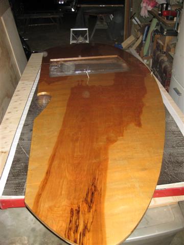

I used the sandwich build on the walls, 1/4" plywood on the inside and out, with 23/32" ply for the center. Cut out quite a bit for insulation, then glued up and pressed together with heavy rocks(wife's parents owned a rock shop). I didn't get very good 1/4" ply for the sides and ended up seeing lots of blue streaks and blotches in it so i'm painting the outside black. After a couple coats of epoxy the wood looks good enough for the inside. The wife will be gone next week so I'll give it some primer and enamel with out the ire of my better half.

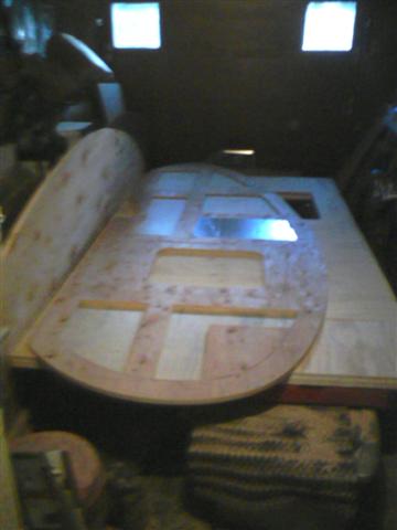

Postby Breezy13 » Thu Aug 04, 2011 8:21 am
This first pic is pretty bad, took it with my phone, but it gives you an idea of the construction method.
This is after the walls have been build and the first layer of RAKA epoxy.
Notice the wires sticking out, switches for the outside light, and two inside will be controlled from here.
Two layers of epoxy for the foot well, re-drilled the Kreg holes and dry fitted it. I have a buddy with a welder that i might have help me support this on the underside. But it will be epoxied and screwed to the 2x3 framing of the deck. This should give me some space to place the table/bed support, and still be flush with the deck.

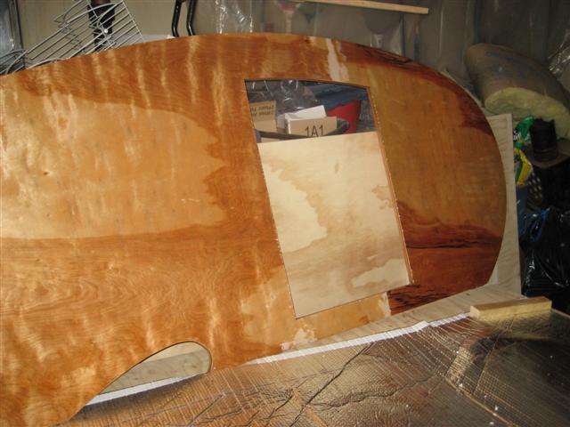

The door and wheel well cut out.

That wood looks great! Really like the "swoop" you used for the wheel cutouts!

I'm going to leave the inside a woody, but if you look close at the wood, it has dark blue knots or something in it, don't like it so i'm going to paint the outside.

The foot well has been finished and screwed in to the deck, wasn't a perfect fit, but made it look good. Just glad it holds some weight!!

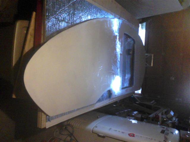

Put on the first coating of primer for one outside wall, the brush strokes left in the finish made me realize I'm going to have to use something like a small roller to get the finish I want.

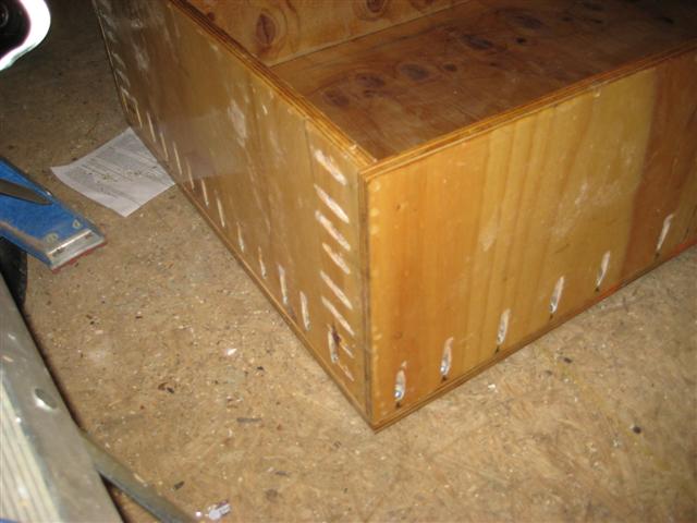

wow! you weren't kidding about the kreg jig! you went to town on that floor box! :shock:
:hammer: :hammer: :hammer: :hammer: :hammer:
if i'm remembering correctly, i think the user manual thing recommended every 6 inches or so(?)
looking great so far though! :applause:

Postby Breezy13 » Wed Aug 31, 2011 1:52 pm
I've got a lot of screws to use up.....found a special on E-bay. Think the over-build bug got me, that foot well also has 3 coats of epoxy....
