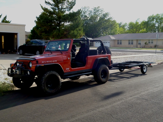

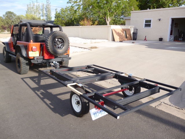

Hey all just wanted to post pics of my progress so far. I have been reading here for over a year and finally got some time to start. My wife, dogs and I are going to Moab next Sept so I have about a year to get this thing built. My TV is 06 Jeep Rubicon LJ and his name is "Willis" after the old WWII Jeeps.

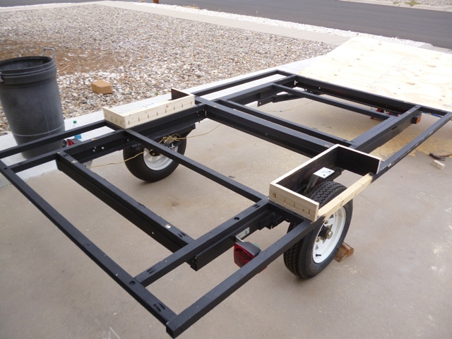

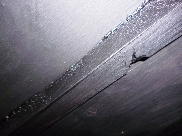

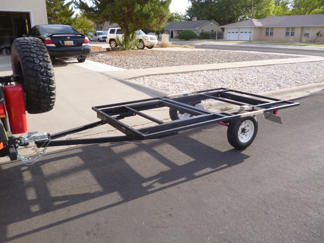

My plan is to build a weekender but a little taller, wider, and longer. I want to do a stripper out of cedar and probably hickory (dad just built cabs and get some free scraps). Wanna do it this way because I want to build a strip canoe next using the strip method (bucket list thing) and I need the practice, lol. I also plan on enlaying a double T in the sides (Texas Tech) but havent figured out how i am going to that yet. I started off with a HF 4x8 frame and took the X members out. I then laid 2x2'2 down and applied Black Beauty to the 2x2's and made the floor a little over 5' and 9' long. I have let the Black Beauty sit and cure and checked on it today and found that it is still tacky. I also bolted the frame down to the trailer today.
ImageI am going to cut the 2x2's away from the wheels as soon as I figure a good way to frame in some fenders. thinking of getting some 1x4's and building a box around them by rabbiting the ends. Will do this by gluing w. titebond III and pocket screws. Here are a couple more pics as a little birdy told me you guys/gals like the pics.
Hopefully this weekend I can put the drop down box in and get the floor put in place as well.
Thanks for looking! :dancing: [/img]

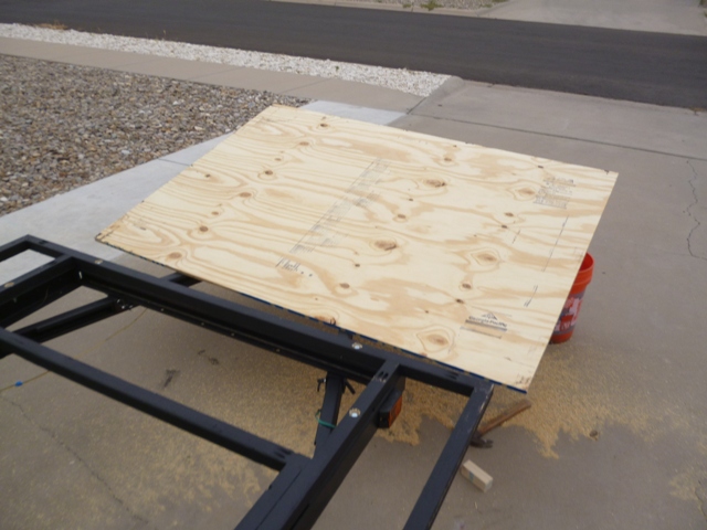

Hey everyone
I dint get as much done today as I wanted due to football and I woke up to rain this morning. The rain was a welcome sign here in Southeastern New Mexico. It has been one of the driest years on record.
I started out by going to the Orange Box after lunch to pick up some ply and clamps. They had a great deal on clamps.
I also volunteer for Big Brother, Big Sisters of Southeastern New Mexico and my little brother wanted to help me out. He has never used power tools or performed any work with his hands. It was really cool to teach someone things that my dad taught me when I was a kid. He really enjoyed and picked up on alot of things really quick.
The first thing we did was cut fender wells. I used 1x4 whitewood and applied the black beauty on it. We will finish the top of the fender wheels once the floor is finally laid down.

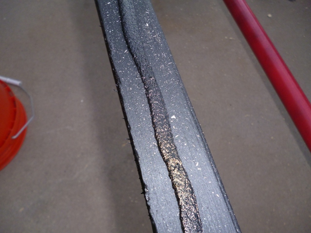

We then applied the black beauty to the bottom of the floor. We used 3/4 sanded pine for the deck. Everything else at the Orange Box looked like poo with too many cracks and too many knots. Chris really enjoyed me using the flush cut router bit and watching me get covered in saw dust.
We then laid down a bead of black roofing pookey on the 2x2 frame. This stuff is nasty if it gets on you.
I did this b/c the pressure of clamps and screws will squeeze the pookey out and create a seal between the 2x2's and the ply. Is this necessary? Who knows but I do like insurance (adjuster joke).
Here are a couple of pics of Chris using a drill for the first time and putting screws down to secure the ply to the frame. He really liked the drill as well.
Up next we will finish the floor, fender wells, and start cutting and creating a drop down storage box. Thanks for looking. Criticism is welcome :)
