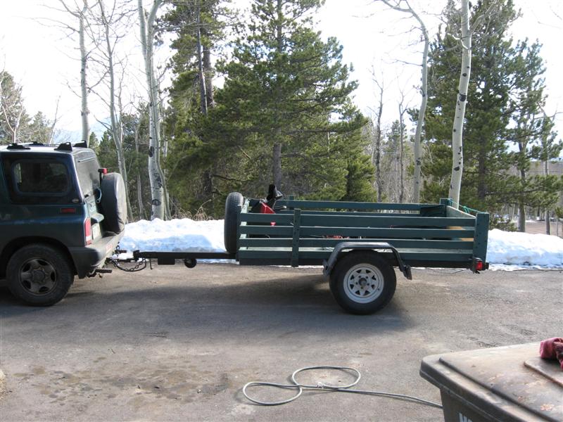

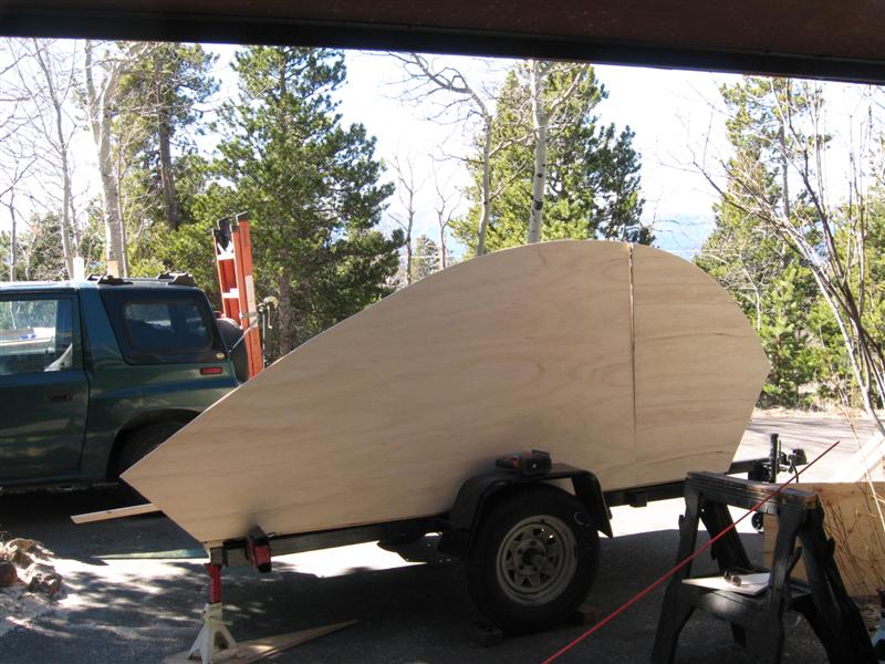

So the build started with this:[url]Image

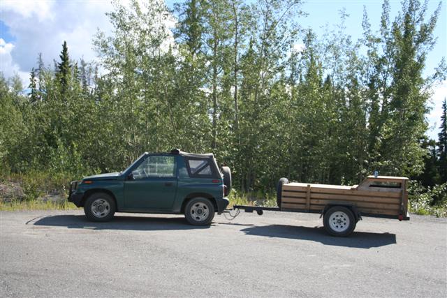

On my way back from Cordova Alaska I scabbed this onto the utility trailer. It got me thinking.

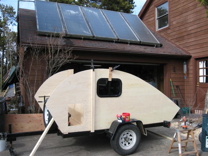

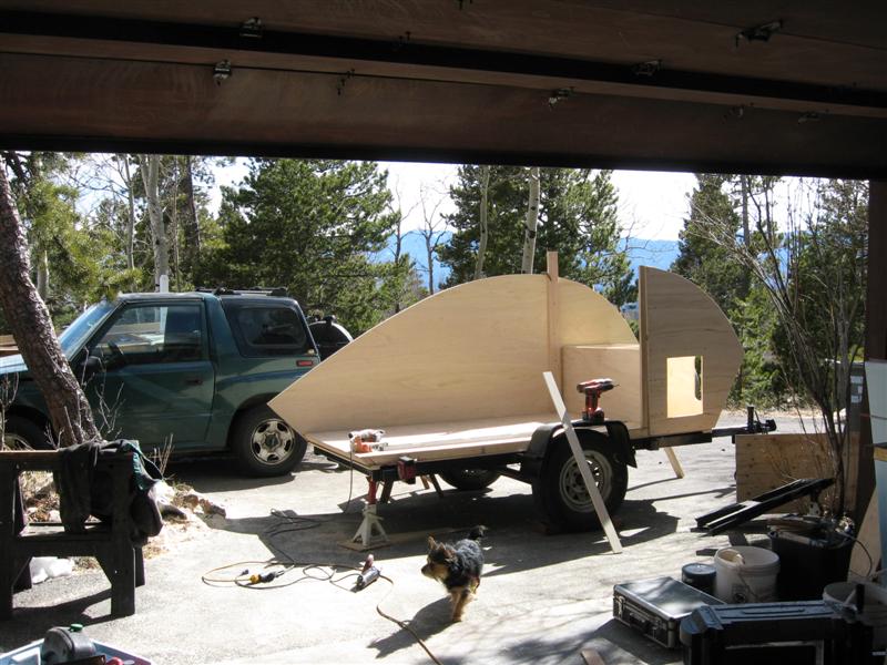

Home, spring 2011 and the start:[/url]Image
Side A:[/url]Image
Side B:[url]Image
Side a and B:[url]Image[/url]

And then I lost/but gained a whole day reading Thomas's build.
Hmm.
The hardest thing was that instead of Months, I had a couple weeks.
Ordered a Door and window from Frank Bear, which was exactly as ordered, Thanks.

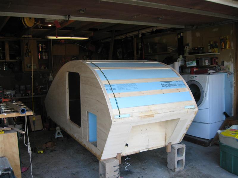

So I framed up a 2" floor that was solid enough to carry the whole Tear when I removed it from my Utility trailer. Walls were the high dollar 1/2 ply from Orange box. I milled down studs to 1" to match the blue board and poxed the blue in place.
I poxed that blue board and sandwiched the inside walls with Luan.

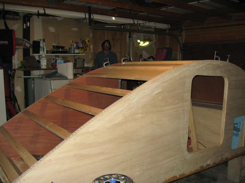

The Router cleand it up and it was time for "rafters". I used the same 1" for the top support and poxed Luan to the inside.
That was a show by myself.

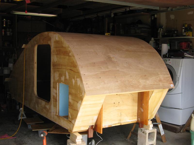

[url]Image

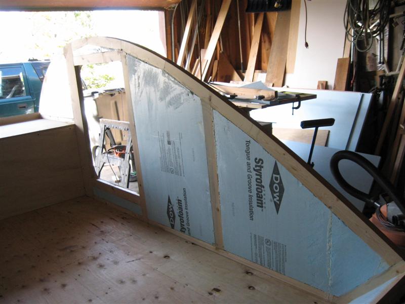

More Blue poxed in and I prewired the trailer tail lights because about here I realized that come fall I was going to build a new lighter trailer for the Tear.
[/url]Image
Two layers of Luan poxed on top and it was enclosed
I had about two weeks to go before I had to leave, and that work thing was killing me.
Oh yeah did I mention that I am at 9200' and it starting snowing, which required tenting and heat to get a single coat of pox to set up over three days.

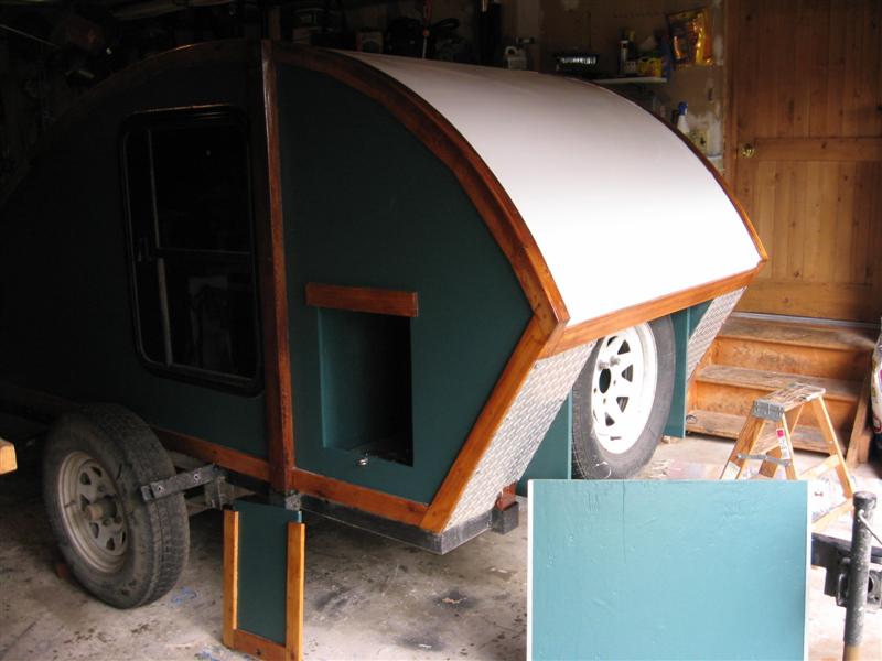

Next I poxed on two layers of Luan and started tenting and putting the Heat to it.
[url]Image

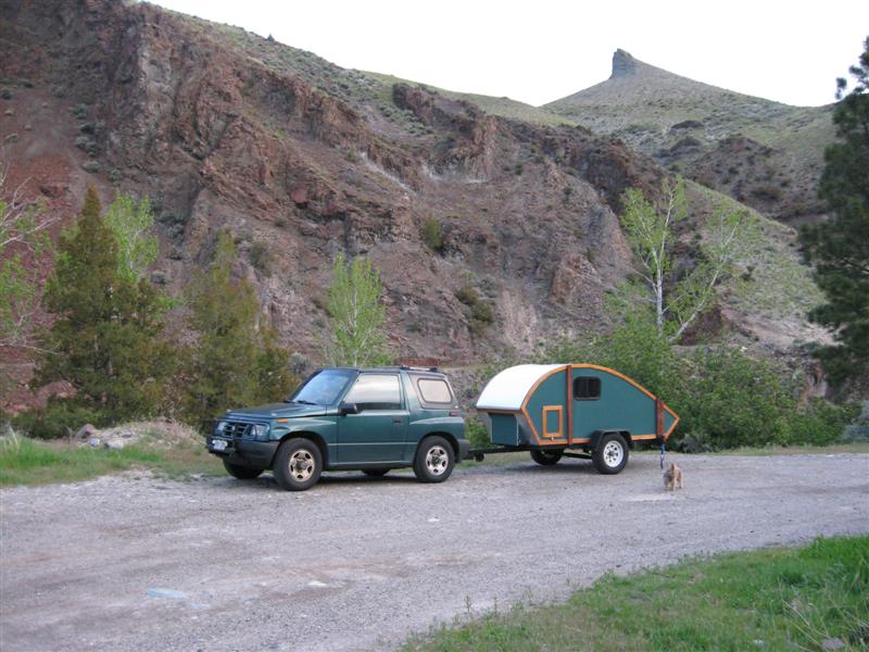

For the the next two weeks I worked under plastic, so no shots. With my Pox slowing down, my to do list got short. I got the ALU on the top with my skylight installed and trimmed it. But with no time left I was able to only get a single coat of Pox on the trim and literally gave the Tear a seal of Silicone the morning I left for Alaska.

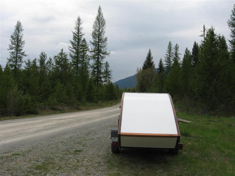

Some where in Idaho along the Salmon River.[/url]Image
A shot of the ALU from the rear[url]Image
A note on my design. I canned the Idea of an opening hatch on the top because I might have to park the Tear in Whittier Alaska. This is a place with 200" inches of rain a year, where you get in the shower to get out of the rain. I wanted to be sure it didn't leak. As it turned out I parked the Tear in Anchorage except for a week jaunt with the Lady touring the Kenai.
And sure enough when my Fish Season was over and I picked up the Geo the rain had been driven so hard in Whittier that it was forced past the Windows and Door seals and the first place I went was to a carwash vac to suck as much of the water out of the car as I could. Did I mention the mold?
Glad I gave up on the Hatch.
So It is now fall and the trailer was a pleasure this summer but took a fair number of road dings over the last 7000 miles. With the Tear in the Garage I sanded the trim down stripped what was left of the silicone, and applied four coats of Pox and a new paint job.
She's looking good.

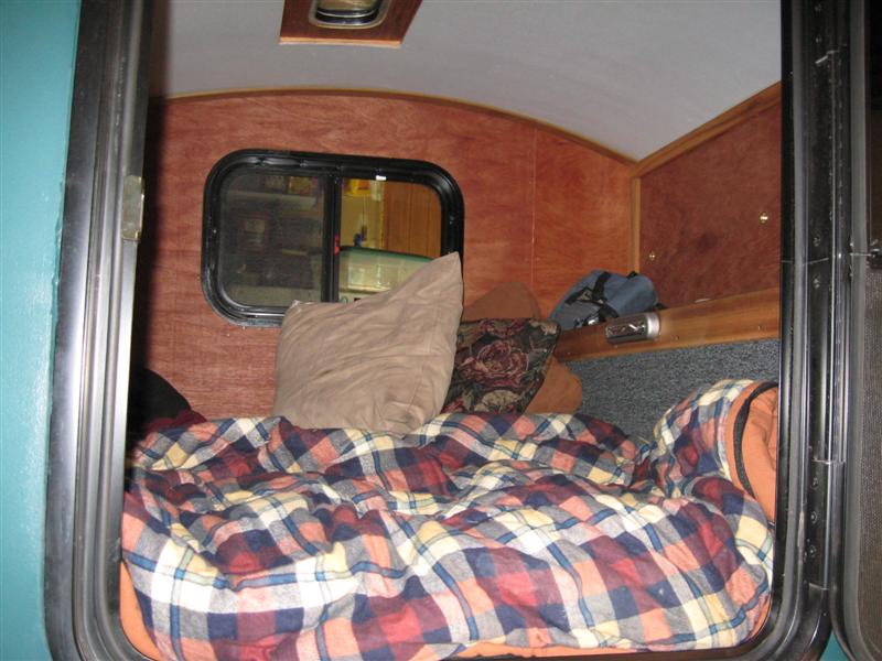

Here's a rough shot of the interior
[url]Image
To the right are two sliding hatches that are built out over the curve in front over the open hatch you see in the first pic.
Did that make any sense?[/url]

No problems at all with the exterior doors, but, the inside panel sliders swelled as soon as I went from 12% humidity to about 80%.
I hit the groove with some coarse emery and they worked fine but got loose enough that one actually popped out after a rough section of Utah.
