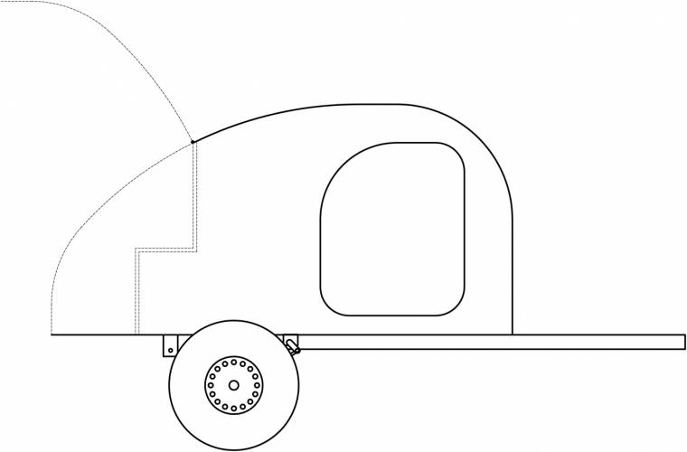

Hopefully, it will resemble this when I'm done!

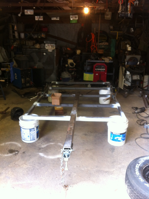

The frame welded and ready for the axle

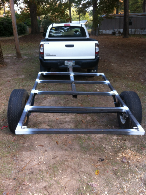

Rolling!

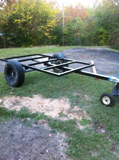

Painted and ready for the wood! Temporary rims and tires for now.

Postby Weirdnerd » Tue Nov 08, 2011 10:38 pm
In my personal opinion, ( I do not have the numbers to validate it) you may need to beef up the lance like a triangle with the frame, I have seen some pics of single "pipe' lance breaking while off roading.... seems to be some stress riser.

Postby rebapuck » Tue Nov 08, 2011 10:46 pm
What will you be going off-road with? The truck?

Postby FlyFish1971 » Wed Nov 09, 2011 9:24 am
Thanks for the suggestions! Slowcowboy - 30 bucks for shocks and a better ride is well worth it! Thanks for the info, I'll be checking into that right away.
Weirdnerd - I was thinking about a box up front. I'll talk to the guy doing my welding. Maybe I can beef up the frame with the triangle/frame and incorporate a box onto that.
rebapuck - The truck in the pic is a 2011 Toyota Tacoma 4x4 with the 4 cylinder in it, so it does the VERY mild off road driving. Although I've been in some rough spots with it a time or 2! The other rig I'll be using is an 86 Toyota 4 Runner. I don't do any hard core off roading, just the hard to reach camping spots.
