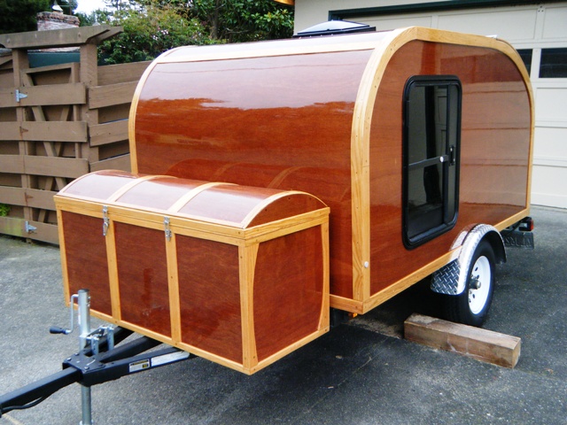

I have a 5x8 Benroy woody 75% done. I have the fun interior fixings to complete. I used a HF heavy duty frame, which I lengthened by 18" in the front so I could attach a big pirates chest. It also evened out the weight distribution because I did not change the axel location.
Below is a picture of her first camping trip. The exterior is done with three coats of Raka epoxy. It only has one door and was used for a utility trailer. No sleeping inside yet.
Below is a recent camping picture with oak trim added and 3 additional coats of Flagship varnish. We now have two doors. The interior is still just a shell though.

Postby canned o minimum » Sat Nov 12, 2011 10:24 am
That oak trim REALLY makes that trailer POP ! How did ya mount them fenders ? Looks like ya CUT the fenders to fit ???

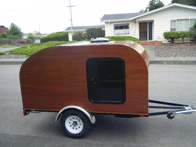

Postby jabrobbins » Sat Nov 12, 2011 7:42 pm
The trailer base overlaps the trailer by 6" on each side. I build standard boxed fender wells over the wheels. The fenders are 8" wide so they stick out an additional 2". I then cut a radius along the plywood sides so the fenders were flush with the sides. I used VW bug fender beading in the gap. I used stainless steel screws and fender washers for installation. I also used a couple of nuts and bolts.

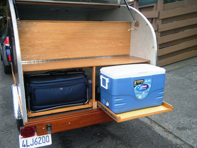

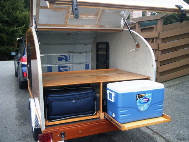

I'm finally starting to see the light at the end of the tunnel. I have the interior roughed out. I have a really simple galley arrangement. I built a fold down galley that turns into a bunk. I'm hoping this will work for our daughter until she gets too tall.
Here is a picture of the galley folded up for cooking and travel. There will also be a sliding shelf above the top edge of the galley wall. It will slide forward so our daughter doesn't bump her head.
Here is a picture of the galley down:
The whole arrangement can also be unbolted and taken out so I can use the trailer to haul stuff. I don't have a truck so it has to do double duty. I'm hoping I won't need to convert it too often.
