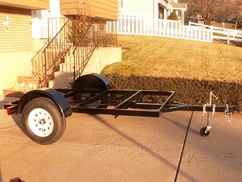

We decided to have our trailer frame built, ordered it from a local shop and picked it up this weekend. It's a 5' X 8' with 15" wheels made from 1' X 3' rails, 3' X 3' tongue plus fenders. At 350 lbs, it's a little heavier than a bolt together but not too bad. With the extra ground clearance provided by the 15" wheels, it will certainly be rough or off road capable.

Postby Robbie » Thu Dec 15, 2011 5:42 pm
Steve your trailer looks like it will be a good project to watch! It's nice to see another Utah local in the teardrop scene. I live down in West Valley and am also building a modified Benroy 5x8, but mine is galleyless and built more for the interior space. Your plans are looking good so far and your trailer looks very stout! I'll definitely be checking in on your build!

Postby David S » Thu Dec 15, 2011 11:44 pm
Steve,looks like a good stout frame,looking foward to following your build

Postby Toytaco2 » Fri Dec 16, 2011 12:00 am
The Benroy is my favorite style and I like your heavy duty frame and larger wheels. If I build again, I'll go with a better custom frame as you have done.

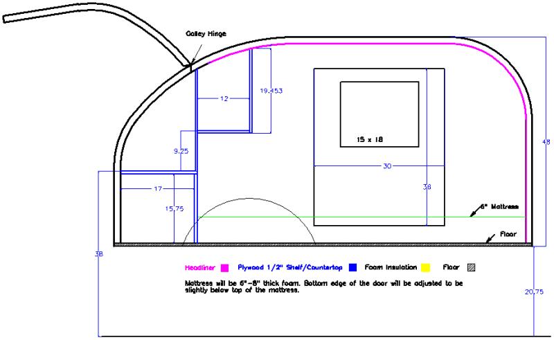

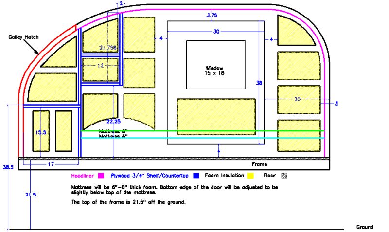

Postby PSBreen » Tue Dec 20, 2011 10:12 pm
Ok I think we about got the template sorted out. Comments or suggestions are welcome. Hoping to get it cut before Christmas.
