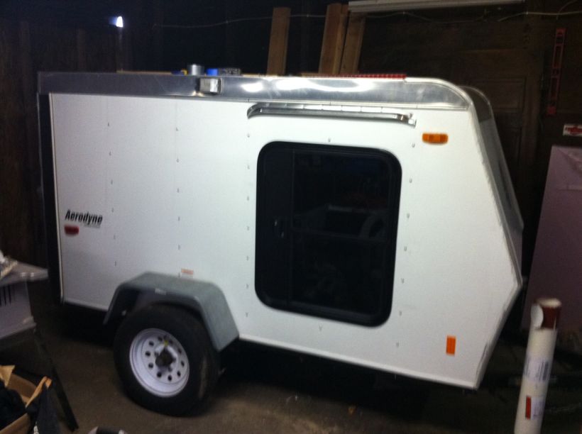

I found this trailer on craigslist and just couldn't get it out of my head. 2006 Homesteader Aerodyne 4x8 cargo trailer. It looked like they had teardrop trailer in mind when they manufactured these.
So it followed me home and work started on 1/1/12
Removed all inside plywood and insulated. I was shocked to find that the studs in the walls are wood. This does make this build much easier though as I won't need to weld. Used 3/4" Styrofoam insulation and put the panels back up.
I ordered window, door and drip rail from Vintage Technology and they showed up in 2 days...WOW!!
Installed window on drivers side.

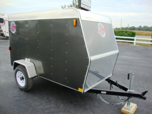

My trailer is white BTW..the silver one is a stock pic as I didn't want to drag mine out when it was snowing.
My goal is to have it campable by Shivaree on 1/13/12 and finished by May. Door will go in this Saturday then on to galley and electrical.

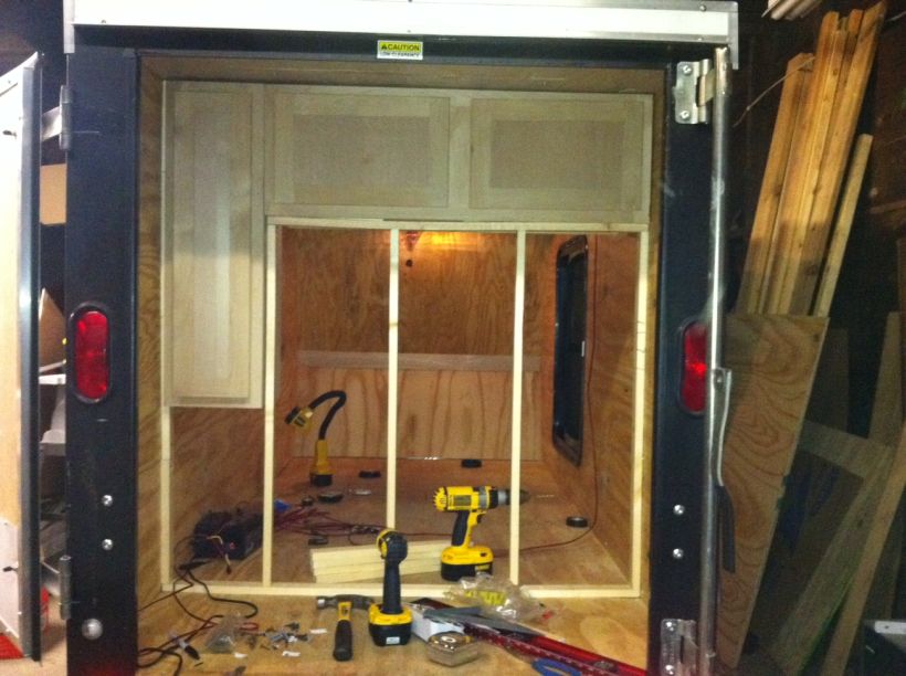

Postby Blotto Bros » Sun Jan 08, 2012 7:03 pm
Installed the door and started the electrical system. Porch light and interior light in and running.

I agree those look like they were meant to be a TD though it looks pretty narrow? or is that just the way the pic came out?
rand_98201
Posts: 88
Joined: Sun Dec 18, 2011 3:04 am
Location: Western Washington
Postby Blotto Bros » Sun Jan 08, 2012 10:18 pm
.4x8 (45" wide by 48" high inside) Perfect for a single camper.

Postby Blotto Bros » Tue Jan 10, 2012 10:04 pm
Basic 12v electrical system in. Galley roughed in and next onto sheet metal and 110v.

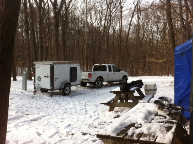

Postby Blotto Bros » Sun Jan 15, 2012 8:00 pm
Shakedown cruise this weekend to Shiveree!! When I say shake I really mean shiver..high of 28 and down to 12 last night. The insulation worked great as i was able to use my ceramic heater to reach 106 interior. I did turn it WAY down before bed and still slept comfortably.
I am going to pull out the galley and re design it...need MORE cabinets in the interior and a pass thru. All in all it was a great time!
NOTE...the pota-poty on the picnic table was not mine....and I believe it's owner moved it before use!!
