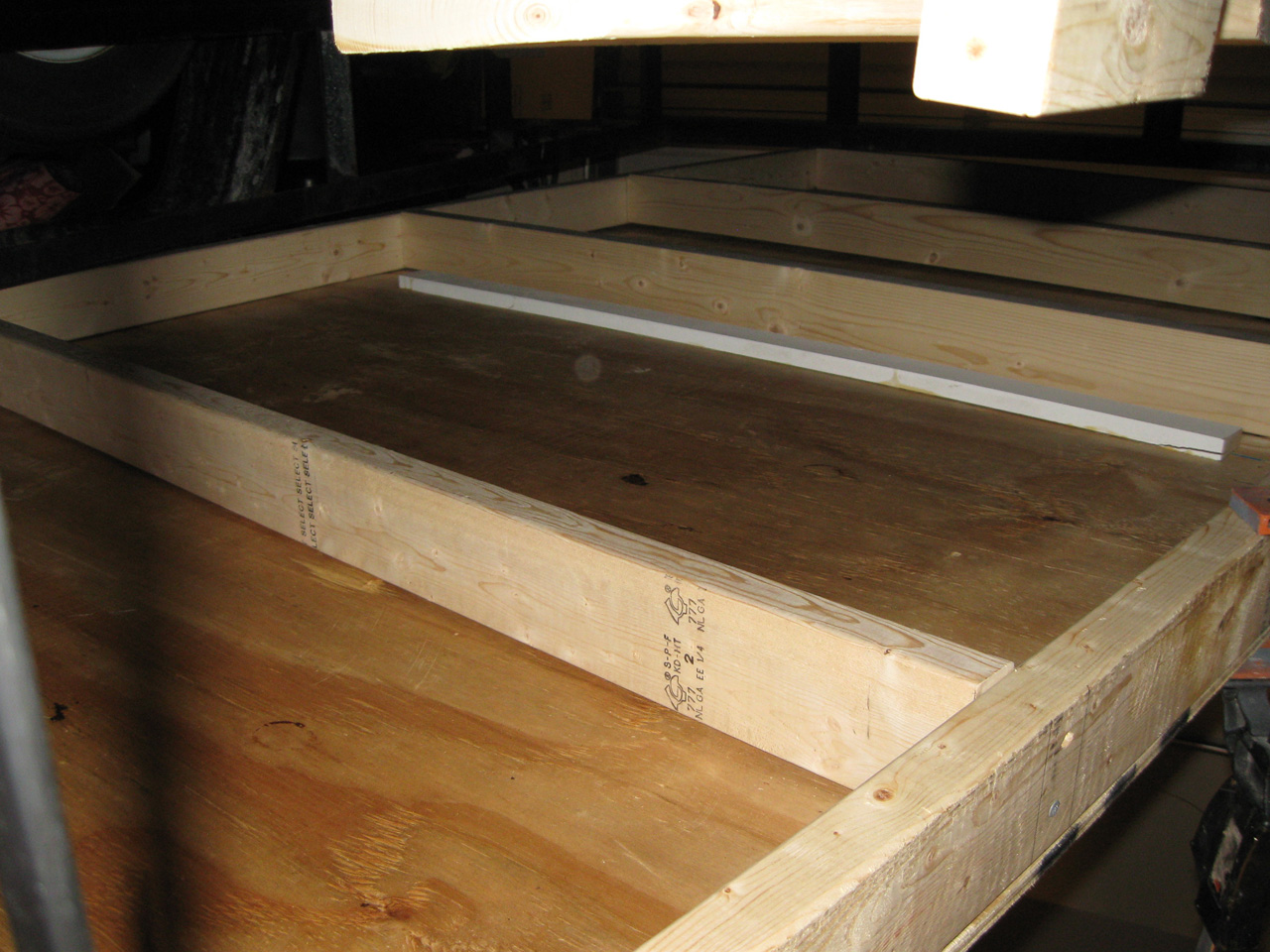

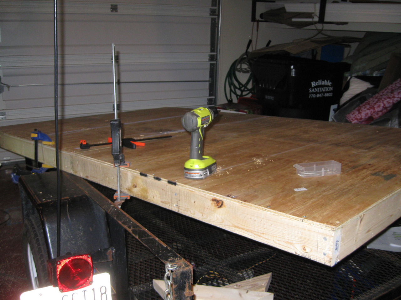

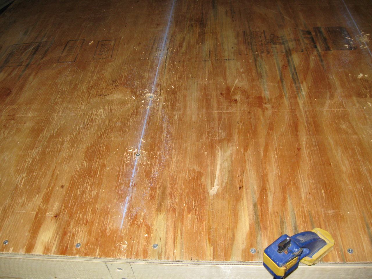

Postby CHUNKYMONKEY » Wed Feb 29, 2012 9:19 pm
I've worked a couple nights this week framing my floor. I'm using 2x4's on end. I finished the frame and started screwing the 1/2 ply to the frame. By the weekend I'll be flipping it and adding the insulation and waterproofing it with the Fencepost Asphalt. Good times!
Since everyone wants photos, I'm attaching a few of the floor and frame.
I'll be picking up my side plys on Saturday and taking my trailer for the amendments and reinforcement by Sunday, I hope.
