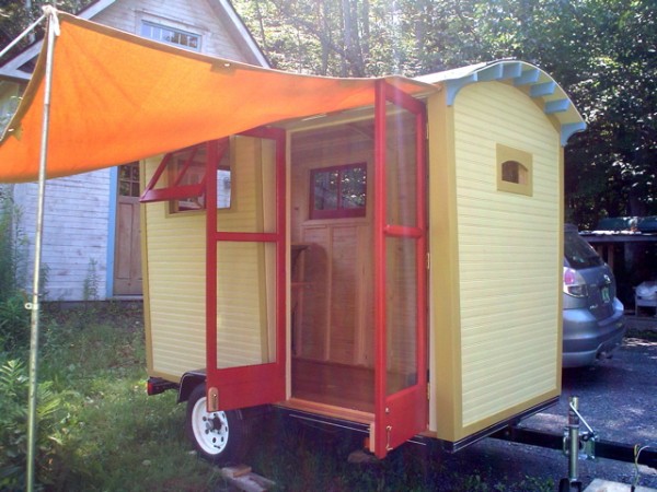

So I tossed around alot of ideas and landed on Paleotool's Vardo. http://paleotool.com/plans-projects-and ... the-vardo/
I really like the way he built his (however, mine will be built lighter and cheaper) with a different floorplan.

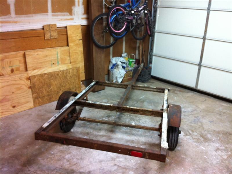

I decided on this little trailer I found on Craigslist for $145. Mostly because it was cheap and also because I liked the large opening in the back for a large drop floor.
photo 1 (Medium).JPG (64.12 KiB) Viewed 3649 times
photo 2 (Medium).JPG (79.15 KiB) Viewed 3649 times
The trailer bed area is 4x6 with a 6 foot long tongue. I am already planning on adding 2 feet of support for the floor by welding some tube steel two feet forward and back to the tongue, then adding two A fram style pieces up toward the hitch.
I can already see that my cheap trailer may end up costing more than a better one. As the 8" tires are insufficeint and old and it needs new bushings in the leaf springs (as it doesn't appear to have any left)
I am planning on upgrading the tires to two 12" HF tires http://www.harborfreight.com/12-inch-sp ... 44144.html
And of course repack or replace the wheel bearings.
Please let me know if you think any of this is a mistake or whatever advice you have. I am very handy and very motivated but no nothing about trailers or RV's and am only a mediocre carpenter.

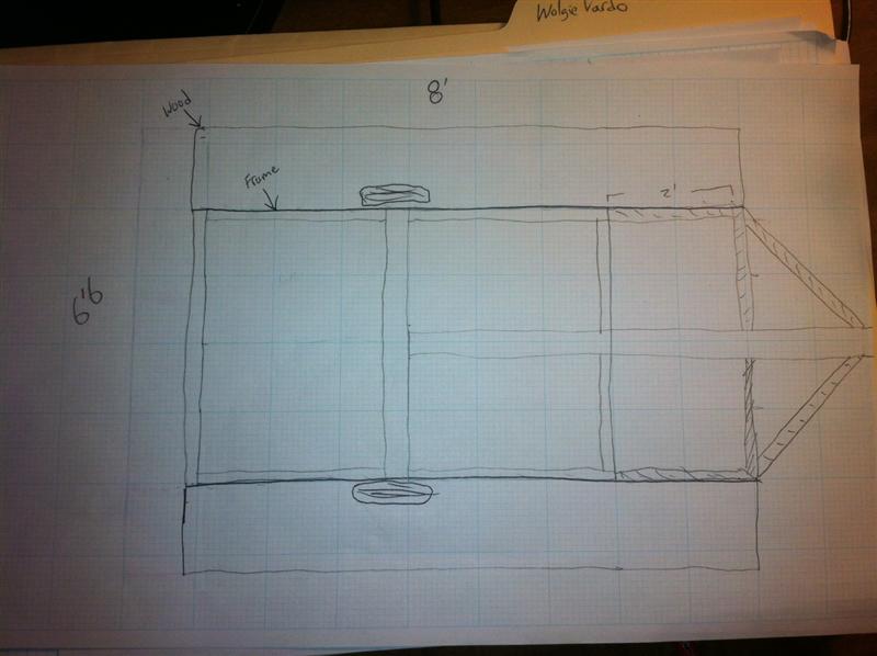

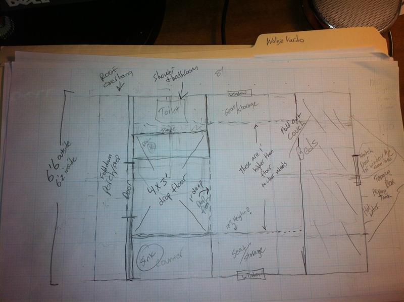

Here are the plans
photo 4 (Medium).JPG (52.05 KiB) Viewed 3647 times
This is the trailer footprint with additional support that I am going to add on the front.
photo 5 (Medium).JPG (43.63 KiB) Viewed 3647 times

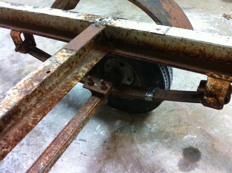

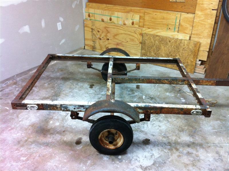

And here is a close up pic of my trailer axle/spring area it doesn't even look like it has bushings in the slipper spring side :(
photo 3 (Medium).JPG (79.97 KiB) Viewed 3644 times

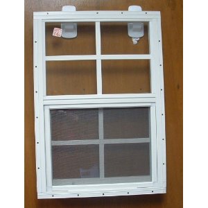

Thanks, yeah I'm gonna get a couple of small shed windows something like this
but probably the dark brown/black ones.
http://www.amazon.com/Shed-WIndow-Safet ... B005GP9Q5Y
and put them in the sides one on each side. They will have screens and open and I may add a small (removable)fan to one for ventilation when I don't want/or can't run the AC. Actually, I was just thinking. I am going to put a hatch for the AC (5000but window unit) on the upper front which will be about 2 feet above the couch/bed. The window unit will be removed during travel, and I could have a screen that pops in with a 12volt electric fan attached for when I am remote camping. Then open both side windows for ventilation. See this is how my brain works, 90mph and I can't shut it off.

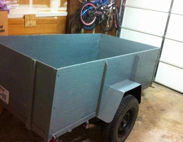

Postby wolgie » Wed May 23, 2012 8:22 pm
Well, the trailer was gonna be too much work to get it where I needed it so I sold it. And ponied up some more dough and bought this bad boy. The sawdust will fly in the next 2 or 3 days!!!!

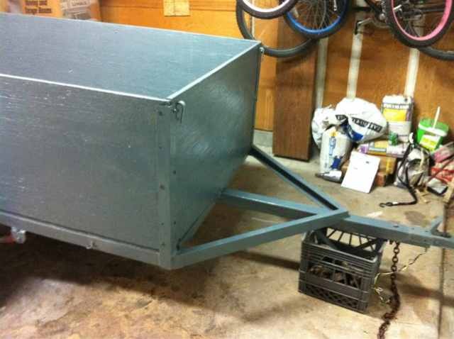

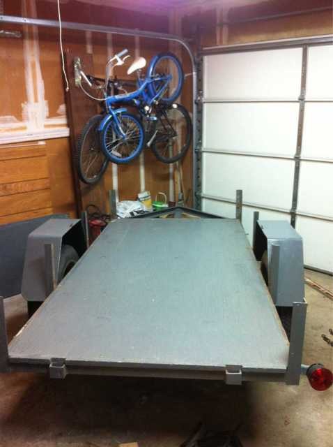

Postby wolgie » Thu May 24, 2012 10:41 pm
Ok so I took the plywood sides off. And cut the angle iron braces down to 11".
My sides will be 12" before they go out either 12 or 15" depending on how it looks. I don't know if it's gonna look dumb with the sides sticking out 9" past the tires???? What do you guys think?
I'm gonna get a bunch of wood tomorrow and start some tomorrow night, but will be out of town over the weekend.

wolgie wrote:My sides will be 12" before they go out either 12 or 15" depending on how it looks. I don't know if it's gonna look dumb with the sides sticking out 9" past the tires???? What do you guys think?
I think if you get some corbels for the sides it would look just fine. Kind of like a ledge vardo. Maybe draw it to scale first to see if you visually like it first

Postby KCStudly » Fri May 25, 2012 2:54 pm
Cardboard mock-up? Decide if you like it first.
Re: WolgieWagon (Vardo Build)
Postby wolgie » Fri May 25, 2012 3:17 pm
Both good ideas. Thanks..... I put some plywood I had up there and it looked fine. I am planning on putting 5 corbals (I had to look that word up) :D on each side for support, plus it will have the metal braces that go up 11", so it should be real sturdy. I have decided to cut one of the cross braces in the back of the trailer to expand my drop floor to 36" long and 44" wide. I will put a new brace in on the edge where I cut the other. A picture would help if I had one on me. I have to drag the trailer out and up and down the driveway and take some measurements to figure out how low I can make the drop floor.

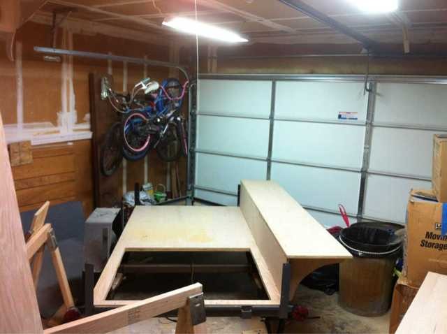

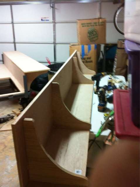

Postby wolgie » Wed May 30, 2012 11:22 pm

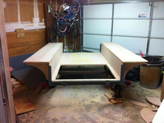

I made alot of progress today! I built the (steps) or side boxes, including corbels. They aren't attached to the trailer yet. And I built the drop floor box but have to paint the bottom before I install it.
My carpentry skills are lacking but I make up for it with determination and skill in caulking, paint, and cover up work. I should have the drop floor complete and installed tomorrow.
I hope to start framing this weekend if not sooner. The total width is 79 inches. I made it that big to be able to sleep across the width which will take up less room.
Wolgie

Postby droid_ca » Wed May 30, 2012 11:46 pm
WOW looking good. Can't wait to see more

Postby Deryk the Pirate » Wed May 30, 2012 11:47 pm
Looks Great!
Im actually contemplateing my next build will be a standie. I love my lil vardo, but a little more space would be nice, and a permanent bed with storage under it. I also like the idea of a toilet/porta pottie.
