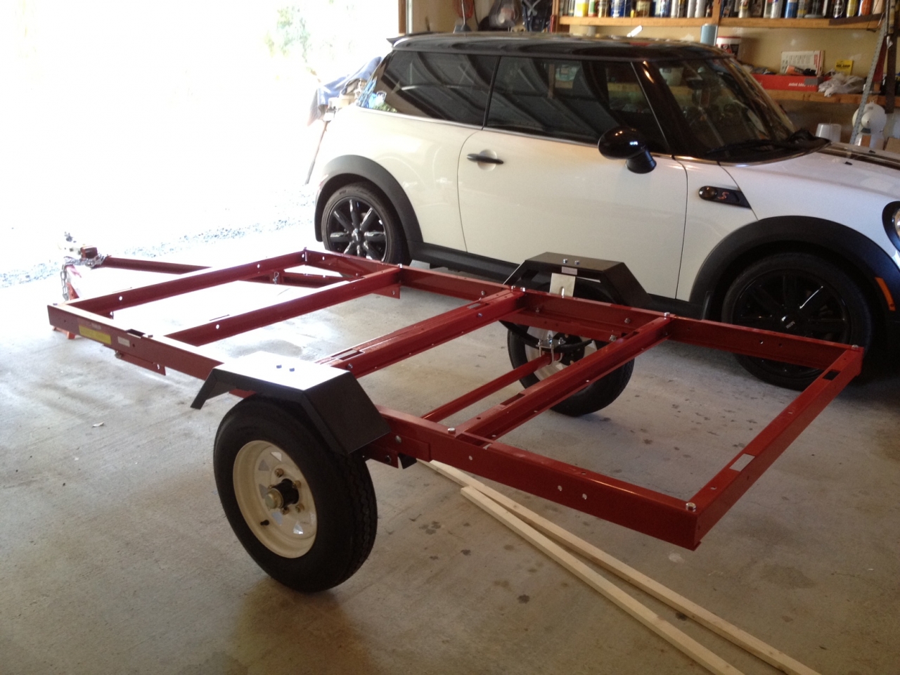

Postby cop1406 » Fri Jun 08, 2012 6:36 pm
Hello again. Well I worked on the trailer for about 4 hours today and got it finished. Not too bad, directions were okay. The only pain in the a@# was getting the chain threaded through the bolt and then trying to keep it up from falling out while trying to put the washer and nut on. I may have said a few cuss words during that, maybe... Here is a picture of the progress. Have to go to the blue box store and buy some stuff to finish the deck and continue the build. Today is my birthday and my wife is buying me a router table. :applause: :D Should come in handy for this build.

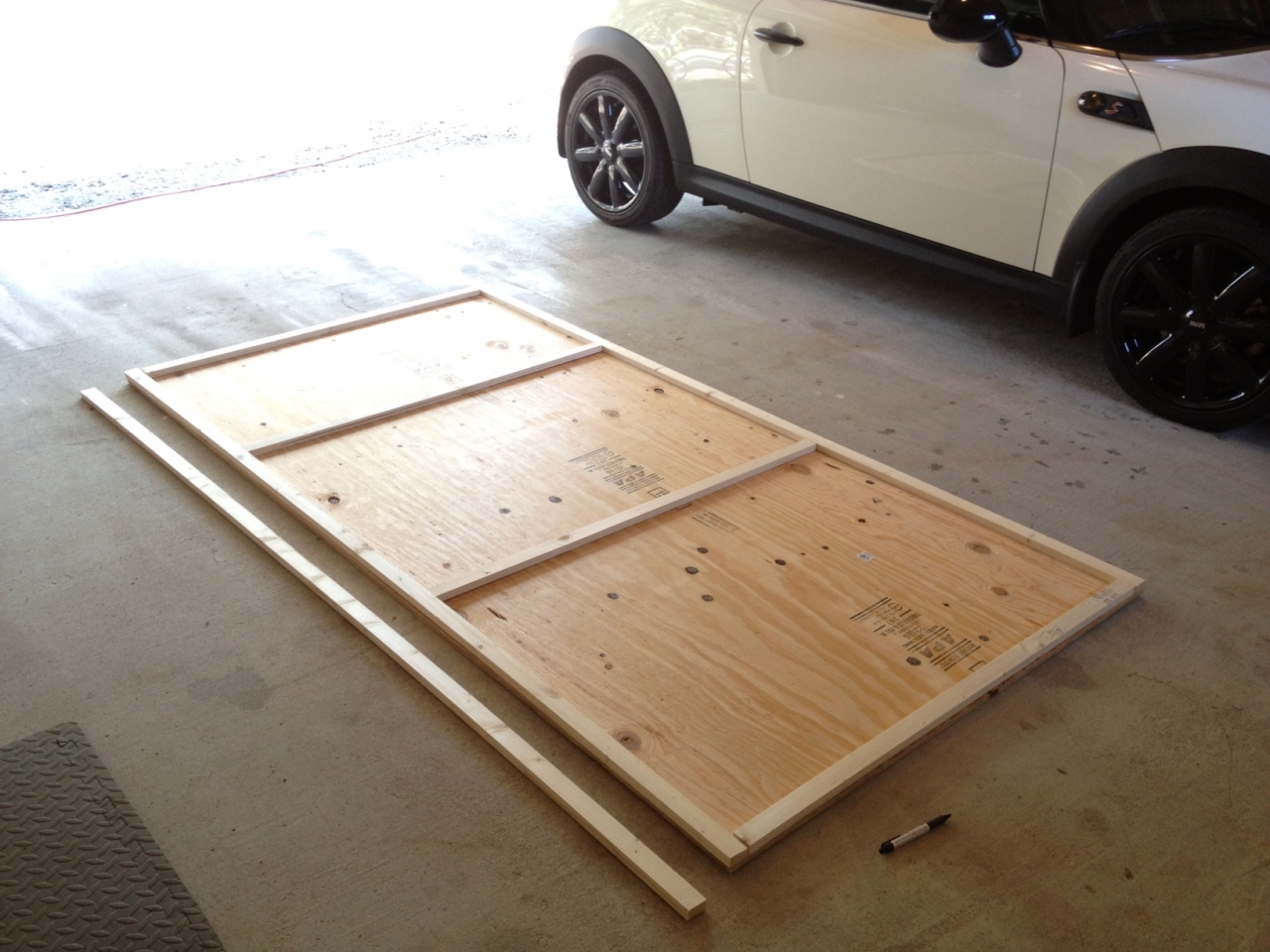

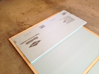

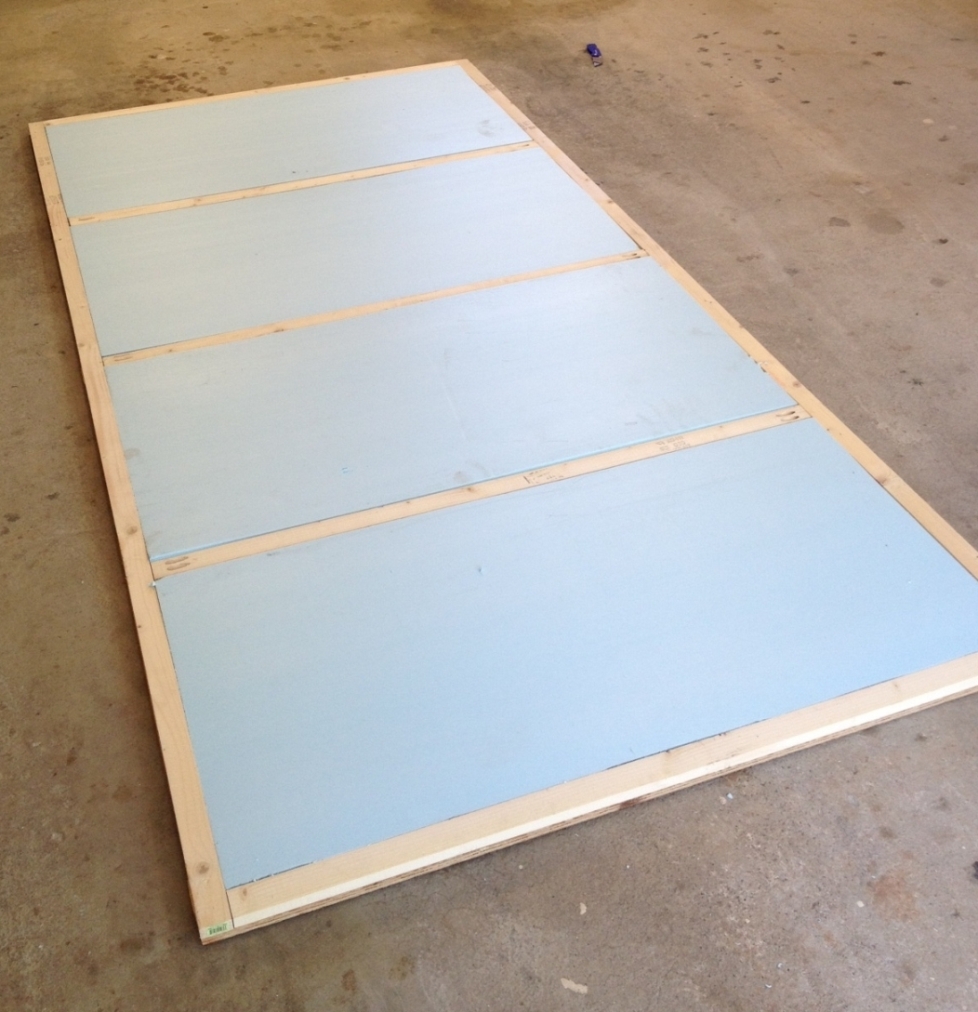

Postby cop1406 » Thu Jun 14, 2012 11:14 am
Worked on the trailer a little more over the last two days. I got the floor insulated. The picture below shows how I used slight pressure on the styrofoam sheets to imprint the pattern of the space I had to insulate. I then cut it out with a razor knife and placed it in the spot.
Also took the trailer to DMV. 45 minutes at DMV and I had a temporary registration form. If you live in California you will need a Certificate of Origin for the trailer. I called Harbor Freight and one is coming to me in the mail. :thumbsup:
Here is the deck with all insulation installed. I will now add a bottom sheet of plywood and mount it on the trailer.

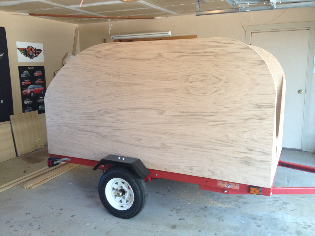

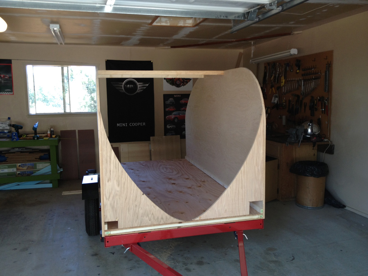

Postby cop1406 » Mon Jun 18, 2012 5:50 pm
Got my walls up today. Made my first mistake or oversight or what ever you want to call it. I wanted the sides to come down and cover the bottom of the deck but I did not cut my deck down to compensate so my trailer is now 49.5 inches wide. That will make it more difficult to cover the top in 48 inch aluminum. Maybe I can use 1 inch trim to cover the 3/4 inch ply plus 1/4 inch of the aluminum.... :thinking:
I am sure I will make lots more errors and oversights during this build. This is the first time I have taken on something like this. I am having fun and I am sure I will figure it out with help from you guys and using my noodle... :thumbsup: Got to use my Bosch router today, worked great.
