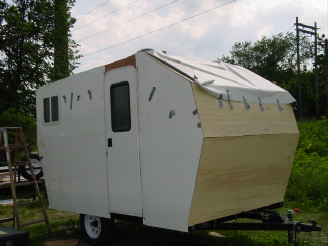

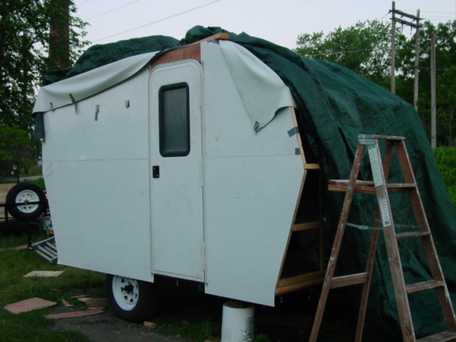

I've been busy working on my TTT. This is the first time I've attempted such a project, so I'll have to see if things continue to go well. I had a local shop make the trailer frame for me. It was a little pricey compared to what most of you pay for the trailer frames, but this one is well built with a 3500 pound axle, and has electric brakes and a break away system. I had it built with the wheels inside the frame, as you can see in the attached photos. Building the side walls was a bit of a challenge since I didn't have the most ideal set up and working conditions. With the help of some friends, we were able to hoist the walls up on the frame without any major problems. The long Memorial Day weekend gave me plenty of time to get most of the trailer enclosed. I will put aluminum sheet siding on the sides and will need a helper to handle the 4 X 10 sheets. For the roof I am using a rubber roof and will install that after the siding. There will be 3 windows and a door and I still need to cut the openings for those. Once the outside is weather proof, I can turn my attention to the inside. The bathroom will have a tub (24 x 32), a sink and a permanently mounted toilet. The "kitchen" will have a small sink, refrigerator, and microwave. For a stove, I am going to use a small butane burner. There will be a small dinette and for sleeping will use a twin size memory foam mattress system. It looks like everything will just fit! :) The trailer will be wired for both 12 volt DC and 110 volt AC . As soon as I get more work done, I will post more pictures.

I'm still making progress, although it seems to take a long time to do even the littlest things. Putting on the siding is not easy for one person. Those 4 x 10 sheets of .040 aluminum are hard to handle. But with a little ingenuity and a few clamps, I've been able to position the siding long enough to get some screws started to hold it in place. Last night I pretty much finished up one side and was able to get the door installed. I still need to cut out the window opening in the upper left and fit a piece of siding over the door...and then it's on to the other side. After the siding is on, I can glue the rubber roof in place. Then I'll be able to work inside and not be hampered by the weather or lack of daylight. I'm hoping to have the outside done by the end of this week. Someone asked about drawings or plans...there are none. I am doing everything from my head and adjusting things as I go.

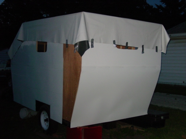

Tonight I had a friend help me put some of the siding up. It's just too hard for one person to handle those 4 x 10 sheets of aluminum siding and get them into position. We also cut the openings for the windows, although one of the cuts was not too accurate and I will have to do some repair work to cover my mistake :oops: To save time and get the most done while I had the help, I just used a minimum amount of screws to hold the siding in place and need to go back and secure it better and get rid of the waviness. I have the rubber roof lying on top and would like to have a third person available to help glue it down. I've not put on a rubber roof before and I don't wan't to mess it up.Two people might be able to do it, but an extra set of hands would be even better, especially if something went wrong. Then it's full speed ahead to complete the inside.

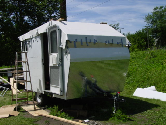

I'm still making progress, although it is not going as fast as I had hoped. I wanted to finish up the siding this weekend, but it was so windy that it was hard to hold onto the pieces. I bought a sheet of diamond plate to put on the front. Today the wind was even worse...it was a very strong wind that just wouldn't let up. I did get the windows put in and today made a trip to Menards to get some supplies. Picked up a 48" counter top for the "kitchen"(will probably only have room for 40" of it), bought pex plumbing and fittings, a stainless steel bar sink for the "kitchen" and several other items. While in the store I was looking around for something to use for the outside corner edge molding and I think I found something that will work perfectly. It's the aluminum trim that is used when installing carpeting and flooring. I can't remember what it is called, but it came in 8' lengths and had a 90 degree corner bend. There were several colors available, although they didn't have white. I'll be sure to take photos after I install it so you can see what you think about it. This week I plan to work on the electrical wiring and plumbing and also get the fixtures installed in the bathroom.

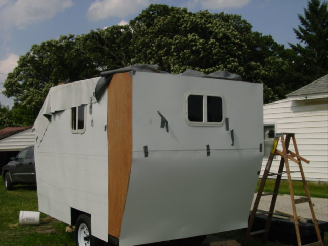

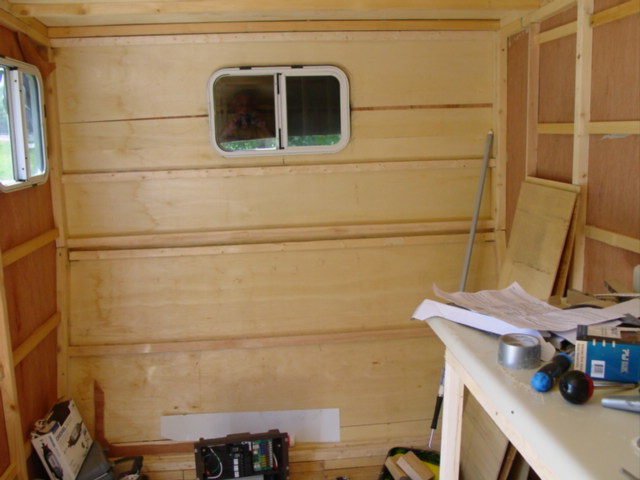

view of back of trailer. The sofa/bed combination will go across the back. I started building the frame today and was making good progress until I ran out of lumber. I still need to frame around the windows.

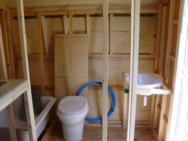

layout of the bathroom. Everything fits and it's nice and cozy! I wanted to put the toilet where the sink is, but because of the trailer framing directly underneath, I wouldn't have been able to mount the holding tank in that location.

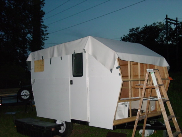

Here is an updated picture of the front of the trailer. I added a sheet of diamond plate to prevent road debris from damaging the front of the trailer.

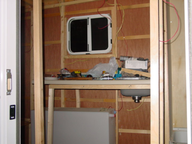

Kitchen area with water tank below the counter
