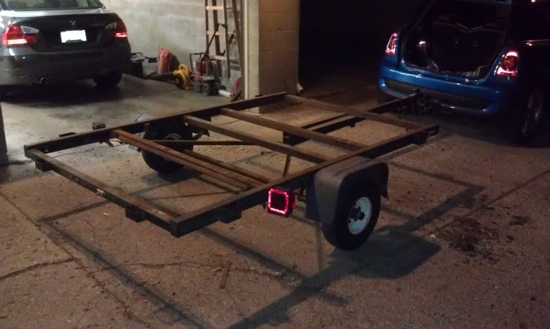

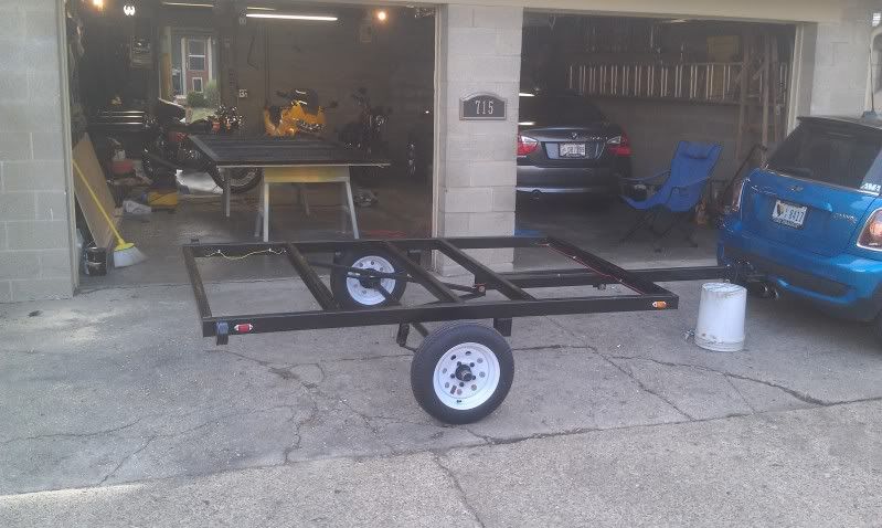

Well, it has begun! I got the itch for a project one evening about a week ago and got on the forum here to look around at designs....by the next evening, I had acquired a trailer (craigslist find). My last teardrop was a 4x8 Cubby on a HF trailer....this one will be a 5ft Weekender.

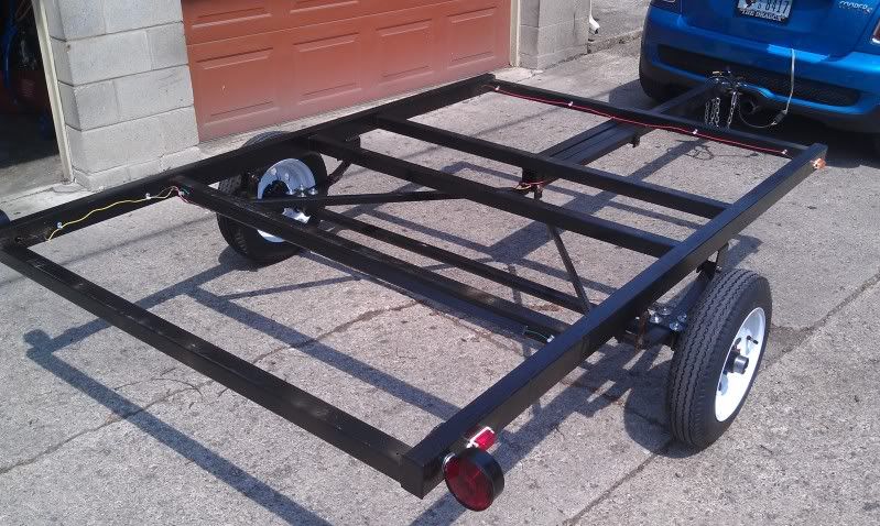

The last week has been spent refurbishing this old trailer. It's a 5(ish)x8 ft made from 2x3 box welded steel....very sturdy....on a Dexter axle. I got a good deal on it I think. After replacing all the bearings, seals, wheels/tires, wiring, lighting, safety chain and priming/painting, I have $350 in it.
The night I picked it up...this was after removing several hundred pounds of rotten plywood flooring and sides made from heavy 2x6's....
After all the work on the trailer...

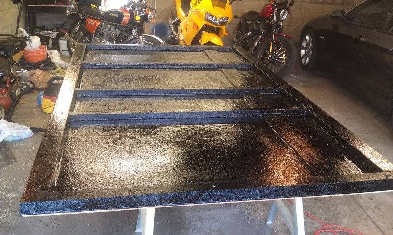

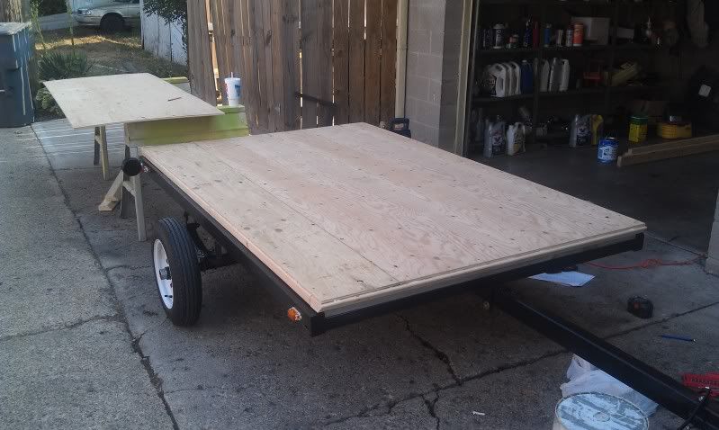

Yesterday we finished the floor (currently the asphalt coating is drying)....today we will bolt it on and keep going...
As of now, the plan is to have 3/4" plywood side walls and an insulated roof.....the jury is still out, though, on sidewall thickness. I don't want the walls to bow at all down the road and the doors to be nice and solid (hence the choice of 3/4"), but I found some very nice 5ply 1/2" for just a little more $$ yesterday, so I may end up going that route.

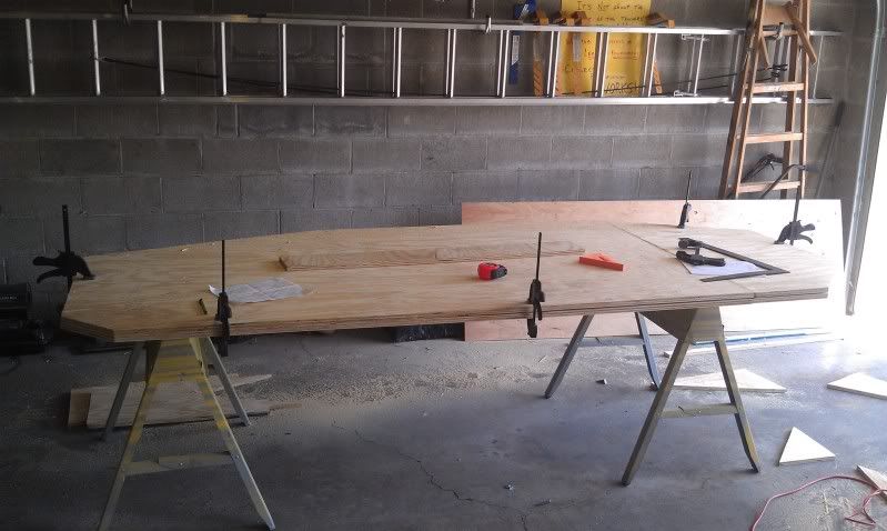

Any tips for using a biscuit planer to join plywood? Need 10ft sheets for the sides and only 8' available locally. Can 1/2" plywood be successfully joined?

For longer or wider pieces of ply, I used a 3 wing cutter on the router and a spline http://www.tnttt.com/viewtopic.php?f=21&t=34381 running the full length of the joint.
The cutter I got at Harbor Freight and the spine is a 1" piece of luan. It worked out well for me. I have a few pictures in my build link.

Ah that's a great idea. Thanks so much. My neighbor gave me his biscuit joiner to use and a bag full of biscuits, but this might be a better way to do it....looks like it might make a stronger joint.

I used 3/4" ply for sidewalls and a 1" lap joint to get the 10' length for my weekender. Made the splice at the centerline of the doors so the exposed joint was minimal. If the extra weight is not an issue, I would highly recommend 3/4" over 1/2". It makes a very straight and sturdy shell.

You can biscuit 1/2 inch ply and it comes out very sturdy. In fact I wonder if the full spline might not be weaker since the "flap" has the potential to be pried on along its full length. With the interrupted biscuits, the same prying action would act on the undisturbed areas like a fulcrum, tending to put the biscuits in tension rather than bending.
Just my thoughts, and not sure if they are valid...haven't tested. I do know that the plywood joints I have made for bench tops and such, where the biscuits were spaced every 6-8 inches or so, and fully glued, came out very strong.

Thanks guys. I ended up getting 3/4" plywood for the sides. My neighbor loaned me his router and his biscuit joiner. I didn't have the correct bit for the router, so I decided to go with the biscuits seeing as he supplied me with a bag of biscuits and glue. :)
Tomorrow I'll measure and cut out the sides.

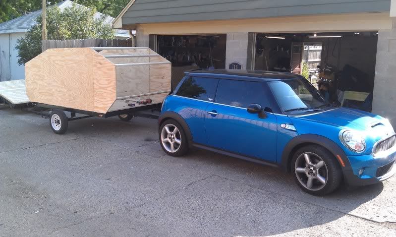

pappaw wrote:a nice looking frame, like your Mini too. :thumbsup:
cheers :beer:
Thanks. You'd be surprised how well a MINI can tow. I have a utility trailer that I've hauled motorcycles across the country on .....as well as lumber for building decks, a sailboat, and I moved a piano (twice). :D The driving experience/handling is very addictive....this is my second one in a row.

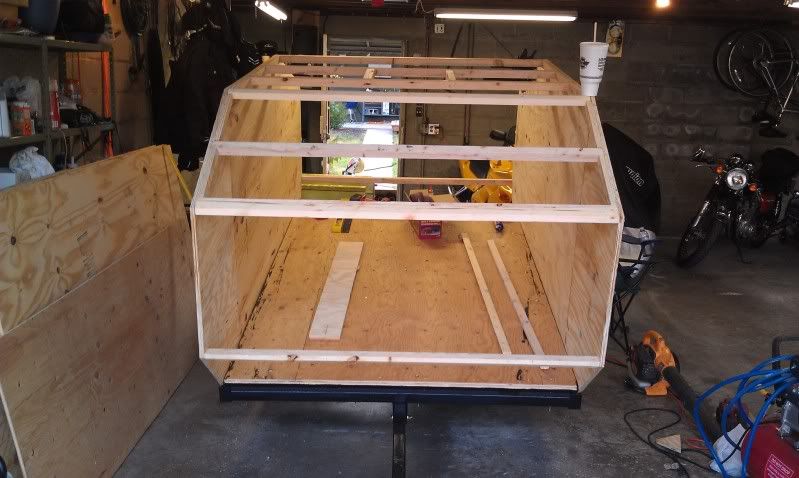

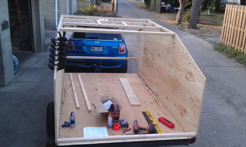

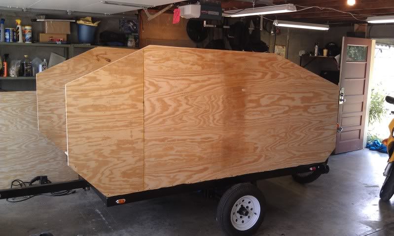

July 4th was a busy day in the garage. Got the sides cut out, mounted up, and many of the spars and nailers in place. I marked out the locations for the doors, but then started considering the purchase of prefab doors....so I didn't cut them out. Thinking on it overnight, I just can't bring myself to spend the $$ even though they sure would save time and be easier. I may change my mind, but for now, the decision is that the doors will be homemade
There's still some framing left to do in the front end....waiting to figure out how I want to configure an AC install up there. It will either ride low (basically on the tongue) and utilize some ducting for intake/exhaust....or it will ride higher and have some sort of a cargo door to slide out of with the unit on sliders. Haven't figured that all out yet. First order of business is getting my hands on a little 5000 btu unit to build around...problem is that retailers are all out of them around here. It's been incredibly HOT here in Indiana the last couple of weeks and they are all sold out. May have to order online.
I've been following les45's build and like his galley hatch design, so I'm planning on doing something similar (hope you don't mind Larry :D )
The jury is still out for the waterproofing technique. Thinking about experimenting with some thinned down polyurethane on some plywood scraps to see how they react.....want to make sure there's no plywood glue interaction with all the solvent.
