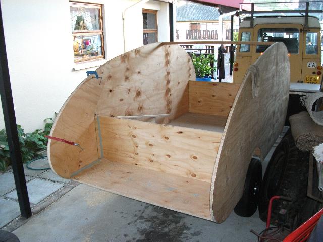

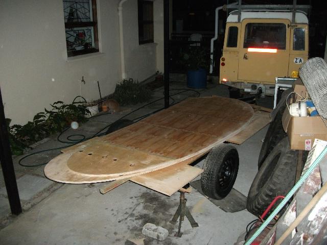

So I bought an axle and designed a chassis and got a friend who welds to weld a bunch of 50mm square tubing together, towed it home, got my Malawian buddy to paint it all, chopped up three sheets of 1220 x 2440 shutterboard (inexpensive ply, the only other type available here is d*mn expensive ply), made a floor...

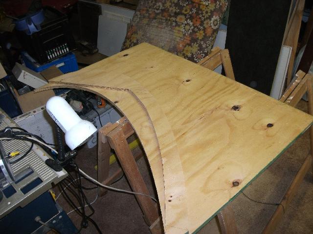

The floor is 1480 wide, which means I had to use three shutterboards. I joined two of the offcuts to two more sheets using a routed groove and hardboard, feathering I think you call it? Then drew out the four quarter ellipses, screwed the two panels together, jigsawed the curves, and got my Malawian buddy to belt sand things square.

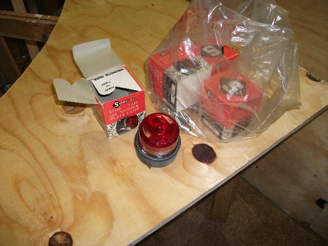

I might end up using these lights, I bought them as spares for the 1955 Series One I used to have.

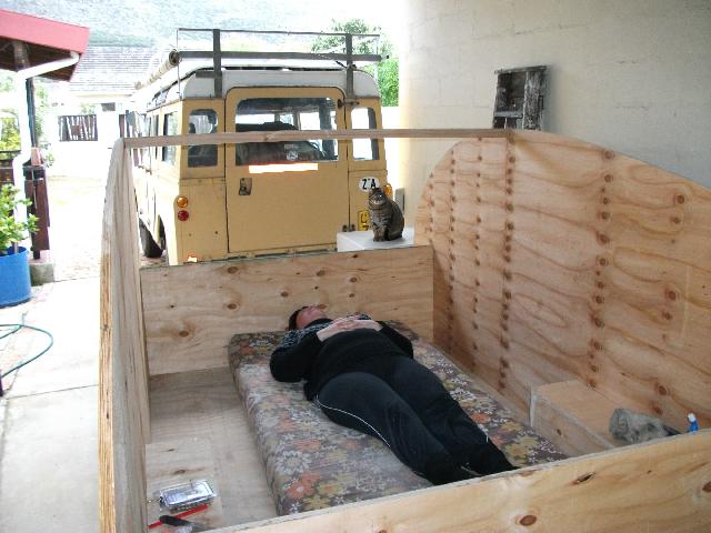

Inside space being critically evaluated (note second opinion sitting off to the side).

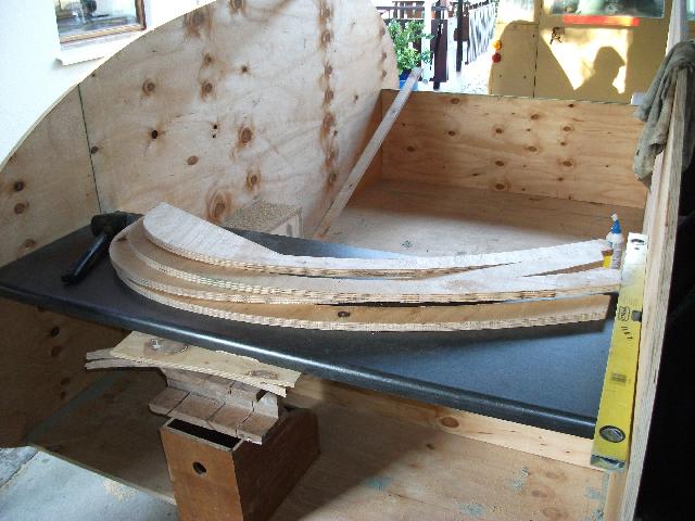

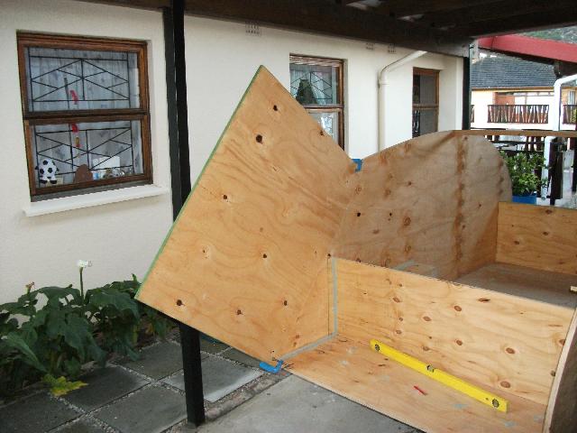

Clamped a piece of ply to the side (should have done this before putting the sides on maybe?
Routed it out. I love my powertools!
One...
Two...
Four!

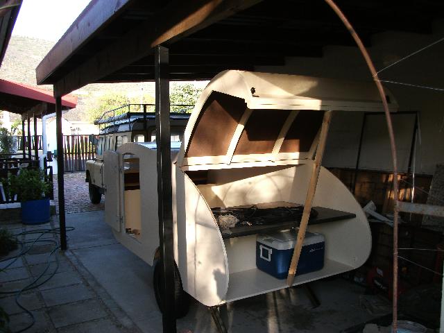

OK, so I've been somewhat busy, on the trailer and other things. Not going to post all the intermediate pics (it'll go on my website sometime) but this is from this morning. I have a door (that was fun to trim) and a roof (the 2mm polycarb bent easily) and still have to make the lights work.
Leaving for Etosha on Saturday. If it wasn't for the last moment I'd never get anything done.
