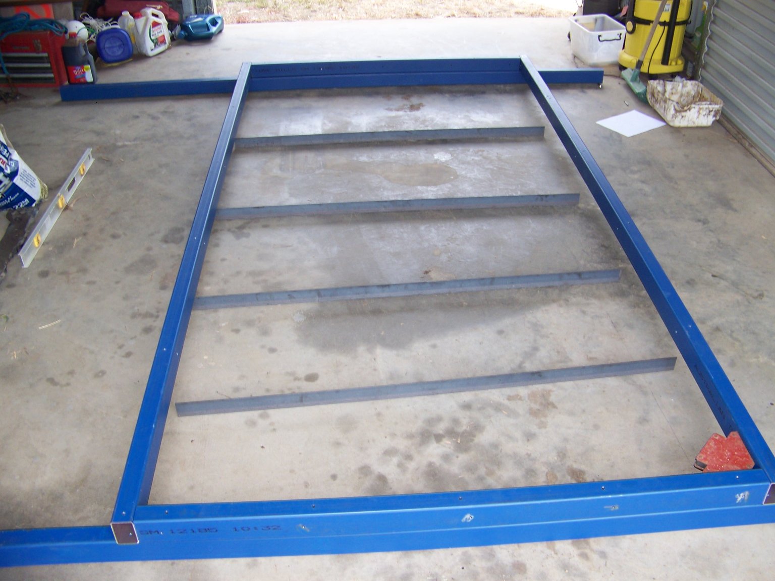

It's been a very good week. I have had the drill spinning around and I have finished drilling all the holes in the 3x2 RHS for the main frame. The holes are all drilled in the 2x2x1/8 angle and I am now ready to make with the "blue glue stick". I have laid out the RHS and set the pieces up using a spirit level that is graduated in increments of .002"/foot. The graduations are about 5/32 apart and it's impossible to hold the bubble in the middle of the glass by holding this thing in your hands. (It's an Engineers Level). I need only to check again the heights and levels and the diagonals in the morning and then I start welding. I checked the two diagonals and one measures 3409 mm and the other measures 3409 mm. Let's hope they stay the same as I tack it and then weld it fully all over. :worship:
After the main frame is welded, I will fit the "A" frame on and then fit the springs, have yet to get the springs and axle. Next week, I will ask my mate to pick up the wood for the frame and the plywood for the floor and the sides. The wood for the frame is 3x2 DAR that is bolted to the top of the RHS and angle. The 10'x5'x1/2" ply will be screwed to these 3x2 pieces. Now that all the awkward work is finished, the rest will come together very easily. It's all very exciting. The next biggest job to do will be joining the sheets for the sides. It's so good to have a decent router. I want to get as much done before the full bite of summer comes in. It's not good working in the heat, it really does knock me up. I had the the roof of the garage/workshop painted two years ago with heat reflective paint and it has made a wonderful difference. Photos will come tomorrow.

This is now the start of the welding. I have finished drilling all the hole for bolting the 3"x2" DAR Baltic pine to the frame and for the plywood sides. I have leveled it with an engineers spirit level and it's all set to "blue glue". The 2"x2"x1/8" angle is to be welded in place after the main frame is tacked and checked for squareness. Before I can fit the floor panel I also have to weld in the mounts for the shock absorbers. I have had heaps of trouble trying to locate the shocks here in Aust. I can find them easily in the US but they won't ship them overseas. After the frame is welded, I will paint the entire frame with Cold Galvanizing paint. This is fabulous stuff and the best type to use comes in a can that has to be applied with a brush. After painting with the cold gal. paint, I will then paint the top surface with a bituminous paint and also under the ply floor. I'm hoping to get the springs this week as trade for doing some drawings for a a trailer manufacturer. I have to have the springs fitted and all the welding finished so I can turn the frame over. Trying to weld something extra onto the frame when laying on my back and underneath it is for the birds. The frame sections are the pieces with the holes in them. The long RHS at the bottom (there is another one at the other end) is the base that I have leveled to align everything ready for welding. At last, it's all coming together.

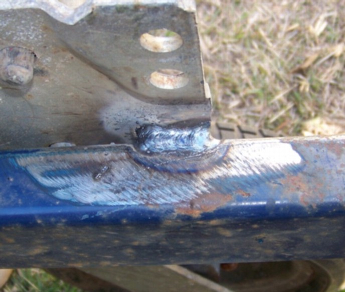

The welding has been going very well indeed. I have now almost finished the entire frame and will be ready to start the woodwork next week. I have welded all the spring shackles to their base plates and I am ready to complete the spring assembly. The hardest part has been to work when being attacked by ravenous hyenas that are fitted with wings. There are some earlier photos of these monsters. Trying to weld while you are being eaten alive has proved to be impossible. The weather has changed bringing in the beautiful South Easters and they have blown away almost all the disgusting march flies. :thumbsup:
This is the spring shackle that has been tack welded to the base plate. I decided to to use a base plate under all the shackle components as it is so much easier to weld to form a solid unit.
The base is then very easy to clamp in position for final welding. This method alleviates all the hassles of getting everything aligned on the frame with hard to manage pieces. When welding the shackles either to the trailer frame directly or on a base plate, make sure you remove the plastic bush if there is one before you start to weld. Using a base plate also spreads out the stresses on the parts and joins.
The shackles have been welded and the spring assembled. There is no bush in the welded shackle/base plate as the steel is still too hot. A white bush can be seen in the spring on the floor. The offset base plate was made to allow an existing bolt hole to be still used in the frame. Using the shackle links drops the axle down which will give me more room to fit shocks to the axle later. The open ends of the all the RHS have been sealed with a 3 mm cover plate welded all round the edges and then ground smooth. This will keep out all the water, mud and bugs within the RHS. I chose the shackle assembly instead of a Slipper Spring as I can get more clearance and a lot less noise and vibration. I have Slipper Springs on my boat trailer and they are a pain.
The spring assembly is tacked into position and now the spring and bushes will be removed for final welding. The spring assembly on the opposite side will be assembled and tacked to the frame. After the alignment is checked for integrity, everything will be finished welded. The last part to be welded is the "A" frame draw bar. When this finished, the frame will be painted with Cold Gal. paint.
The complete frame is shown here. The width to the outside of the frames (RHS) is 5'-0". End to end is 10'- 0" plus the "A" frame and the cabin is 11'- 4". The spring on the right has been tacked into position. The 50x50x3 mm angle cross pieces are welded in place and Kody is checking the alignment. She is very good at doing this. When I am welding or running the angle grinder or any noisy tool, she disappears and lays under the Kia where she can see me and be out of the hot sun. The background shows the Kia workhorse, the boat and some of the bush that fills our property.
