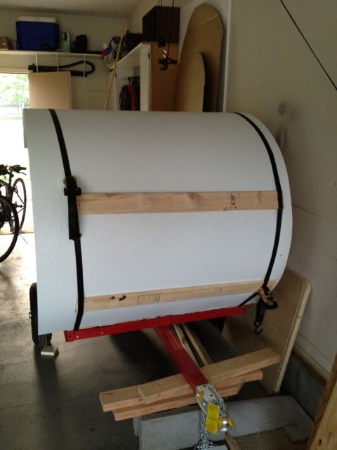

Saw you on your towing with a motorcycle thread. I to built a 4x7 for the Goldwing and hope you will allow me to offer some points I found out.
I too built on the 40 x 48 with 12" tires and tow with an 86 GL1200. After getting the body on and attempting to tow it ,it scared the s$%%T out of me. It was a bear to handle on rough (pot holed) roads. It was as if some one grabbed the bars every time a tire hit an obstruction.I immediatly went and purchased 8'6" of 3/16 wall square tube and bolted it to each and every crossmember leaving a tiny stub at the rear for a class 2 (1 1/4) drawbar. The almost 3 foot extention of the tongue completely eliminated the shakes that were telegraphing thru the frame to the ball on the bike. The stub also allowed for an accessory rack or a bicycle rack which helped to balance out the tongue weight as needed. I later found the 12" tires had the trailer to far nosed down for my liking and I opted for 8" tires dropping the towing height enough to arrive at almost level but still just slightly nose down. This change also improved the handling noticably. It was fun to tow and I loved the double takes as I rode past my fellow motorist. I later utilized the same frame for my chuckwagon build so pics are in the album.

bobhenry, thanks for the pointers and yes, Eggbert looks very familiar!
I have an '85 GL1200 Interstate, but I only have a hitch on my '95 GL1500. I plan to purchase a 36" tongue extension from Redtrailers.com. This will provide a total tongue length of approximately 90". I've read that the total distance from axle to hitch coupler should be roughly 2 1/2 times the distance between the center of the trailer wheels. As soon as I get the roof installed, I plan to take the trailer on a 'shakedown run' to see how well it tracks behind the bike.
