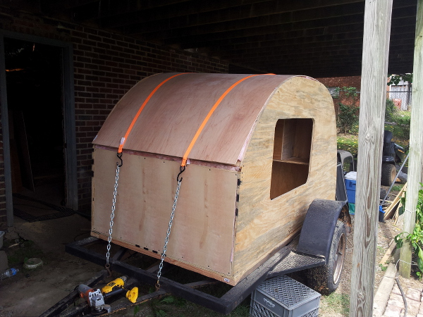

I got long winded in my newbie intro thread about my build, so I thought it was time to move over here. So far I have most of it framed in. I hope to build my door and hatch this weekend. Here's a pic of the wreck so far:
trailer build v1_6 tiny.jpg (177.53 KiB) Viewed 2603 times
The plan is to fiberglass the top and seams with cloth and epoxy, simply epoxy the walls to smooth and protect the plywood, then paint it.

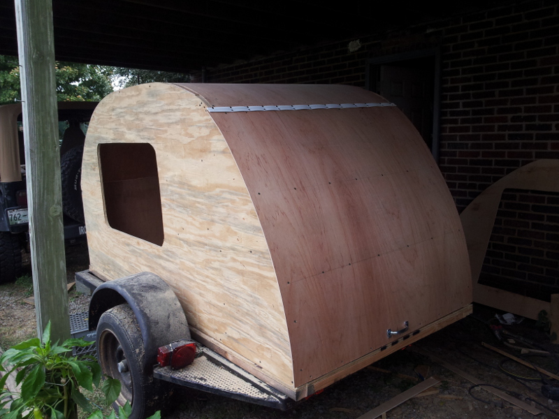

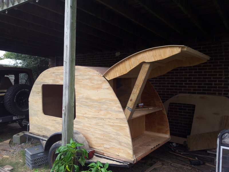

Well the hatch is almost done, just gotta drop the tail lights in. Next up is the door.

Postby Junkboy999 » Tue Oct 09, 2012 8:05 pm
Man that is one big hatch hold up stick thingy.

Yeah the prop might be slightly overengineered. lol Unfortunately, the crack between the floor and the wall only manifests itself once the wall is installed so I'm kinda stuck with a vertical application. I went with Aeromarine Epoxy which I would imagine is pretty similar to the West system. I may try again tonight and see how it goes with the cloth.

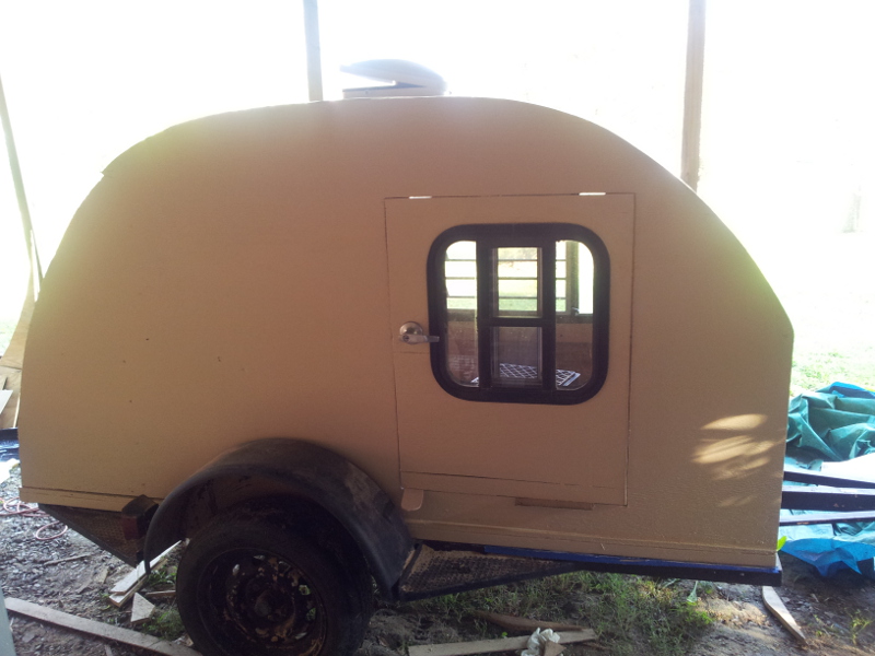

Well after KC straightened me out on proper Bondo usage I made some more progress: :oops:

Re: Yet another build
Postby bonnie » Sat Oct 13, 2012 7:16 pm
I like that window. Where'd you find it?
Postby dotsun » Sat Oct 13, 2012 9:26 pm
bonnie wrote:I like that window. Where'd you find it?
I bought them both from a guy that was parting out his motor home.
