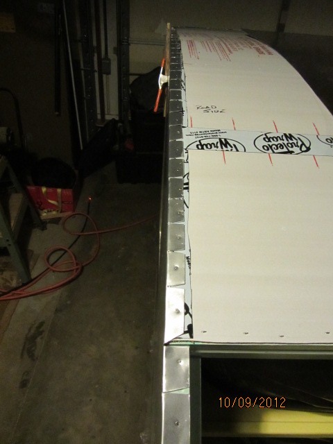

Postby Irmo Atomics » Tue Nov 06, 2012 5:00 am
Your camper is looking great! I hung my aluminum skin by the edges/trim and and it seems to have worked well on all but one piece. The curb side wall skin feels like it has a little air under it. I can push on all the other pieces and not get any give, but I must have hung that one piece a little loose. A patch of contact cement in the middle of the panel might have helped to keep it flat as I was securing it at the perimeters. What thickness aluminum did you get?

Postby Irmo Atomics » Tue Nov 06, 2012 12:01 pm
I used stainless nails for some of it, then I decided to pull out my air stapler. Everyplace that I stapled or nailed is covered in trim that's screwed on. I overlapped the sides onto the top and lapped the top over the sides. Here's a shot looking at the roadside wall from galley to the front. You can see where I tabbed the aluminum and nailed it on. I used .032 also.
