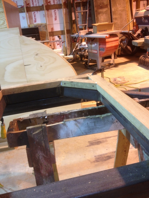

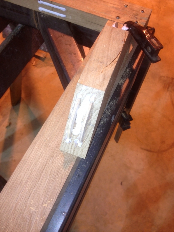

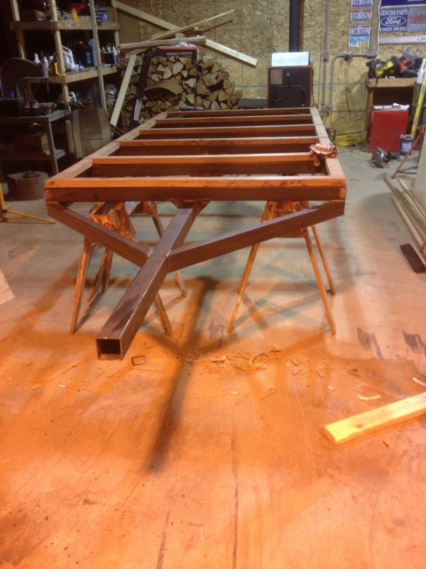

Well I'm another step closer to starting to body. I finished welding what I had left to do for now. Here a few updated pics.
this is the white oak frame dry fit
Here are the gussets I installed with double biscuits and screws
And another view
Image.
I fabled the frame from 2x3x.120 wall tube steel with a 3x3x.120 wall tube for the tongue. The hitch style is still up in the air not sure what i want to do yet. I stick welded most with 7018 and finished today with a mig welder which was a lot quicker and easier.

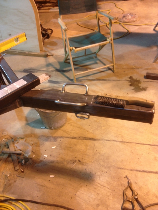

I got bored so I added some handles and the safety chain links to the tongue last night. Image.

Ben wrote:I got bored so I added some handles and the safety chain links to the tongue last night. Image.
The tongue handles are awesome! I may have to do that myself :)

Postby Ben » Mon Nov 05, 2012 8:09 am
Thanks it don't take much I used 1/2" stainless steel slick rod it's some left over material from another project I done.

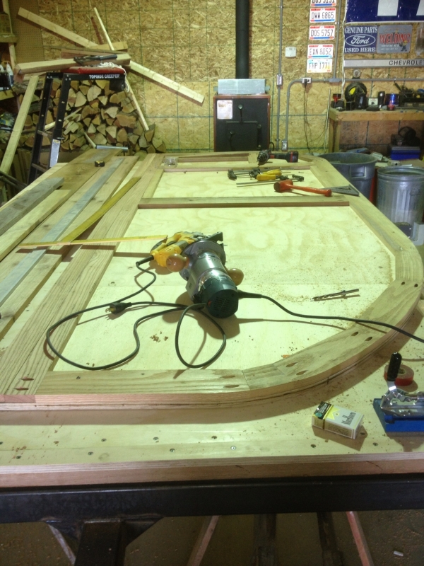

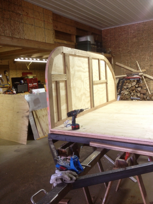

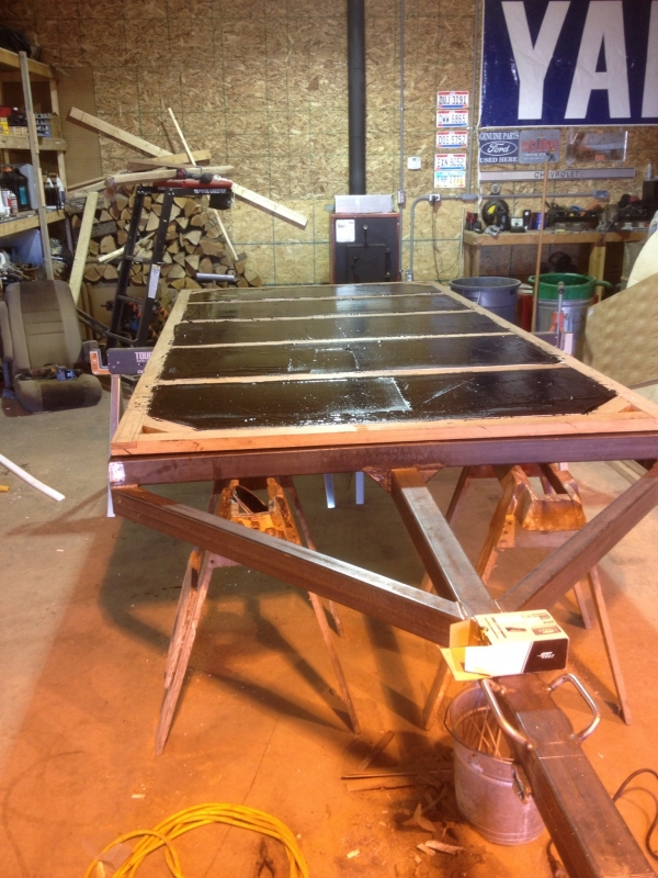

Postby Ben » Sun Nov 11, 2012 5:02 pm
Well this was where I started this weekend Image.then to the black goo stuffImage
Then this is what I was hoping for Image
So I made it that far so I went a little farther. And I got to this point Image
And back to this point. Image.
I need to layout for the spars and get back to planning boards for that task.but I needed a snack so I came home for a bit and might get back out there in a little bit. We do this for fun right? I don't work to well when I'm hungry lol...
