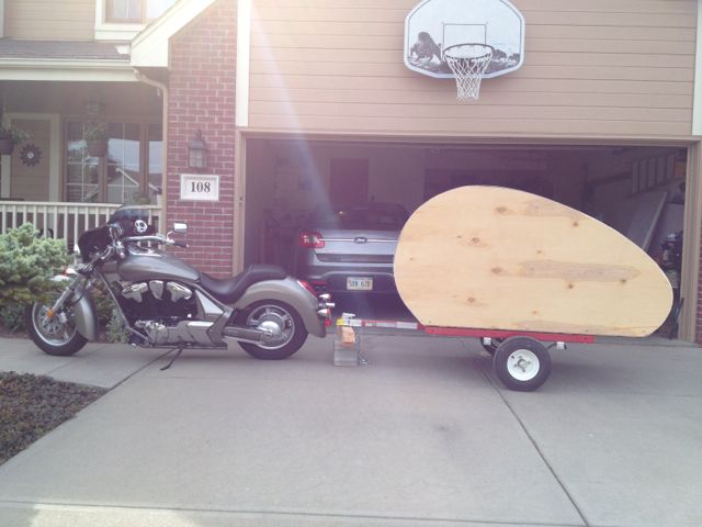

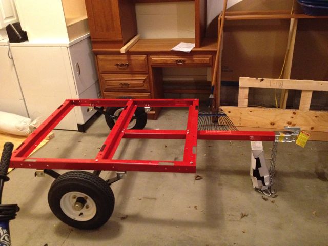

Great, another new guy. I am working on a trailer to tow behind my motorcycle. This is my first build and I have been reviewing this blog for some time trying to get ideas. You guys are a great inspiration for the DIY person. Here are some pics of my progress.

RedRider, have you calculated the estimated tongue weight of your build? I've read on several MC forums that a tongue weight of 10 to 15% of the total trailer weight is recommended. Also, I am extended the tongue on my build. I bought a $10.00 fish scale and my tongue weight so far is 30lbs..

I haven't weighed the tongue yet but I actually had to move the wheels back some because it would actually do a wheelie. Almost launched my 11 year old. LOL.
I used a combination of FRP glue (very expensive $25 per gallon and only needed less than a cup) and aluminum strips. Unfortunately the glue doesn't come in tubes and it is not recommended to use other glues. I am not sure why though. The aluminum I used looks like it could go into a door threshold but I don't know what it is called. I got it at Menard's for about $5 for a 10 foot section. It almost looks like a pro did it. Almost. I will try to upload a pic of the material.
