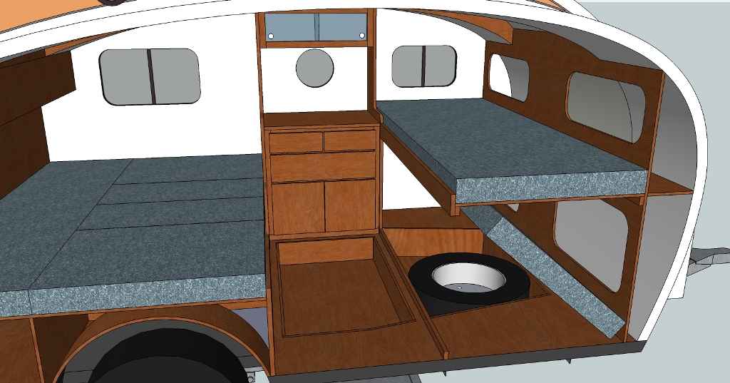

I originally thought that I would model my build off the ATMA Travelear, as I fell in love with his build. He was gracious enough to share his plans with me for the trailer as well as the teardrop. As an experiment, I did a mock up of the tear as an 8 footer, versus the original ten. The reason that I did this, is because my CNC contact can only cut up to a 4x8 sheet, so it would eliminate having to splice pieces together. I'm 6'2", and I'm worried that I might not have enough bed space when shortening the tear to 8 feet. It would cut down on the space in back at the galley as well. Thoughts?
When I shortened the trailer frame, I also lost the space to put the spare tire mounted underneath in the back. Anyone put it underneath, but up front? I've added a 2" receiver on the back, as well as 1" receivers on the back corners. The 2" will hold a bike rack, and the 1" will be for side tables or awning posts. I've also seen conversations on the forum about stabilizer jacks on the back and how some feel that they are better on the front, so I'll continue to research that. I'll probably end up sticking with the original plans, just thought I would toss this around as an alternative. Any ideas and opinions are appreciated.

You could do a dropped floor storage area for your spare tire. That would also give you a little extra space to put a few other items like wheel chocks and a tire wrench. Here is a picture of my dropped floor storage area for my spare tire.

Having the spare inside in a dropped floor is a great idea. There would be some additional storage, for items you may not need all the time, and to get at them you'd only have to lift the mattress. After a quick conversation with the wife, she reminded me that having the extra space in the 10 foot tear would accommodate our derpy dogs if needed, so I'm back at the drawing board with the original trailer modifications. I'm planning on installing a Pet*Cool for heat/AC, and was also toying around with the idea of a raised deck to run the air return and some of the electrical. I see that most people wire their tears by going over the top. Has anyone who has wired some underneath have any comments. I was thinking that for some of the lights, and electrical to the galley could be routed in the raised floor, while other things like the fantastic fan, and trailer lights could be routed above.
Here is a sketchup of the sidewall sitting on the deck, and raised flooring, or at least this is how I see it in my head. This would be different than the original ATMA Travelear in the sense that it would be 2 1/4" taller, as it would be sitting on a recessed raised desk. If I didn't do it this way, I might run into clearance problems with the torsion axle. Again, thoughts are appreciated.

Hi Mike, The Travelear is designed around a queen length bed for us tall guys (I'm 6'2" as well). There's quite a bit of room in it. The tongue box has room for a lot of stuff like the PetCool.
Your wall attachment plan looks like it would work just fine. Lots of builders have routed their wiring in the floor and under it in conduit. Others routed theirs in the ceiling like me. This is going to be a fun build to watch good sir. Thank you for the shout out!
