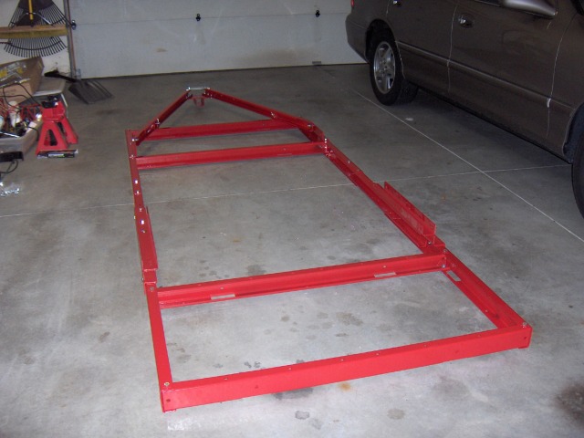

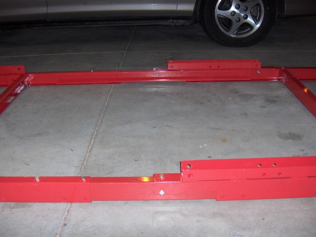

Here's the begining of my build journal. I’ve decided to build the Compact because I'm tired of bending over trying to sleep in the back of my truck. I'm using a Harbor Freight 4x8 frame that I bought for $270 on New Year’s Day with a 25% coupon. I’ve extended the frame to the length outlined in the chassis plan for the Compact. I’m using the 1720 lb trailer and plan to weld all the joints and extend the tongue this weekend and add some angle iron on the sides of the trailer for support of the floor.

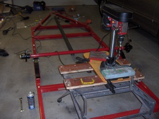

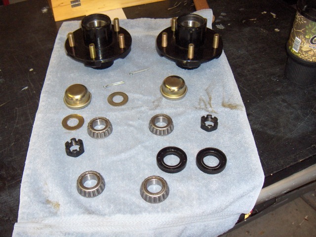

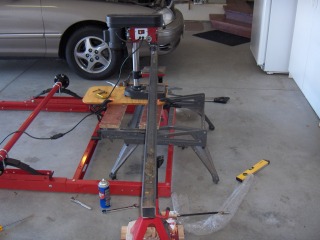

Was able to put in a long day working on the trailer but really doesn't look like I accomplished much. Got the bearing cleaned and repacked and mounted on the axle. After that I began drilling the holes in the 2x2 x 3/16th square stock. I started off using a varialbe speed hand drill because I had all the steel clamped in place and squared up. After an hour and half of drilling and sore hands I decided I better use the drill press and just re-square everything after the holes are drilled. What a difference the drill press made. Almost like going through butter (not really but a heck of a lot better than holding a hand drill). I've also improved my drill bit sharpening skills with all this metal drilling. Only 2 more holes to drill and I should be able to bolt it all up, put the tires on and wire up the lights. Hopefully I can get that completed tomorrow.

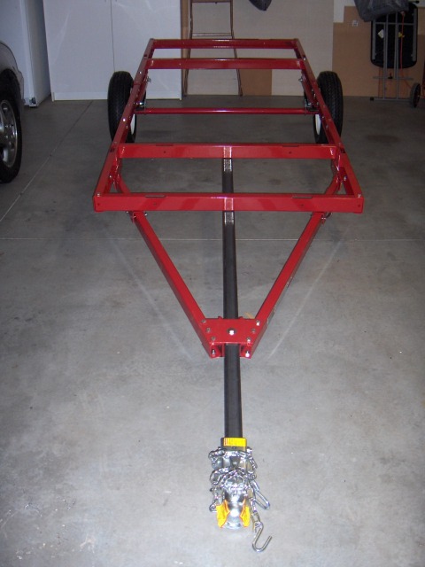

After a little shop clean up, I was able to bolt the tongue extention to the frame and put the tires on. Just need to wire up the lights now and then weld all the joints. Starting to think about the flooring and what type of wood to use. Thinking of 3/4 inch ply but hear bad things about the HD ply on this site. I checked with the service desk and they said they don't carry any marine grade so I'll have to check the local lumber yard and see what they have available.

Postby angib » Wed Jan 16, 2013 4:31 pm
Please bear in mind that the weight estimate I did on the Compact predicts that it weighs 1560 pounds empty, or as much as 2100 pounds loaded, with a full water tank.
I think the HF trailer frame is probably strong enough for a Compact, but its tongue might need reinforcement and the axle and wheels/tyres might not be up to the load - but it's not a big deal to replace those if the weight comes out too heavy.
