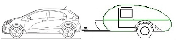

Here is a drawing of what the 5 door version of my car would look like with a New Cub Lightweight behind it.

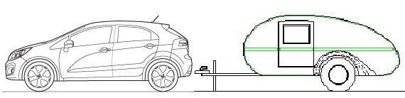

And one with a tongue box.
And another tongue box design.

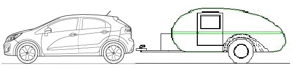

And here it is with simpler round mudguards probably more in keeping with the Kia Rio styling.

Hamish121212 wrote:What are your thoughts on this?
First thought is, "thank god I am no longer the most verbose poster here". :R You are very well written and I look forward to your future posts. :thumbsup:
My next thought is that using the hatch as a canopy my not work depending on the size of the stalls provided at your typical market. Here in the US swap meets and market fairs typically have an assigned zone that vendors must stay within; not necessarily conducive to presenting the arse end of a trailer to the presentation side while still fitting "inside the box" (i.e. the canopy seems like a necessity). Some designs include a storage section between the cabin and galley, accessible through hatches in the side walls. Maybe that would work for you for storing canopy, table and chair(s).
Third thought (not necessarily in order) is that you may not be able to store your soap products in the camper when idle if they are subject to degradation due to heat. It is my understanding that these little boxes can become quite unbearable when subjected to warm climates and direct sunlight.
My typical advice is to study, study, study. Look at all of the stickies (the fixed posts at the top of each forum) and build journals that you can stand. And don't miss the "Foamie" section. Lots of light weight solutions there.

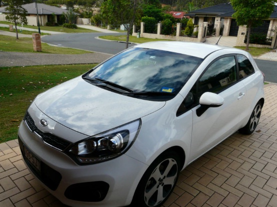

My Tow Vehicle. A super efficient 2012 Kia Rio SLS 3 Door 1600cc.

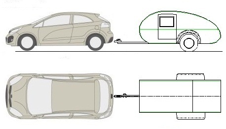

I just had a measure of the width of my Kia Rio - looks like the New Cub Lightweight is just slightly narrower than the car by a couple of inches. That's to the outside of the trailers wheel arches. And that does not include the mirrors on the car - just the main body. That means the body should tuck nicely behind the car. I don't know much about aerodynamics but I'm guessing that is a good thing for fuel efficiency. It will certainly make using the cars mirrors very easy as the main body of the New Cub Lightweight is narrower again than the wheel arches. So it should give great rear visibility using the car mirrors.
This gives the general idea.
