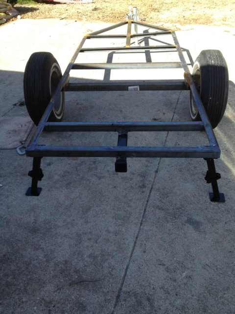

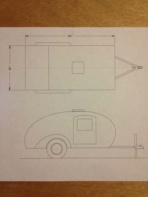

After lurking and planning for a couple of years, I finally started my build. Plans are for a Grumman 2 profile, 10'x5'.
I purchased a trailer from harbor freight, but, with having to extend the tongue and move the axle back, I decided to build my own just how I wanted.

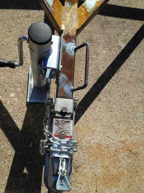

Chassis is 4x13 with a torsion axle, 2" rear receiver for bike rack. Almost ready for paint.

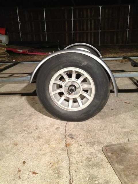

Postby Ocelli » Sun Jan 13, 2013 10:14 pm
Fenders are just sitting on tires, not sure I want to use these wheels, it's just what I had lying around.

Postby Junkboy999 » Mon Jan 14, 2013 12:34 am
So is the frame made of all angle iron? Is there square tube where the axle mount?

Postby Ocelli » Mon Jan 14, 2013 9:45 am
Yes, 1' of 2x2 steel square at axle and 6' at tongue.

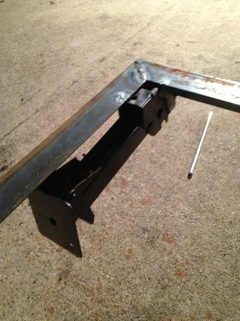

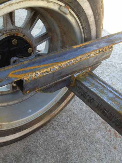

Postby Ocelli » Mon Jan 14, 2013 5:22 pm
Square tube at axle connection.
Added receiver to rear of chassis.

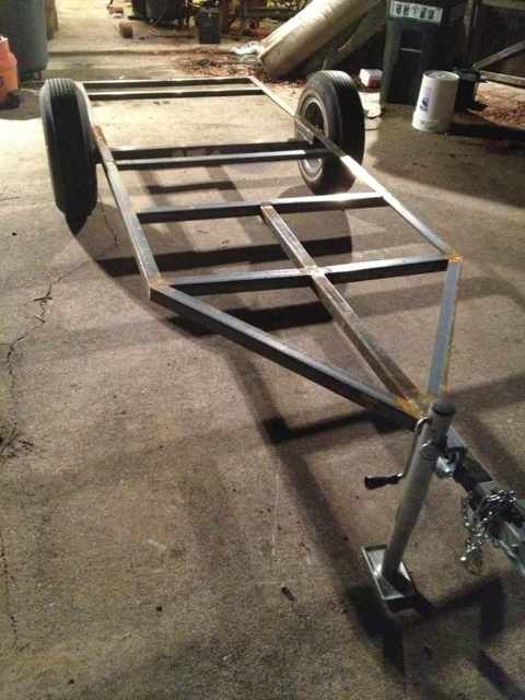

Postby Ocelli » Fri Jan 25, 2013 1:58 pm
I think I have a name for my TD
"Isopoda or Isopod"
The order of pillbug or roly poly
Armadillidium vulgare (family) was to hard to say/spell
Pillbug/roly poly too common
Woodlouse......hmmmm, maybe a woodie for build #2
I could do a play on the L and look like wood house.
Oh well....never ending plans....
Can y'all tell I'm an entomologist?
Frame done, trial fit with fenders. Rides true and level. Ready for floor, yea!

Postby KCStudly » Fri Jan 25, 2013 11:25 pm
Hey, no offense intended, but that weld in your first pic from your Jan 14 post looks a little suspicious. :roll:
If I am seeing it correctly I think I see lots of voids and maybe some incomplete fill on the lower side. :frightened:
That being a very critical weld where the axle mount ties to the frame, you may want to grind that out and try again (or get someone with more experience to weld it up for you).
Don't mean to be a stick in the mud, just saying. :worship:
I know pic's can be deceiving, but they usually hide the details so... just saying, make sure you are safe. :thumbsup:
There is a lot of linear joint there, so maybe it is strong enough, but ?
The person performing the weld is the first (and sometimes last) stage of QC. You have first person visibility on the situation; what is your gut telling you? Did the puddle melt in solid on both sides with good fill tying everything together?
My rule is, if I can't see the puddle forming, or if I am unsteady, I stop and reposition myself to where I can see the puddle, where my elbows and hands are resting solidly, and maybe even reposition the work so that I can ensure a good solid weld that passes my inspection both while performing the weld and after the fact.
Re: Dallas Grumman 2 build
Postby Ocelli » Sat Aug 03, 2013 8:50 am
You're right, I had someone redo the welds and he added some extra support in a few areas.

Postby CliffinGA » Sat Aug 03, 2013 9:30 am
So any new pics of the frame and what you had done to it? Using that much angle did you have a lot of flex in the frame?
