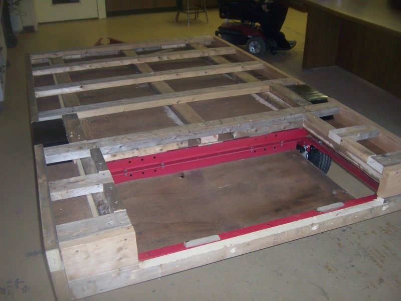

Postby len19070 » Sun Jan 27, 2013 9:26 am
Finished up the rear dropped floor area this morning.
Next some under the deck wiring, then the decking.

Postby len19070 » Sun Jan 27, 2013 10:59 am
Martiangod wrote:the drop is awesome idea, thats the worse thing about my build is the entry being so high at the rear. Cant mod it though as my black water tank it across at the rear....
Build On !!!
Thanks!
I finally got to sit on the deck today with my feet in the "Pit"
My original thoughts was to be able to sit semi comfortably and put my shoes on in the morning and to have a place to store my shoes at night...Inside!
The second was to not bring a lot of extra equipment. The rear door eliminates a second EZ-UP.

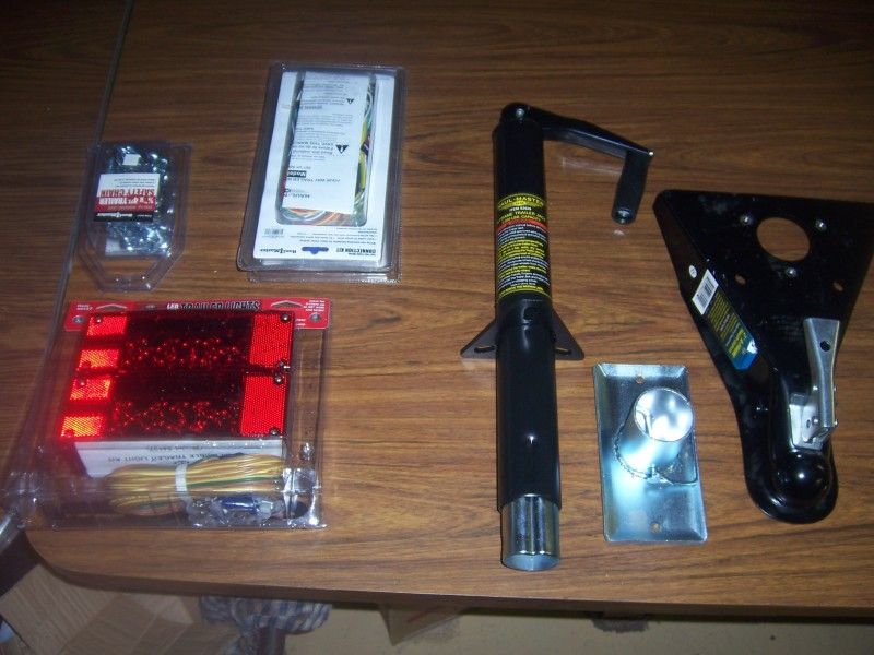

Postby len19070 » Fri Feb 08, 2013 6:22 pm
Just installed this after work.
This works and looks so much better than that "Chinese Knuckle" that HF gives you. (and for only $10 more)

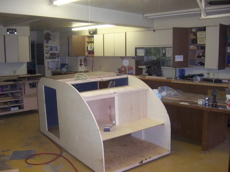

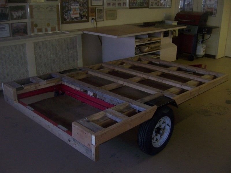

Postby len19070 » Sun Feb 10, 2013 5:32 pm
Didn't get as much done as I had hoped this weekend...Had a "Snow Day" here back East.
But!
Did all the under deck trailer wiring, insulation and decking. Cut out the first profile.
As my neighbor put it "It wasn't as "Swoopy Lookin" as my other trailers."
So I changed things,
It should look better once the 5" Skirting below deck is in.
Happy Trails
