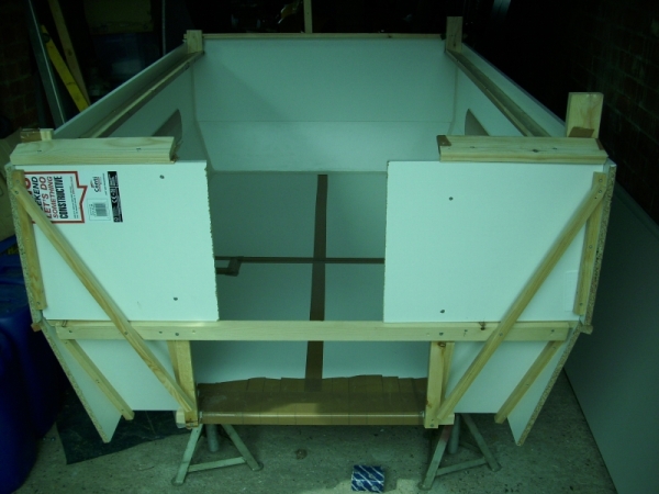

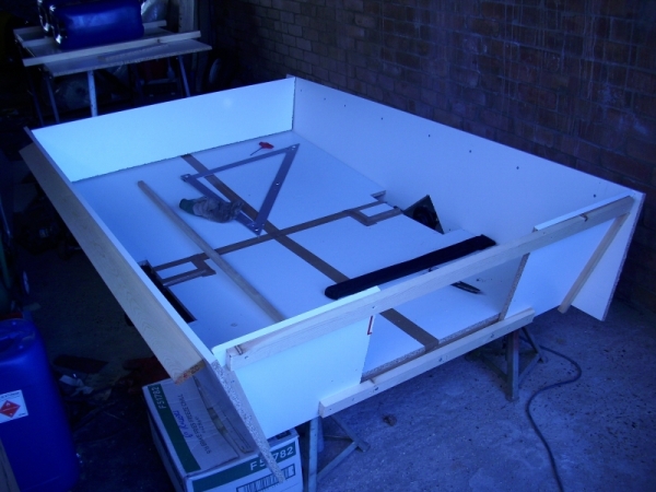

The process used was to make a very basic female mould using "contiboard" which is a melamine plastic coated woodchip board - it has a good flat surface of satin finish, i.e. not high gloss, but certainly good enough!. I welded the chassis using rectangular hollow section of varying sizes, and an electric arc welder. The mould was created on the chassis using the flat sheets of contiboard and various pieces of timber, to give a "box" to laminate the lower part. The 2 photos attached show 2 stages of the process. I filleted the corners to a radius using plasticine and a glass marble. The mould was then polished with wax many times. Gel coat was applied to the surface, followed by layers of matting and resin in the normal process for fibreglass construction. After several days the parts of the mould were unscrewed from each other and removed from the glassfibre, and then some insulation foam (brand Cellotex in U.K.) was added to create the bumper (fender) shapes and the wheelarch shapes, this was then covered with matting and resin, followed by gelcoat and flatted with abrasive paper until good. The white hinged sides were made in a similar manner on a flat board with edge strip to produce the mould. The top was made again in the same way, but using a sheet of hardboard (masonite in U.S.?) supported by a framework to create a curved top.

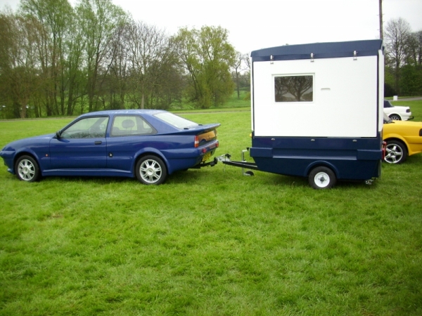

The finished folding caravan "Quantumsleep"

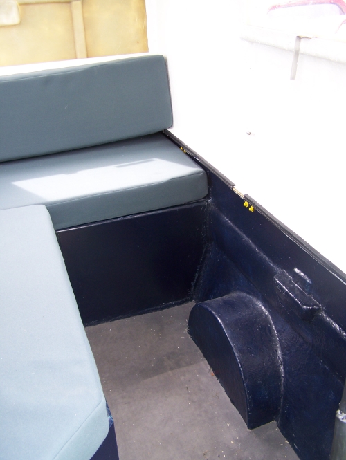

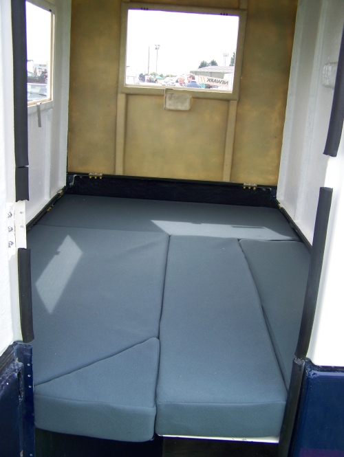

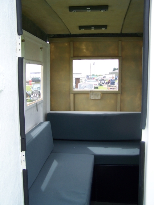

Postby Mitchelkitman » Mon Jun 17, 2013 6:37 am
Mitchelkitman wrote:
KCStudly wrote:Be nice to see how you outfitted the interior, too.
I have no interior picture - I'll take some :pictures: and (try to) post them up. Basically a simple L shape for seating during the day, with 2 backrest which "fill in" the remaining space to create the sleeping area.
Have taken some interior photos at the Newark Kit Car Show in U.K. last weekend, but I don't seem to be able to attach them to a note. I don't usually have problems with computers, but I just don't seem to have any luck with this site :x
Oh - I think I may have been sucessful??
Interior3 500.jpg (219.33 KiB) Viewed 2795 times
Interior2 500.jpg (188.68 KiB) Viewed 2795 times
Interior1 600x800.jpg (192.93 KiB) Viewed 2795 times
