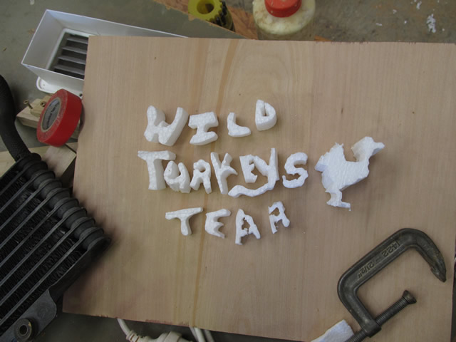

so now im waiting for glue and epoxy to set so i started to work on some of the smaller more detailed components. here i am making some vents to go near my feet.103479
its times like these i wish i was back at my old job programming the CNC. something like this could be spat out in minuets but alas an half an hour later...
103480
hopefully the local hardware shop has the glue i want tomorrow and i can continue using glue drying time to do the small efforty stuff. its a good system.
