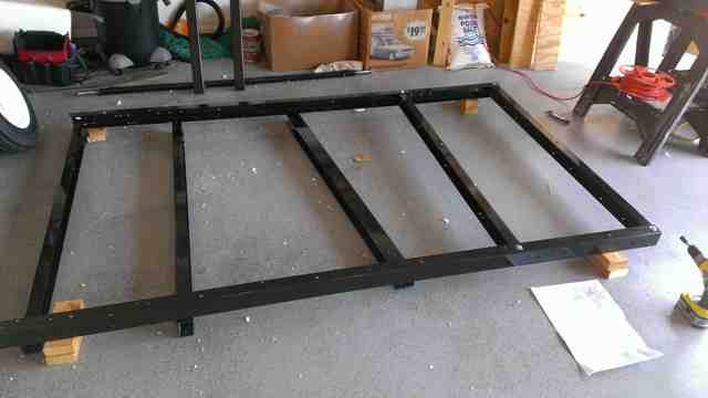

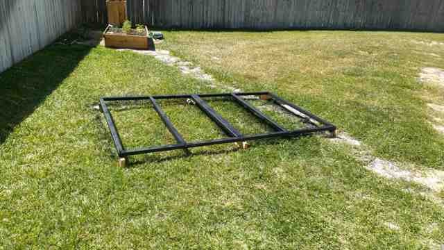

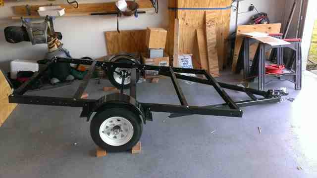

The trailer from Northern Tool finally arrived. Three weeks after making the decision to build a teardrop I finally got to put wrench to bolt and get started. Once it was out of the box I laid all the parts out.
Started bolting things together.
And got the whole thing assembled.
Took it for a quick trip around the neighborhood. It tracks straight, which was my primary concern. It seems to bounce a little bit, but I'm sure that's just because it is so light.
Tomorrow morning it's off to the lumber yard to get some wood, bolts, screws, and some wheel chocks. I'm hoping to have the floor framed out tomorrow. My plan then is to get the trailer registered over the week, and then next weekend I can use it to haul my larger pieces of plywood. Since I have a Jeep, hauling a full sheet is tough. I'll appreciate having the trailer to use to haul the rest of the heavy stuff for the build.

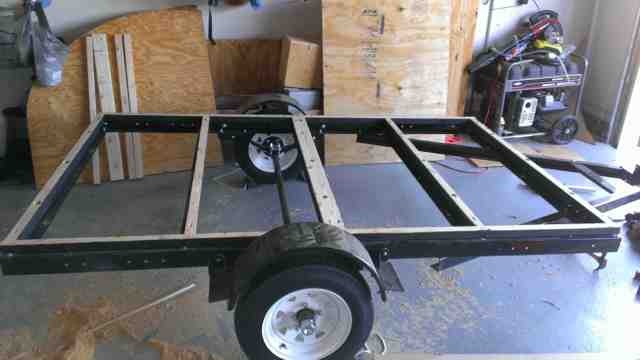

Postby stanimal » Sun Mar 03, 2013 10:47 pm
Made some sawdust today!

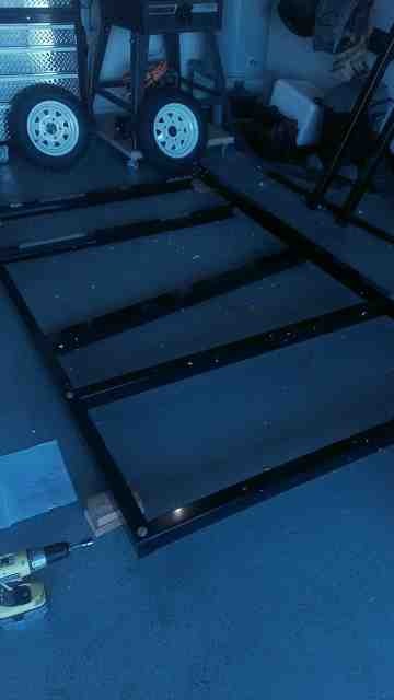

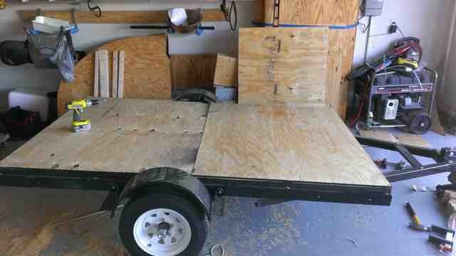

I bought several 2X4's and ripped them down into 2X2's. Also bought 2 sheets of 1/2" plywood. I thought I was being smart and saving myself some work by having the store trim them down to 58 1/2 inches for me. Being the trusting sort, I didn't check the cut when they made it. Turns out they cut it at 58 1/8" I've got a gap running all around the perimeter of my frame. I don't think it's a huge deal. I can hide it with the some quarter round or something when it comes time to do the finish work.
Framed out the sub floor, got is all screwed together, and then coated the underside of everything with Armor Liner bed liner. Waterproof and tough as nails. Got the sub floor bolted to the frame, recessed the bolts and washers, tightened them down with washers and lock nuts. Then used about eleventy billion outdoor screws to secure the decking to the sub floor.
All told, a good weekend of work. Assuming the wife approves the next purchase, next week is buying two sheets of Oak 3/4" plywood for the side walls, and then the real fun starts to happen.
Thanks to all who have helped me get to this point. I realize it's not much yet, but it's gonna be.

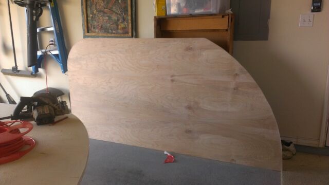

Postby stanimal » Sun Mar 17, 2013 8:24 pm

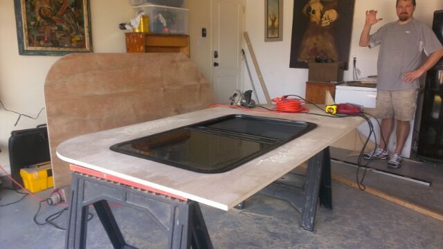

Got back on track with my build this weekend. Up to this point, I had a trailer, subfloor, and floor ready to go. Saturday I h=bought two sheets of 3/4" birch to use for my walls. I got the shape cut, cutouts for windows and doors done.
FYI, I was talking when my wife took the picture, but if you want to think I was waving hello to you, that's OK also.

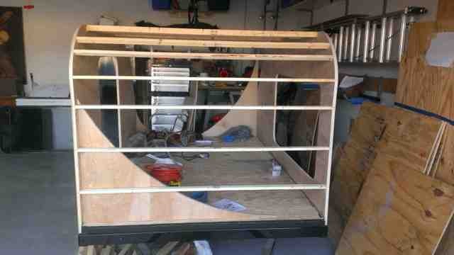

Postby stanimal » Sun Mar 17, 2013 8:37 pm

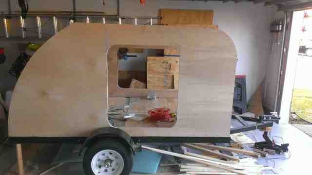

Got the bottoms of the walls sealed, and then attached them to the trailer using another eleventy billion screws. Got several spars put in place, and have managed to keep the whole thing square (well, within 1/8 of an inch on one corner. Close enough for this guys standards.
Finally though, it has risen, has a shape, and is starting to look like something other than a utility trailer and some wood. I've noticed a clearance problem with the door and the fender of the trailer. I think I'm going to have to cut a corner off the door and use it to fill in on the wall. I think some screws and some sanding and filler will make it essentially unnoticeable.
Im going to have to buy some more things before I get too much further along. Roof vent fan and a hurricane hinge probably need to be grabbed
Not yet sure how I will make the the outside. Since the trailer is five feet wide, I am thinking of ripping two sheets of thin ply at 2 1/2 feet each and stitching them together old school boat building style. Lots of decisions and design elements to come up with yet.

Postby spbiknut » Mon Mar 18, 2013 11:32 am
Very nice! Does your door clear the wheel fender? Looks like it does, but can't really tell from the picture. Congrats and keep up the great work!
