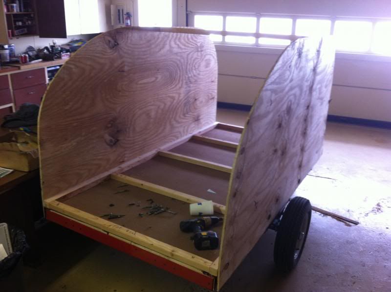

Postby len19070 » Wed Mar 20, 2013 2:12 pm

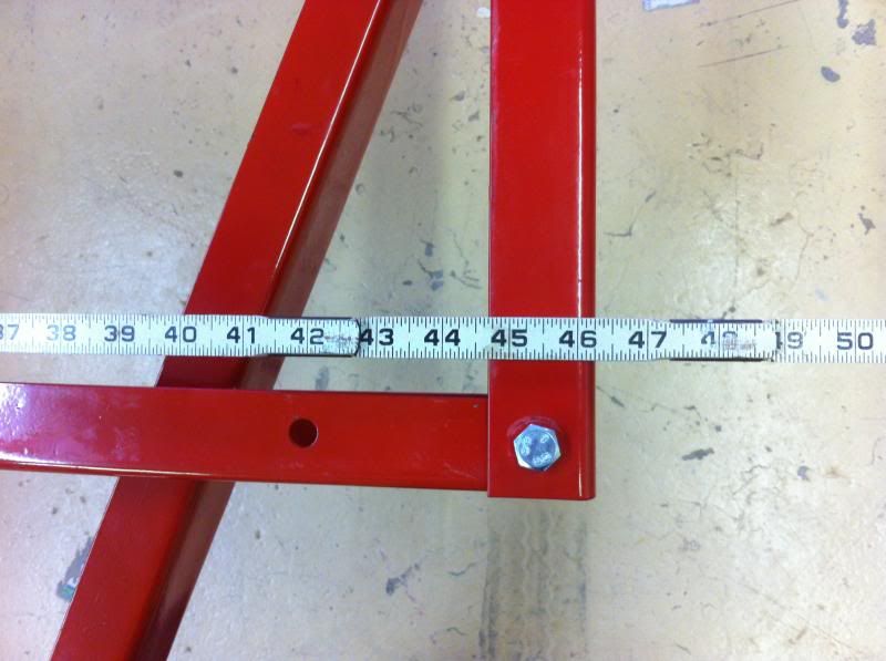

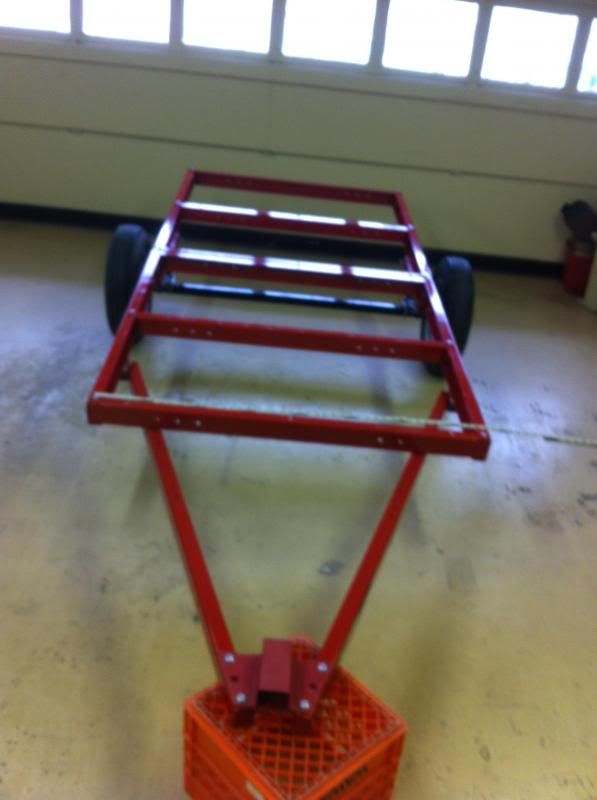

I started a new Tear Monday. Narrowed and assembled a new frame to 46 1/4" wide.
This is going to be a simple 4X4X8' build on a Harbor freight Frame.
Cut the Profiles, built the deck, Tarred the bottom and mounted the deck & sides to the frame.
Tomorrow I'll insulate and lay the deck, Start laying some Rug, assemble and rug the interior ceiling panel and hopefully install it.

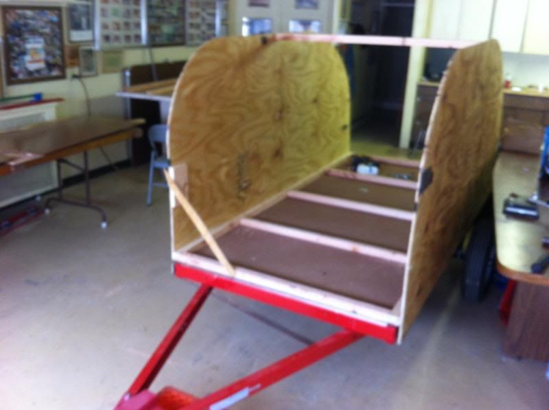

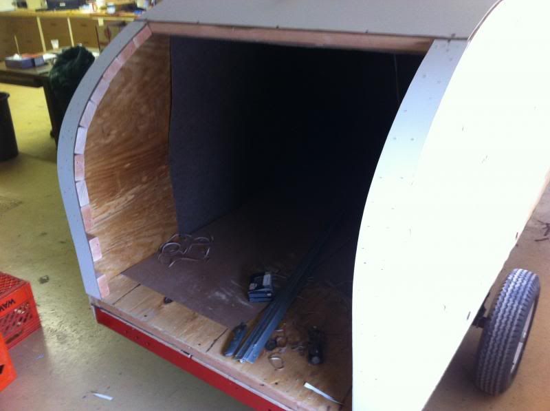

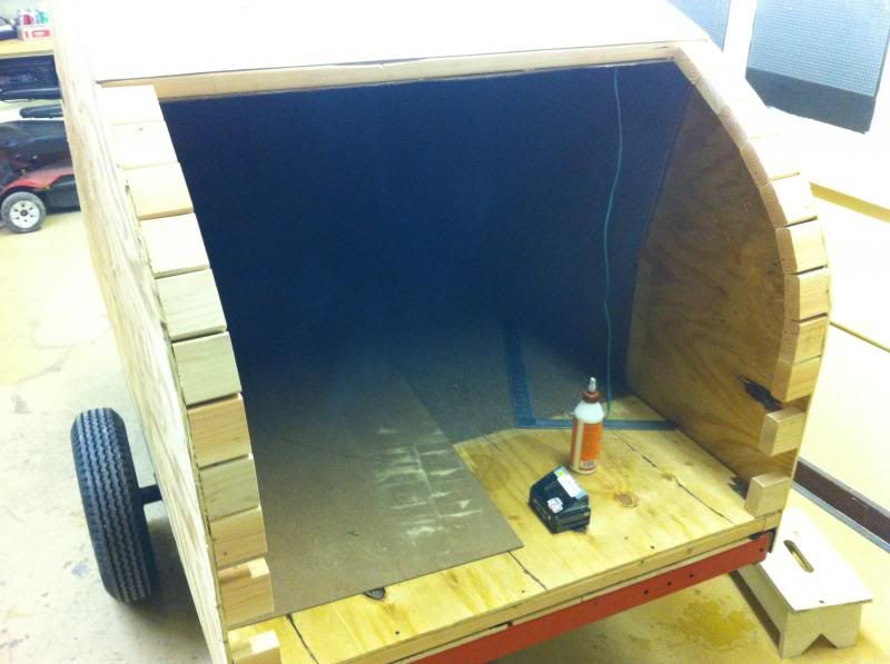

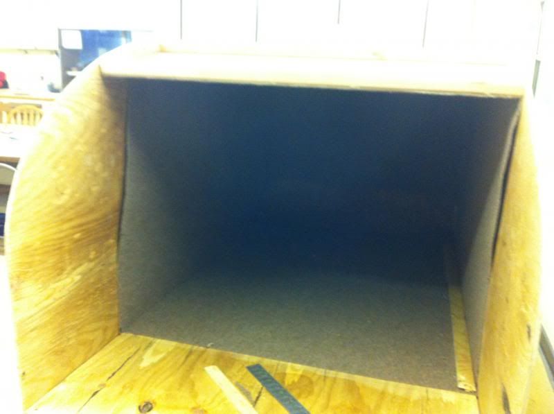

Postby len19070 » Thu Mar 21, 2013 6:24 pm

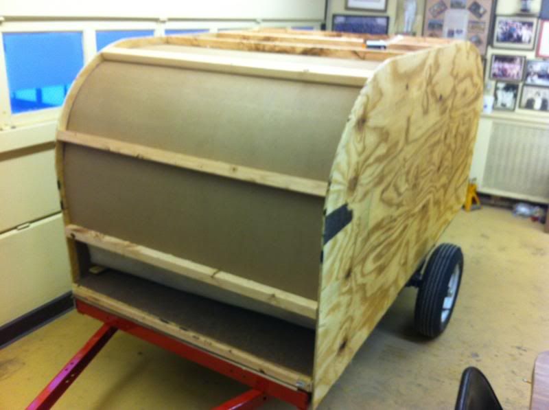

Got right where I wanted to today.
Deck laid and insulated, floor and side Rug in, ceiling panel built/rugged and even installed.
Got a lot of catch up work for tomorrow, wiring, trailer, interior lights & fan, install the "A" hitch head and Jack and a small piece of the ceiling in the front.

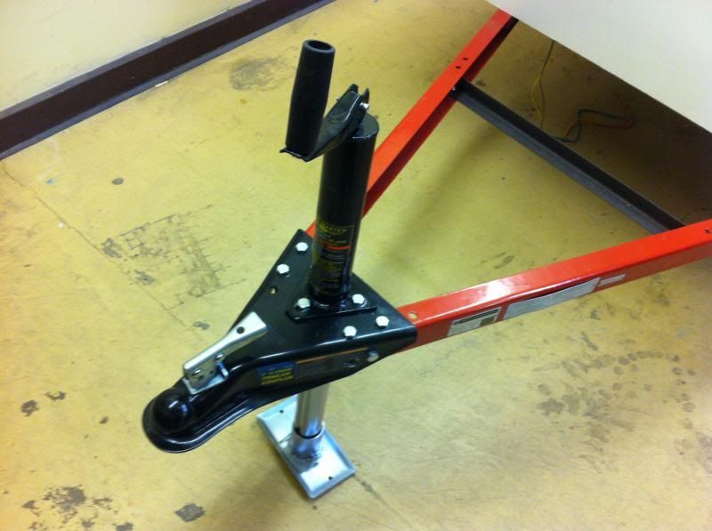

Postby len19070 » Fri Mar 22, 2013 8:27 pm
Got the outside sheathed, insulated and wired for inside 12V.
Started some work on the hatch area.
And set up the "A" frame hitch.
Tomorrow I just have to take a step back and think of everything I have to do before the Aluminum skin goes on.
Happy Trails
Len

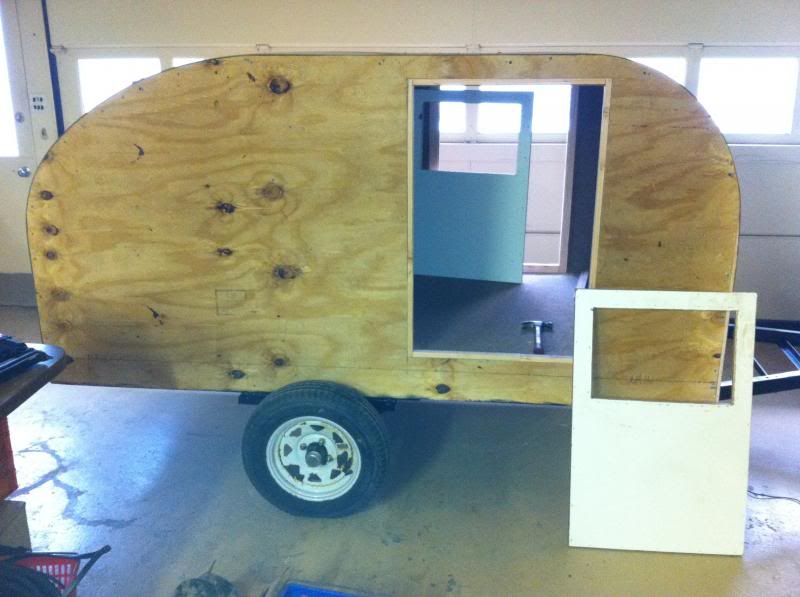

Postby len19070 » Sun Mar 24, 2013 1:53 pm
Not much visible work done recently.
I painted the frame.
And sheathed the sides of the galley.
A lot of "Gettin Ready" for other stuff goin on.
Laid out the doors, made the templet for the hatch, worked on the hatch hinge, fixed a couple of Boo-Boo's, reset some screws that didn't want to cooperate.......
Going to try and finish up all the dirty work tomorrow so I can clean this joint up...the hatch and the doors, all the work on the saw etc.
then its on to Aluminum and Brake work.
The moldings are coming in Wed, I have the roof and I hope to have it weatherized by the weekend.

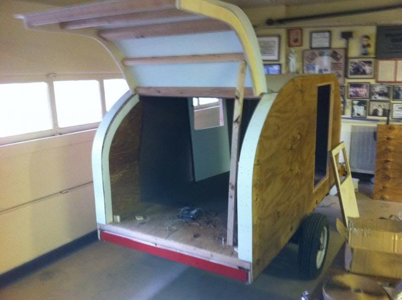

Built and dry fitted the Hatch, did the doors and framed them....tomorrow I'm going to start the siding and roof.

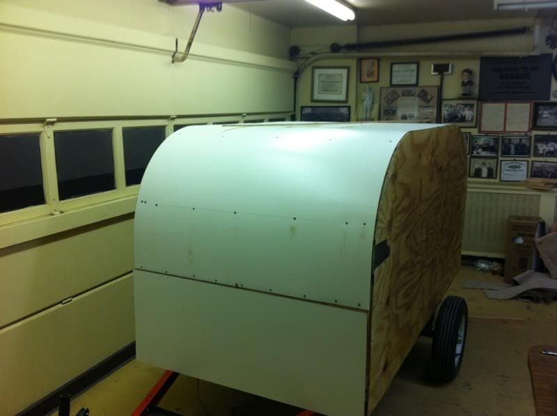

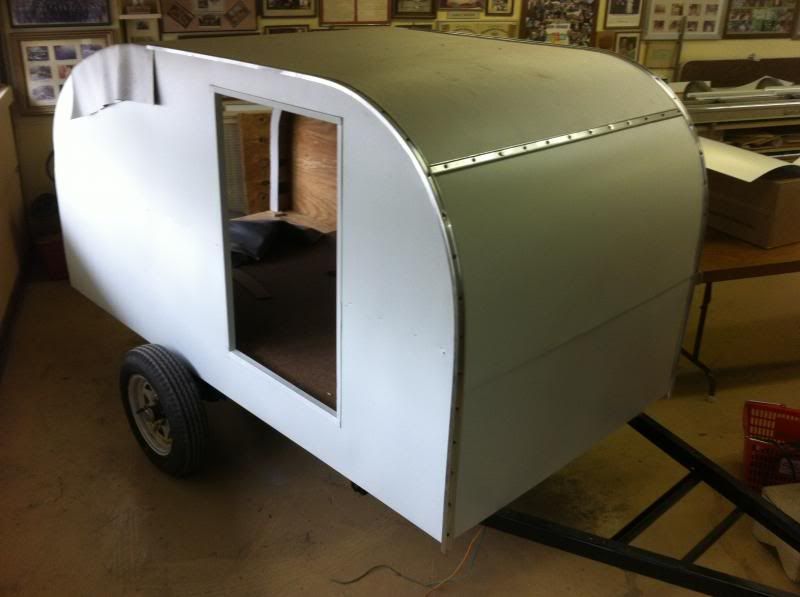

Postby len19070 » Fri Mar 29, 2013 6:14 am

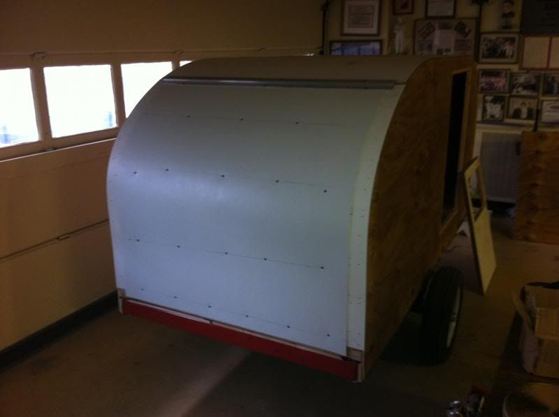

Installed 95% of the siding, laid the rubber roof, trimmed the door openings and started some trim.
I hope to have it weatherized by Sunday.

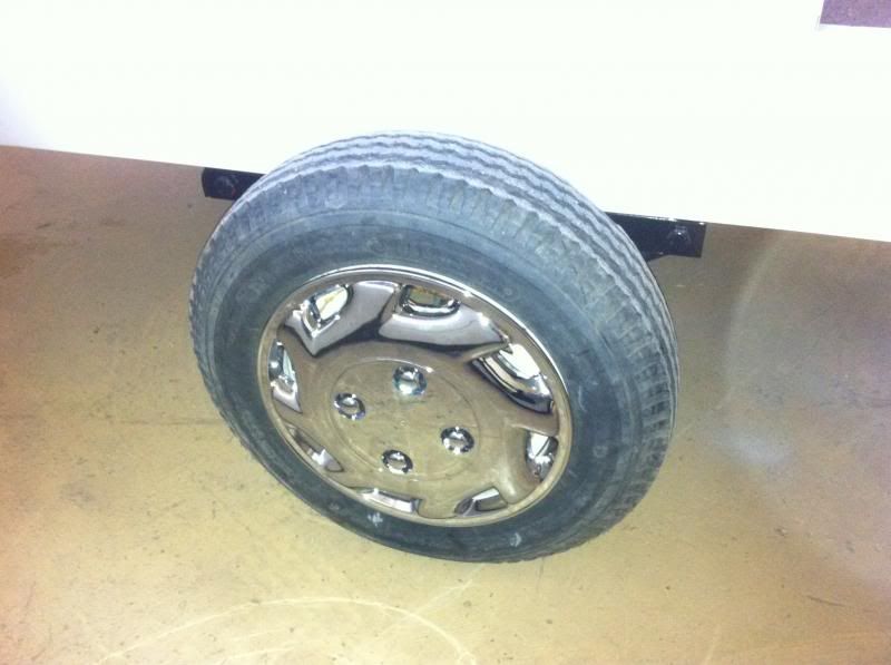

BTW, I found some wheel covers that fit 12" Harbor Freight wheels, there from a Chevy Sprint. The name of the car they will fit is important. If you ask for a wheel cover for a specific Car they will have them....If you ask for a set for a trailer they'll tell you they don't sell wheel covers for trailers!
