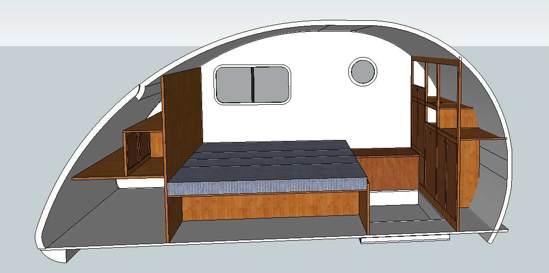

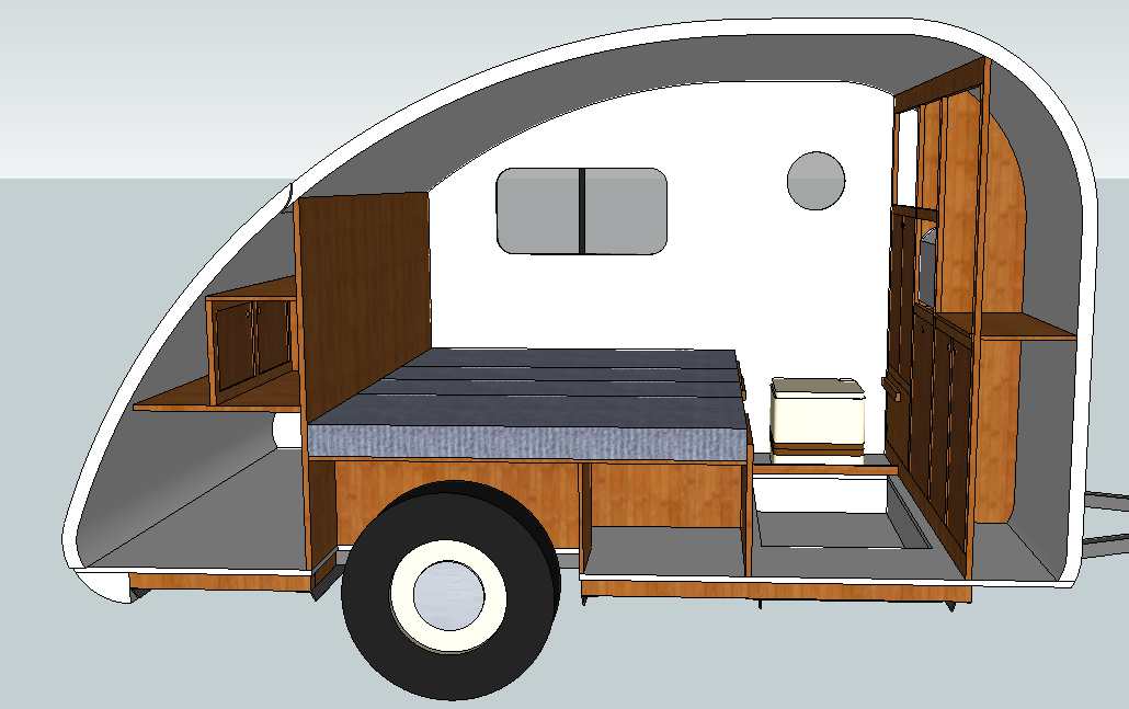

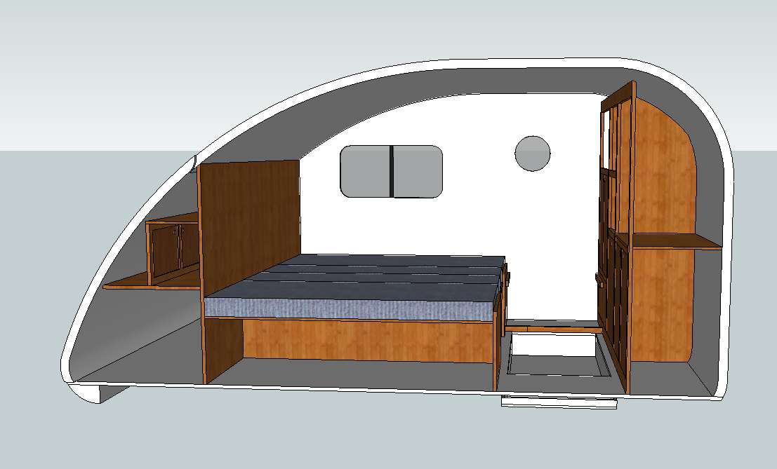

Been playing in sketchup today... I have a lot to learn.
Here is what I started with, Thanks to danlott for the design.
I added 12" to fit a queen size bed, and more storage (=keep wife happy).
I then thought, what the hell, may as well make it an even 12'! I then started playing around with the profile. I like the thought of maximizing room, but I really like the round tear shape, so I came up with this. It does mean slightly less headroom, but I dont plan on standing around much, and a shorter door, but I think it looks sharp.
I am leaning towards the last version. Wife says its up to me (yea, put the pressure on me).

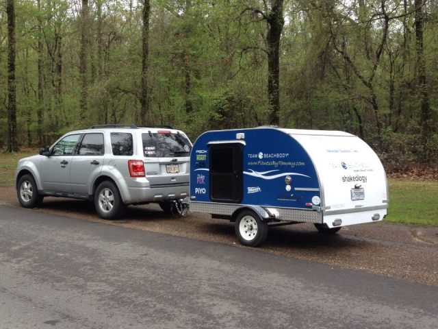

Postby danlott » Sun Mar 24, 2013 12:35 am
I really like the look of the hull liner. Here are some pictures of a another member's trailer.
Dan

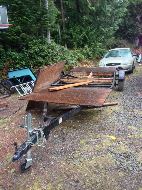

Postby Fyddler » Sun Mar 24, 2013 12:58 am
Well after spending a couple hours and a couple bloody knuckles I got the rest of the old deck off and the axles off. 30 years was not kind to the leaf spring bushings and bolts... Nothing that a sledge hammer, and 2 beers didn't fix.

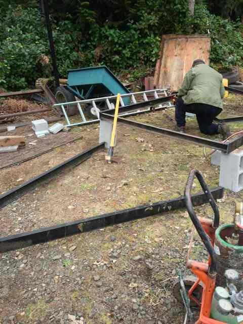

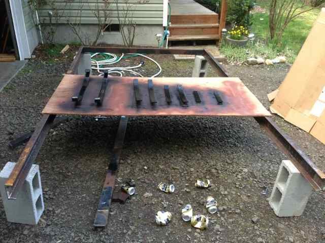

Postby Fyddler » Wed Mar 27, 2013 11:32 pm

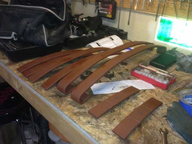

Well we got the trailer cut down this weekend, started to weld it up and ran out of Oxygen. Tore the springs apart and cleaned them up and painting.
(Man this is thirsty work).
Plan on getting O2 Friday, so I can get the trailer welded up this weekend.
