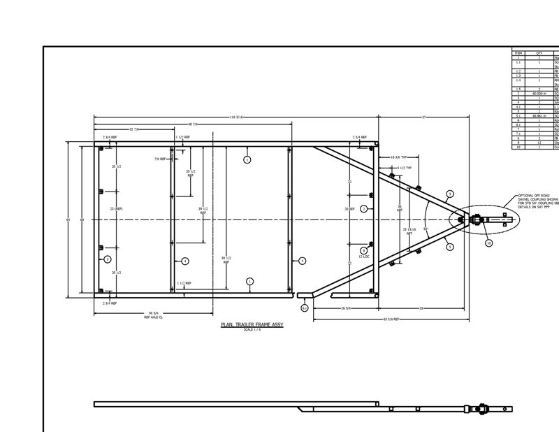

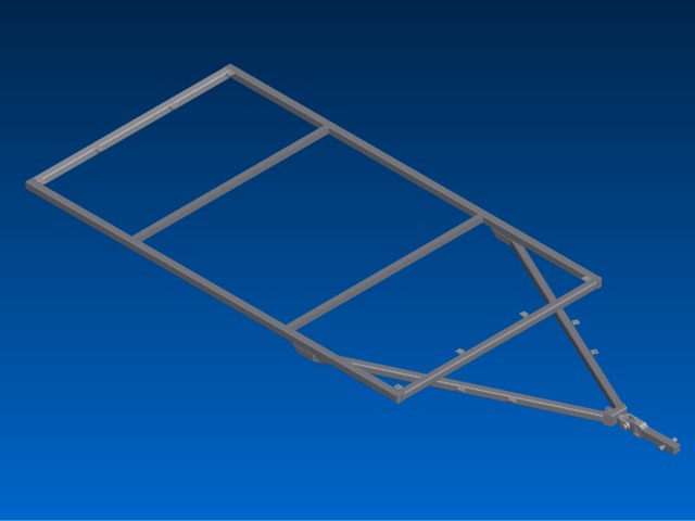

Here is a concept for bed so far, 6 x 12, might be over kill on the support structure?
Tubing size recommendation? I had this set with 2 inch outer rails with 1.5 inner which would be offset down .5 inches to allow the flooring sheets to flush the floor with the outer rail.

Yeah, too much steel.
Think airplane, not tank. The cabin is a big boxy structure that will support itself and the trailer frame.
Another way to look at it is that the front wall and bulkhead of the cabin hold the side walls up, and the side walls act like very deep beams that hold the trailer frame up, so as long as the tongue is attached rigidly, and the front xmbr is stout where the torque from the tongue is applied, then the rest needn't be so rugged.
Consider running your tongue A-frame under the front xmbr and tie it in to the main rails further back; much stronger.
There are lots of good examples of chassis design in the Trailer and Chassis Secrets forum.

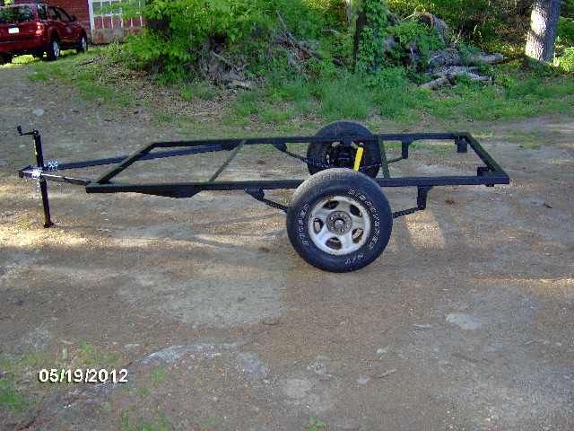

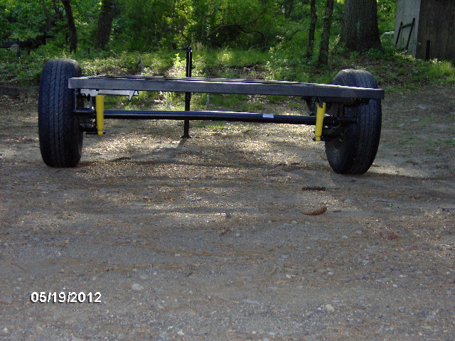

Here's a look at mine, which is still kind of beefy compared to what some people use.
64" W x 9'-8' L plus tongue. The tongue and front xmbr are 2x2x3/16 wall tube; the mains and rear xmbr are 2x2x1/8 tube; and the intermediate xmbrs and tabs are all 1-1/2 x 1-1/2 x 1/8 inch angle steel. There are probably way more details than you can stand to read in my TPCE build thread.

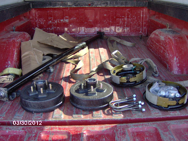

I had seen this up on eBay for an axle but wondered if it would be too light weight for the size I want to build.
http://www.ebay.com/itm/1500-Torsion-Axle-Wheels-Tire-NEW-RV-Trailer-Camper-Tear-Drop-ROCKWELL-AMERICAN-/130864198398?pt=Motors_RV_Trailer_Camper_Parts_Accessories&hash=item1e781d32fe&vxp=mtr
BTW, what is that axle you are using? Looks like the rear end out of my 66 Chevy. I have a couple of those but thought it would be way too heavy. I could also pull the ring gears and leave the pins and C-clips to keep the axles in place then it would be the same width as the van and use the same rims and tires. ;) I could fab my own spring perches and shock mounts. I even have an extra sway bar laying around here somewhere.

No, it's a std. Dexter D35 straight round tube (w/camber…technically not straight); 77-1/2 hub face-to-hub face (a little wider than needed, but is a common stock size, so not special ordered); 5 on 4-1/2 bolt circle w/ 1/2-20 wheel studs (Jeep TJ, early Ford Mustang, etc. pattern); and large electric brakes. The brake backing plates must have thrown you off. Here are a couple more pics.
I went beefy on the 3500 lb. axle, suspension and brakes because of the cross country trip and forest service roads that I intend to travel on. Although the big axle is heavier, it has the bigger spindles and bearings, and the larger brakes. My springs are long and soft Jeep YJ's rears which derate the capacity to about 1500 lbs. I chose the longer/wider springs, and added shocks and bump stops for a smoother ride.
All of the above is probably gross over design for most applications, but since you asked... :D
The deal you linked to seems like a very good one, price wise, but is probably way too narrow for your needs. Unless you are building 4 ft wide (which is seldom recommend for two people), or are at ease sectioning an extension in the center, I would pass on it.
Consider starting with a boat trailer. They usually have lots of adjustment built in, the axles are usually set rearward already, and the long tongues are easy to shorten. The fact that they are usually galvanized can be a plus (rust proofing) or minus if fab work is needed to adapt (toxic fumes when welded).
