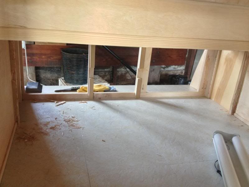

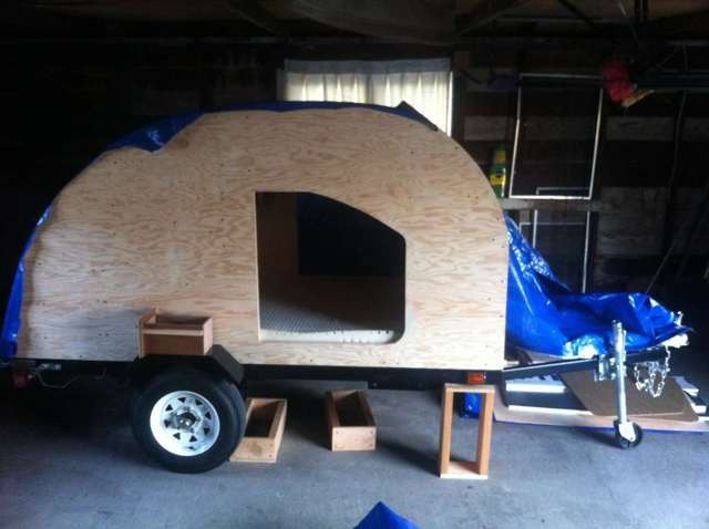

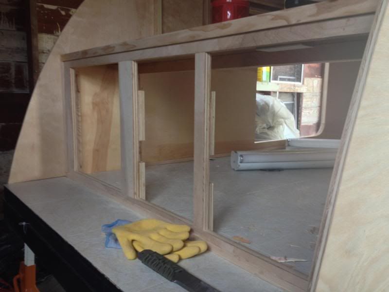

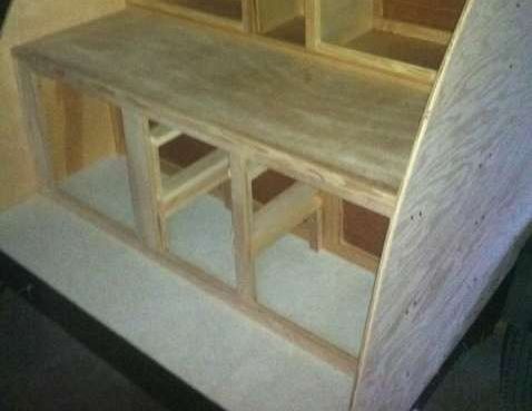

OK, some update stuff here. A few pictures to show how I demo'd out the footboard/bottom cabinets to open up the berth. Now suitable for tall people! I'll miss the storage, though.
BEFORE:
AFTER:

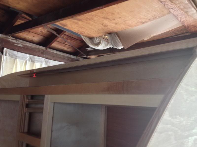

An interesting gap in between the inside 1/8" plywood and the bulkhead between the berth and galley, up top (shown in red). It's about an inch wide - I'll have to fill that somehow.
Next is to insulate and close in the new footboard, finish insulating the body, expanding foam in all the nooks and crannies, polyurethane sealant on everything, THEN - construct the hatch and aluminum skinning! I think I'll put off making the doors until last - seems like the most complicated step.

Postby Junkboy999 » Sun Jun 23, 2013 7:21 pm
Does that gap go all the way across the Galley at top? It might be a place for bugs to access you sleeping area. They will collect on the inside of your hatch if you have lights in the hatch. Closing the hatch down for the night, they have no place to go but in your bed area. But with that said a few people have opening along the top like that on purpose. Your TD can not be air tight when you sleep, or you’ll run out of air.
Junkboy999
Posts: 1259
Images: 52
Location: Wichita, KS
Re: Dan and Dana's Kuffel Creek Partial Build
Postby ddcronk » Mon Jun 24, 2013 12:59 am
Junkboy999 wrote:Does that gap go all the way across the Galley at top? It might be a place for bugs to access you sleeping area. They will collect on the inside of your hatch if you have lights in the hatch. Closing the hatch down for the night, they have no place to go but in your bed area. But with that said a few people have opening along the top like that on purpose. Your TD can not be air tight when you sleep, or you’ll run out of air.
Junkboy, good thought on the bugs. I am definitely closing that gap now!

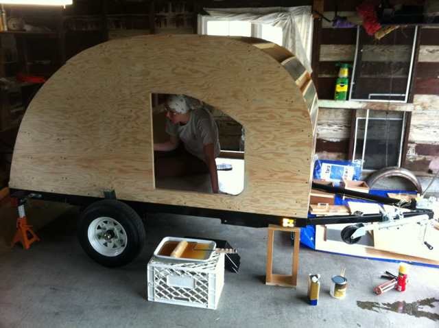

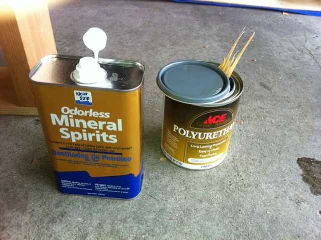

Today Dana and I did some sealing! 50/50 polyurethane sealer and mineral spirits.
Inside and out. No water damage for us.
Best partner a guy could hope for:
I am a blessed man.
