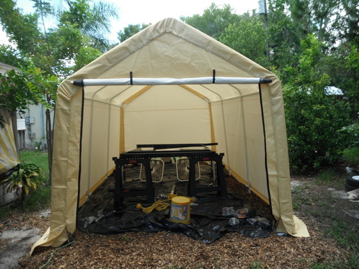

Before I started the build I needed a place to work. My garage is way too small as I will be building it out to 7 x 13.

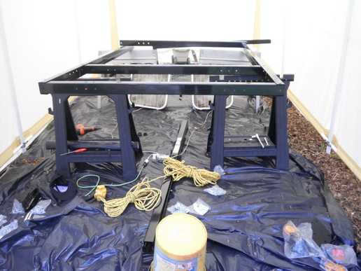

Garage built ( 10 x 17 from HF on sale plus a coupon ). The floor is black plastic on top of mulch. The ground the is low and I would be ankle deep in water if I didn't do that. It has rained over 8 inches since then and all is bone dry. I put 3 florescent fixtures in the roof and it is BRIGHT in there. I started the trailer. I put it together on top of sawhorses so I could save the bending over with my bad back. :frightened:
Only tricky part was the axle but it turned out pretty easy to do. Put a bracket on one side, just use the outer U bolt. Slide the axle in then put on the inside U bolt. Lift it in place and put on other side. I thought I would have to tie it up with rope but I didn't need to.

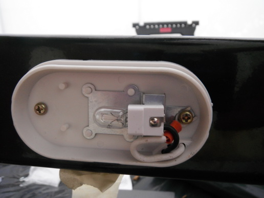

I hate dim lights on trailers due to poor ground and the brake lights would have poor ground so I ran a ground wire to each light and to the wiring harness.
[url][url=http://www.tnttt.com/gallery/image.php?album_id=3081&image_id=109036]Image[/url][/url]
I soldered ( tinned ) the end of the wire, then bent it in a hook shape and put it under the mounting bolt. ( The shiny spot on the right. )
The clearance light I put a terminal on the wire and put it under the mounting screw. Yes I had to drill an extra hole for the wire.

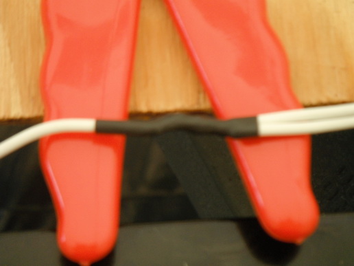

When I had to splice I did a solder job then heat shrink.
I made sure every thing was tight and the frame square then used wood under the jack and raised it a tiny bit to pull out the saw horses. lowered it on some stands then repeated the process till the nose was on the ground. Did the same for the rear... No Lifting which was great for my back.

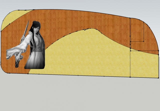

Been working on the design for the skin. General idea is this... I snitched a gallery photo to use. The girl will be in a kimono.. it will be inlay of different woods. the gold coins the dragon has will be gold leaf. ( still a design in progress ).

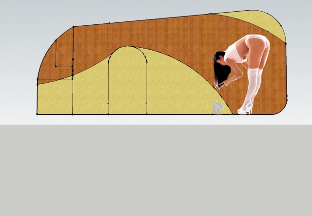

I worked a bit and got a sketch of more my trailer design shape and size. Door in drawing goes to low but the concept is getting there. I also need to add a touch of an curve to the roof line.
Photoman33770

The other side.. both will not be full color but the color of the inlay woods.
