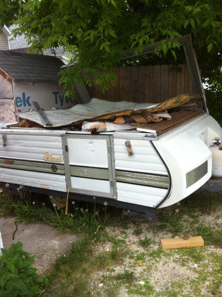

My sister got me a tent trailer for $100. The canvass was shot, the raising mechanism has rusted through and through, so as of today I am tearing it down to create a unique camper. I have many fiberglass insulation panels from work for free, free windows, and the reseated and weatherstripped door from the tent trailer.
I have probably 100 or so profiles I've drawn, ranging from tiny houses to micro tears, I Have it narrowed to my top three we shall see which prevails :thinking:
I will add pics shortly.

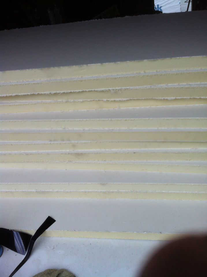

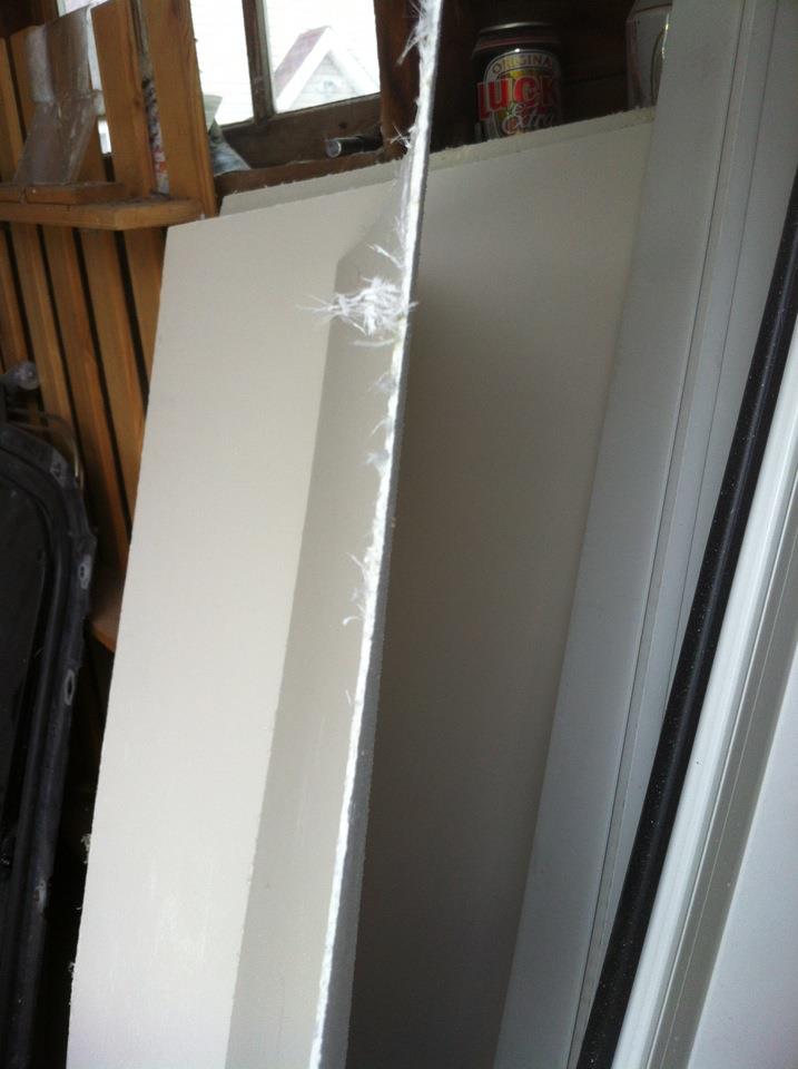

after removing foam insulation, perfect for the radius
fibreglass panel.jpg (54.23 KiB) Viewed 924 times

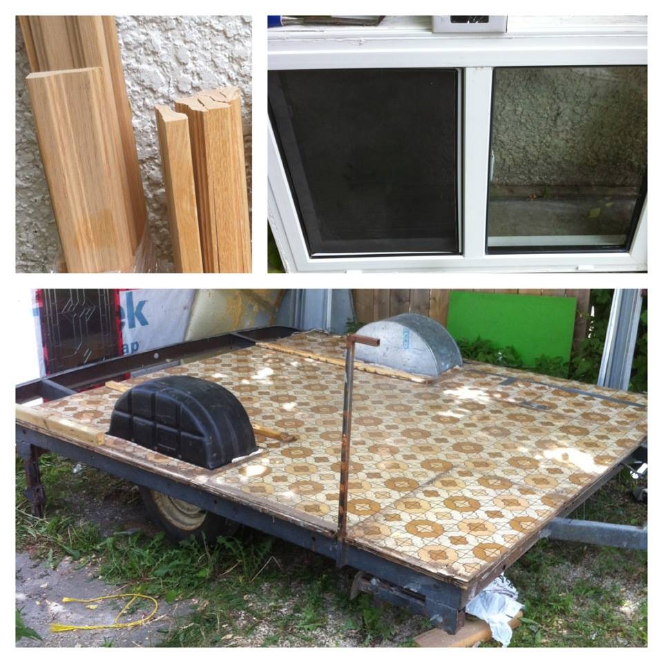

full panels.jpg (52.97 KiB) Viewed 924 times
the $100 trailer, 82 inches long, 78.75 inches wide.

Postby ssj4jarrod » Sun Jul 07, 2013 4:02 pm

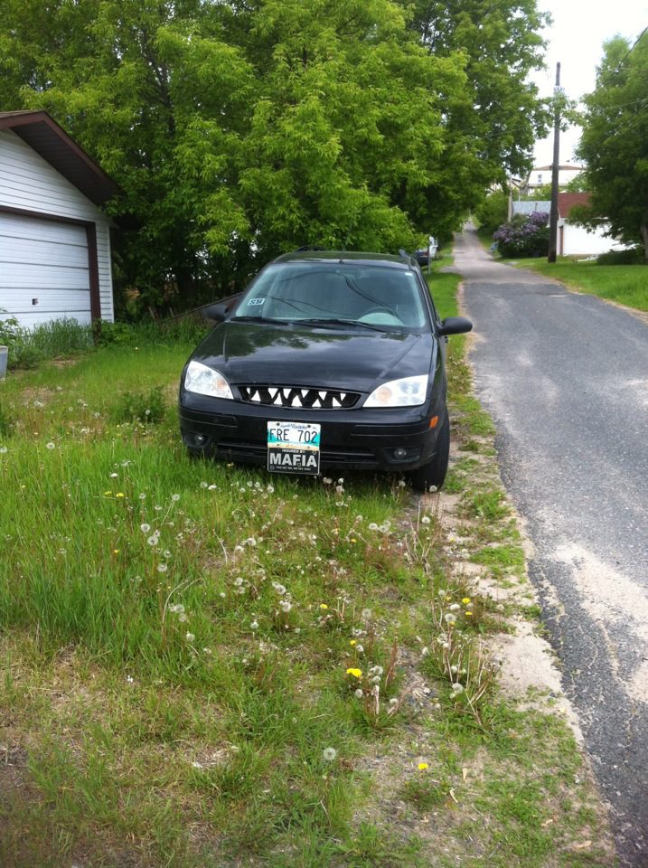

This is my tow vehicle, She is a 2005 Ford Focus 5-spd wagon. I added some teeth for effect
tow vehicle.jpg (177.88 KiB) Viewed 894 times
Here is todays progress. stripped, all lights and pieces for reuse put away.
Tomorrow I am going to pick up my cleats, and plywood. The floor was not as bad as I was thinking, I will be able to save it. If you haven't noticed this is going to be a budget build. here in Canada we have a surplus supply store where I will be able top acquire many great deals.

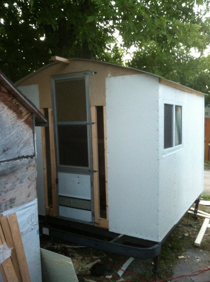

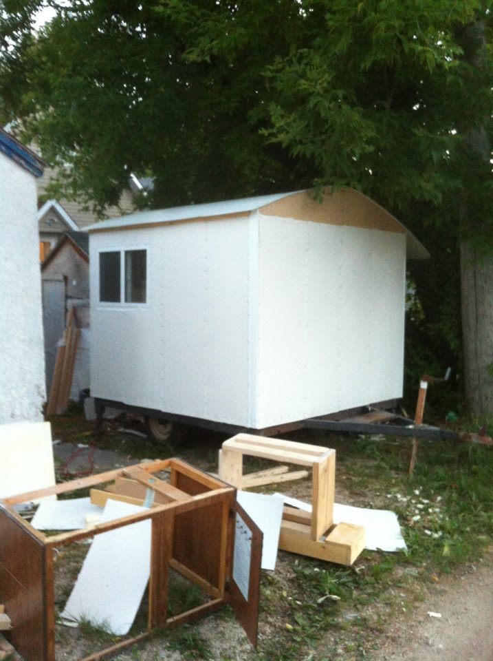

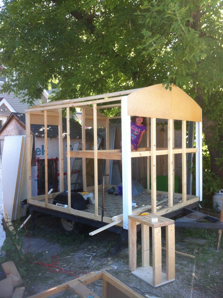

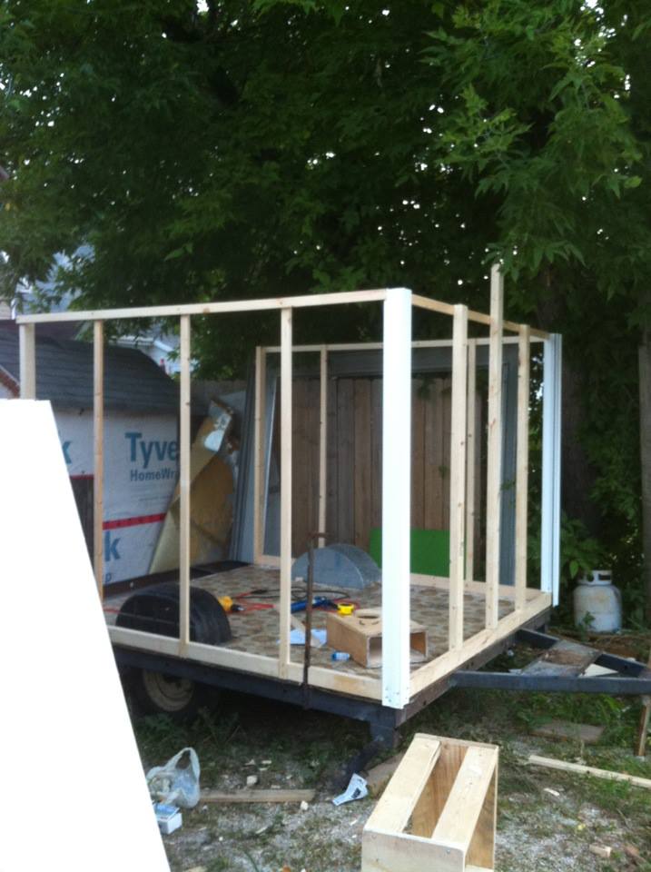

Postby ssj4jarrod » Wed Jul 24, 2013 7:33 pm

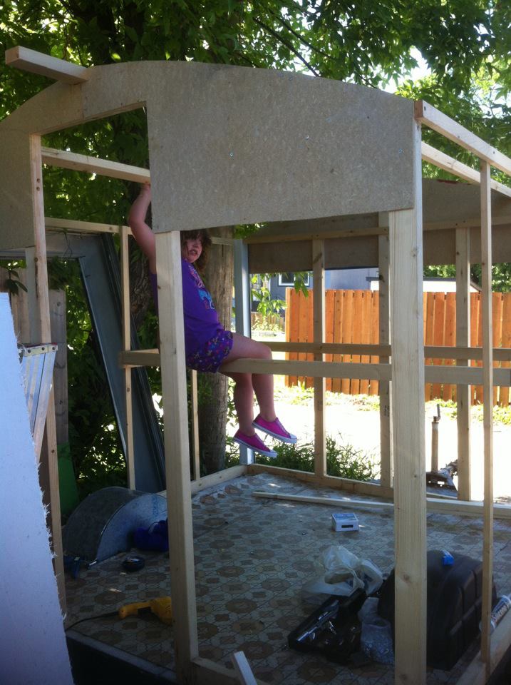

basic structure..jpg (78.04 KiB) Viewed 794 times
more progress.jpg (110.35 KiB) Viewed 794 times
Sorry for the delay in posting, I am a tad tardy on the keeping up with posts and pictures. I was able to make her campable for the 17th, it pourerd in northern Minnesota and it held up quite well, no leaks!

Postby ssj4jarrod » Wed Jul 24, 2013 7:39 pm
I am going to epoxy the seams and figure what to side her with, she has twin bunks, foam matresses, the walls i covered with sheets for now, just to hide the studs :R
I have a few more windows to place, and do up some cabinetry, then side and paint it.

Postby ssj4jarrod » Wed Jul 24, 2013 9:42 pm
I as well need to put a curve or a V on the front, the journey used a fair amount of gas. She weighs in at 520 lbs at the moment, unladen. It pulls beautifully, tracks well and doesn't sway in wind. There is a few internal floor to roof braces not shown just yet in these pics :(
I am considering dropping the trailer frame a few inches, perhaps flipping the axel to lower it some... My Focus pulls it quite well, just the flat wind wall hampers my mpg. And prevents me from utilizing fifth gear. I can not wait to start adding to her, I am considering adding a 12V deep cycle for a bit of lights and cell charging. And to off set what I plan to do to the outside, a small porch with a small bench on either side of the door and extend the roof back about 2ft. I will put up more pics soon ;)
