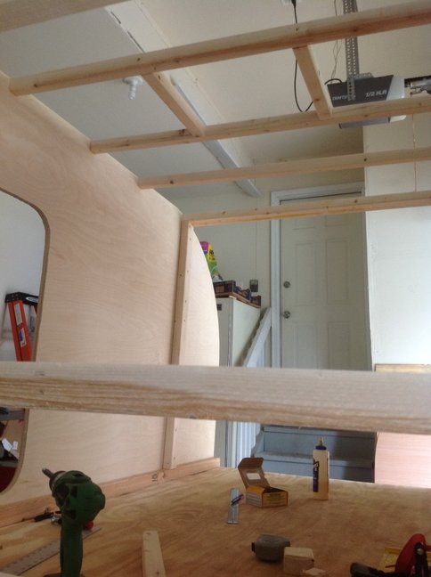

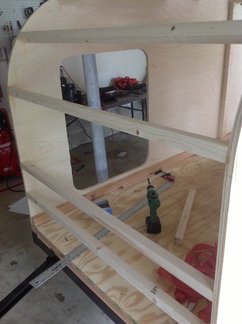

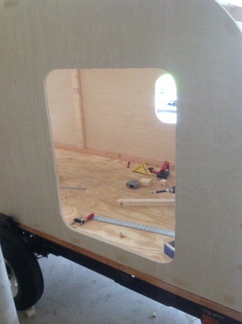

Just wanted to share details of my build with the community and solicit some feedback.
General Details.
the profile has a 18 inch front radius and 28 inch back radius.
3/4" home depot birch plywood.
windows and doors will be from vintek
I plan to skin it with aluminum after applying spar varnish to the entire trailer (inside and out).
1/2 insulation
3/4 inch plywood for the floor, coated with asphalt
HF Heavy Duty Trailer
5mm underlayment ply on the inside walls
still looking for 1/8 birth for the room, but not able to find some. Do you think the 5mm will work if I cut some lines in it and steam it?
