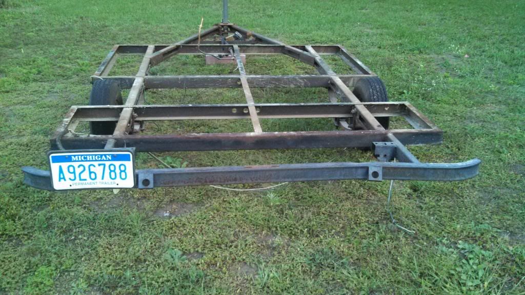

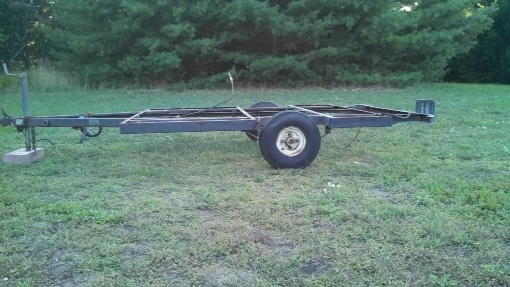

This the profile of the trailer frame. Do any of you have thoughts as to whether the axle needs to be moved back for a classic teardrop look?
The trailer measures 52 1/2" to the outside of the main rails (minus the outriggers), an I think the box is 84" long.

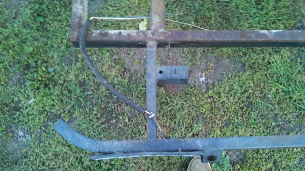

I was hoping to use the frame for the bumper as support for the tear, but the frame rails are outside of the main frame.

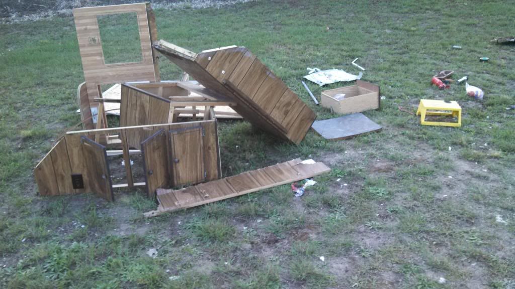

The cabinets.
The roof, walls and other junk from the trailer. It looks like someone has some cleaning up to do to keep the wife happy.

Save those outriggers and build out wider. Go 5 wide. There's a thread here somewhere where the question was asked, what would you do differently on your build. The majority of the answers were that they would have done 5 wide instead of 4.
That way you can keep the bumper if you like.
On the other hand, with the bumper removed the axle placement looks good. Does the 82 inch length include the bumper or not?

As to saving the outriggers, I like the look of outboard fenders and I'm hoping for a minimalist approach. I'm also not locked into a specific plan yet. Even without the outriggers I'm at 52 inches to the frame rails, so either way I will be at over 4 foot.
The 82" measurement is the outside of the box without the bumper extension. I'm also not sure if I remember that measurement right. I know I'm short a few inches of a full 8', but that should be no problem to overhang a bit. I'm considering pushing forward more than rearward to keep the tires toward the back.
