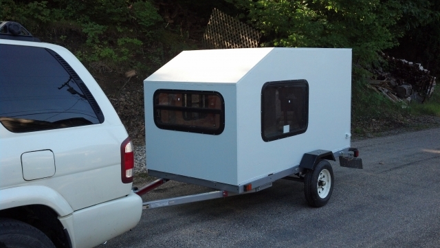

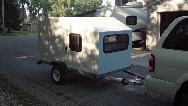

Well, here it is. Not many build shots, knocked it out in 4 days. I got a great deal on a new HF 1720lb trailer off Craigslist that had never been on the road. 6 sheets of 3/4 exterior plywood, some 2x4 to rip in half, urethane for the bottom, paint for the top, used windows from a local RV dealer, misc screws, braces, glue, caulk, hinges and latches. I'm at about $500 including the trailer at $225. Oh - Silver Sword because that's the color of the paint, looks like white or grey to me.

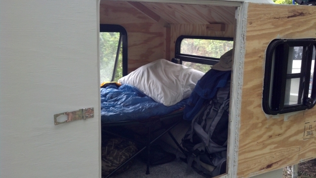

First Pull LH Side
RH side

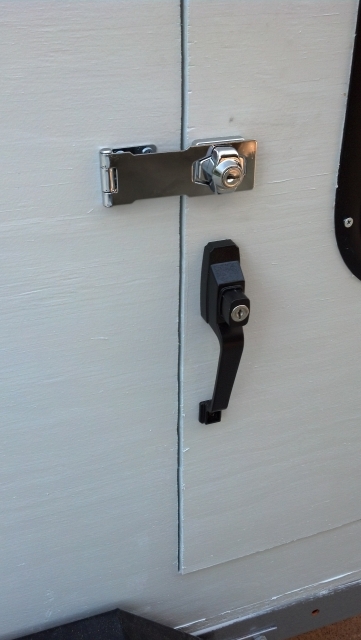

As soon as I pulled away the door popped open, quick trip to the hardware and problem solved.

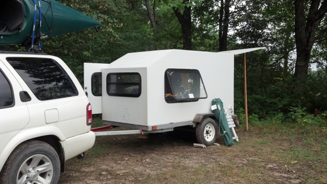

First camp

Wow, That looks great !
4 days !? :applause:

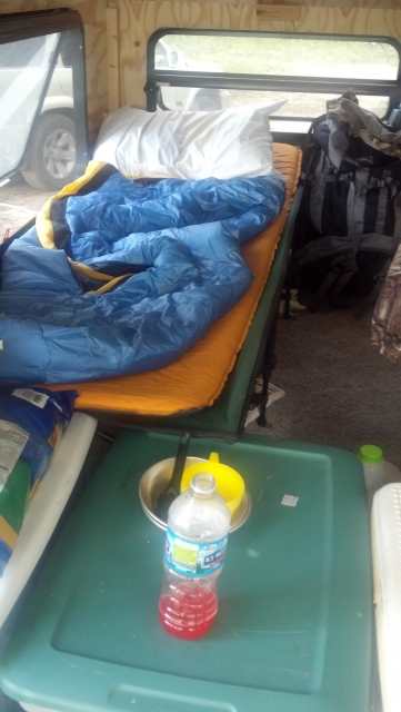

I have since replaced the cot with a platform as I did not find the cot very comfortable. It was also too high. Built the platform 8" off the floor so I still have storage underneath and I also hinged it on the wall side for more access.

Yes, my neighbors were amazed. I live on the start of a little private road so they were driving by watching it come together. I was going at it pretty hard, no time for pics. My thought is to slap it together and then tweak it. It it falls apart in a couple years so be it I'll build another. Better to have it not so great but use it. I'm pretty happy so far.

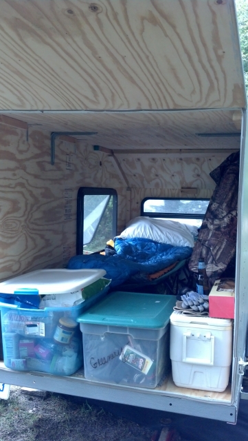

Postby Cantputt » Thu Sep 19, 2013 9:20 am
Through the hatch images. I have now built a low shelf under the totes and a sliding shelf above them. I didn't want my "galley" separate. I will use this in the winter so coffee while still in my sleeping bag is a must.

Whose windows did you use, what sizes are they?

Thanks clermont cubby. Windows were used from a local RV dealer. $30 ea. No idea on brand. Front window is like 18 x 36(going to get a stone cover). I think the one in the door is 18 x 18 and the other side is standard egress window 24 x 36? Didn't come with inner trim rings. I just used butyl tape, drilled and screwed. Sealed up well. Great ventilation, I can have them all open in the rain.
