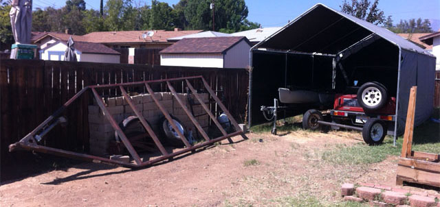

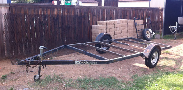

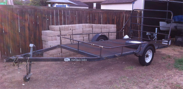

Hi, I am Jim and I joined Sept. 8, 2013. I have begun to build a Teardrop based on the Benroy design. I have downloaded, printed and gone through the "Generic Benroy Plans created by Mike Schneider. I purchased this trailer in August.
Here is the trailer after some chopping.
Here is the trailer today.

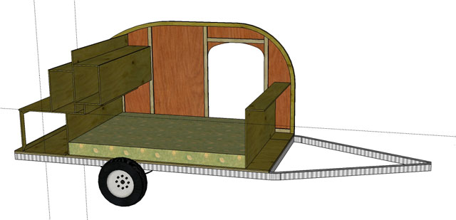

This is a look at my beginning design using google.sketchup
I have been tweaking it for the past 2 weeks and probably will be tweaking it till it is finished. I am trying to stick with a 5x10 floor plan and a 5' wall height. I am 6' 4" and would like the extra head room. It looks like I will be cutting 6" to 12" off the back of the trailer to get the trailer balance right. This will allow me to move the door back a few inches for ease of entry which was recommended by citylights. The tongue is over 5' long so I can still fit a 10' long TD on it.

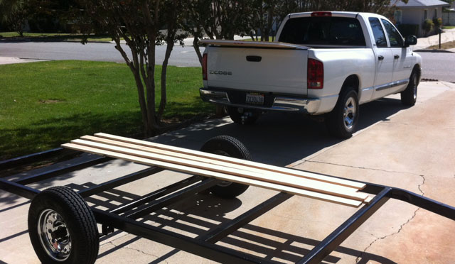

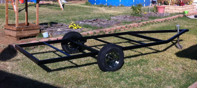

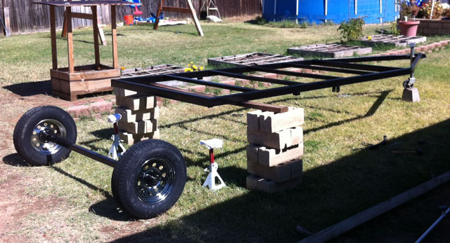

Postby jimun » Sat Oct 12, 2013 9:14 am
Trailer stripped and painted, new bearings greased and installed, new chrome rims, and new tires.
Springs and axle painted and installed and now ready to start the teardrop floor.
I might still have to adjust the axle location. the bed is 5x10 and it has a 5' tongue that will have a storage area and storage box.

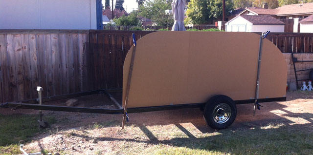

Postby jimun » Sat Oct 12, 2013 5:26 pm
Here is a possible template on the trailer. I decided to go only 4' high, 5' was making it to big and I want to keep a lower profile. Also with 4 x 8 sheets there would be less splicing to be done on the walls. Now I have to redo my Sketchup design.

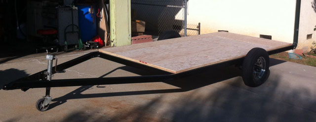

Postby jimun » Sun Oct 13, 2013 11:11 pm
Got the 1x4 and 1/2" plywood for the floor an then made some sawdust.
Floor is built. Not perfect but nothing a little putty and sanding wont fix.
I bought a Kreg jig and tried it with splicing the 1/2" plywood. The 1/2" ply I got at HD did not hold the screws well. I had to glue and screw the 1x4 on to hold the splicing together. I don't know if the 1/2 ply is just to thin for it. I believe I seen where others used it on 3/4 with no problems.
Now I need to sand and seal the floor and then roof tar the bottom and attach the insulation.
