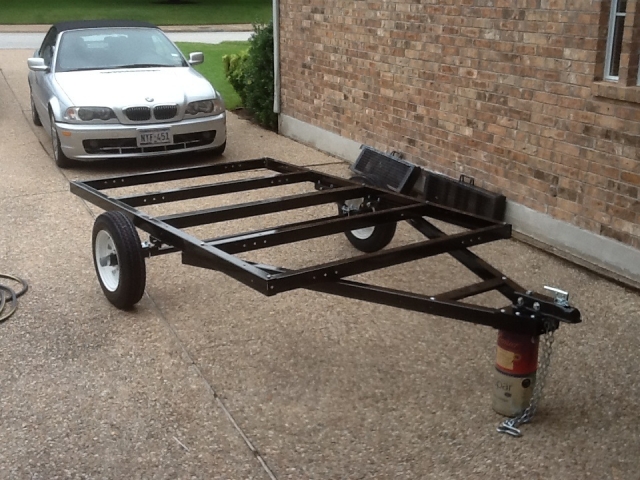

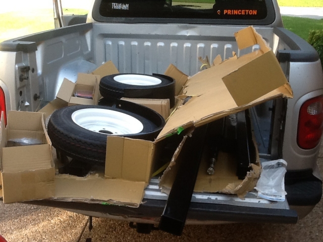

I ordered my trailer from Northern Tool in late August and it arrived in two large boxes; both of which were pretty beat up from shipping from Asia. I picked it up at the local store and here it is in my truck. I also picked up wood for the floor and some other building materials about the same time.

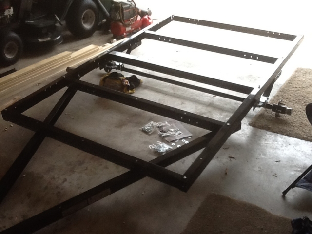

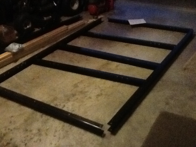

After a few weeks of getting my act together I started the trailer assembly last week. Here are some pictures of that process. Since I have a pick-up I am not going to use the trailer to haul wood in for the build so I did not put on the fenders or lights.

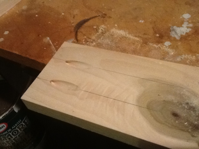

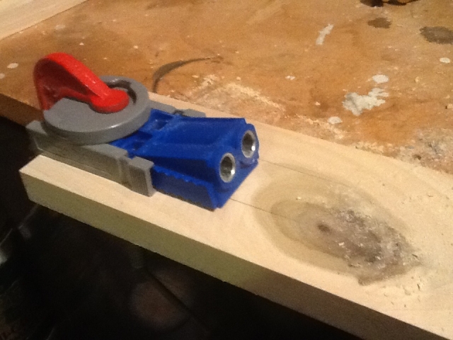

After I got the trailer together and squared up I started to cut the poplar 1X4's for the flooring frame yesterday. Before I assemble the pieces I needed to get some idea of how to use a pocket screw jig since I never had used pocket screws or a pocket screw jig before. I used some scraps to see how that process worked. Here is the first pocket screw joint I made using the jig. It seemed like a very straight forward process.

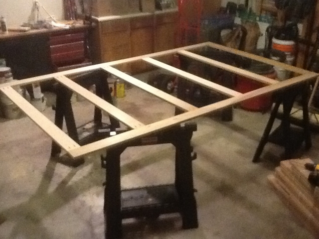

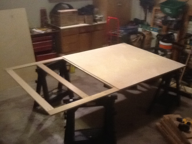

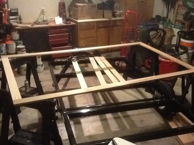

Tonight I started to assemble the floor frame. No problems encountered! Again, I am just following Ryan's Wyoming Woody design and build.

Finished the deck cross supports and dry fit the 5'x5'x1/4" birch plywood. I am planning on ordering the doors, window, vent and some other hardware tomorrow.

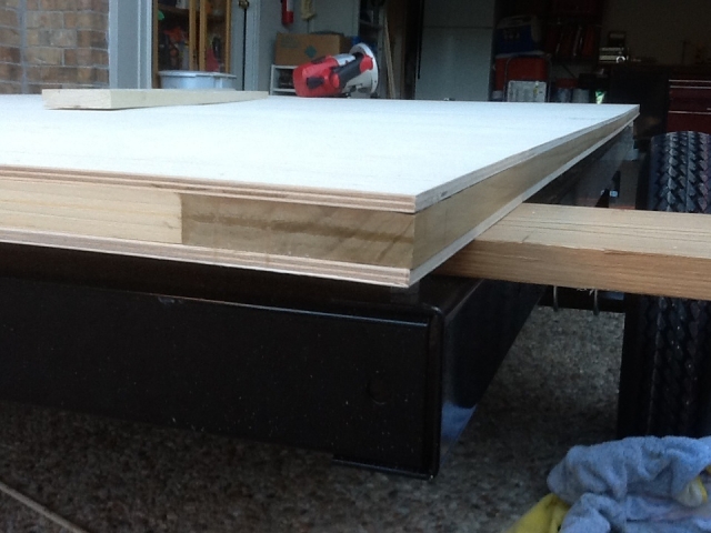

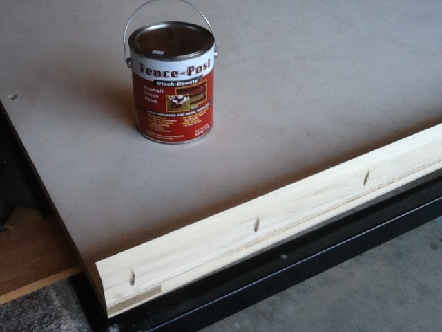

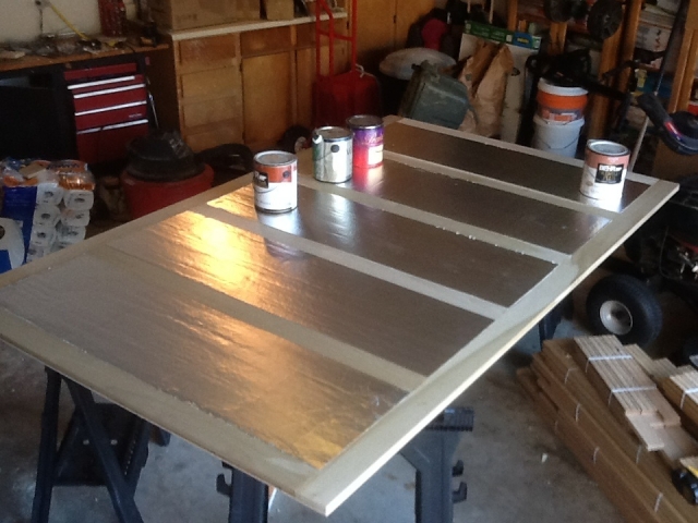

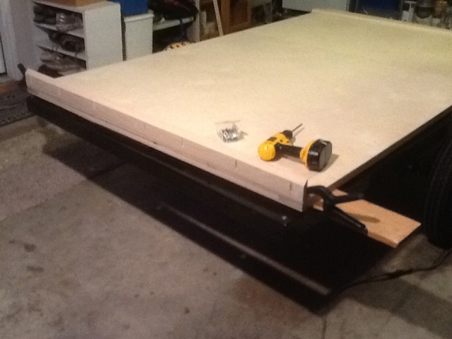

I was able to get the flooring deck put together with my wife in Japan and Korea on business. The deck assembly was very smooth and was just like what Ryan in the Wyoming Woody build thread had shown and described. First's for me on this part of the build was using a flush trim router bit and pocket screws.
The next step will be to seal it and this is where I have to deviate from Ryan's build of Wyoming. I can not find the Henry's sealer anyplace including big box or local stores. I did some research in the tntt forums and found that some people have had good things to say about Black Beauty Fence Post Asphalt paint. That is the sealant that I will be applying to the underside tomorrow.

Postby _Ryan_ » Thu Oct 10, 2013 1:03 pm
Bob,
Looking good! :thumbsup:
One thing I noticed as I was completing my build was that that there was a gap ( about 1/8" ) between the underside deck and the crossmembers of the Northern Tool trailer. This gap was the result of the way the cross members were attached to the inside of the side rails on the trailer.
It wasn't a big deal, but it did creak a bit when I jumped onto the deck. I solved this issue by inserting a few felt bumpers ( the kind for the feet of chairs to protect hardwood floors). You might think about installing a couple rubber pads or some type of window flashing over the trailer cross members before permanently attaching the deck.
Cheers,
Ryan
