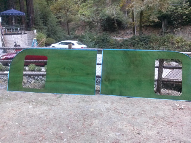

Postby dbuettner » Mon Oct 07, 2013 8:43 pm
here are a couple pictures of the trailer and the two sides dyed 8) 8)
113189113188113187

Postby dbuettner » Mon Oct 14, 2013 9:28 pm
CAM00014 - Copy.jpg (134.82 KiB) Viewed 3368 times
Well the sides are epoxied. the finish came out good. However on the last coat some spots seemed to reject the epoxy. seems some particles got on the 2nd coat. I should be able to sand them out.

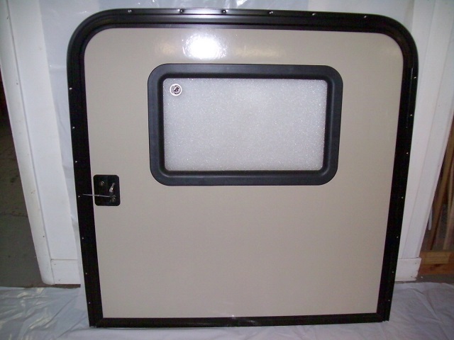

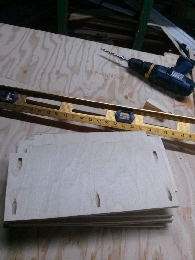

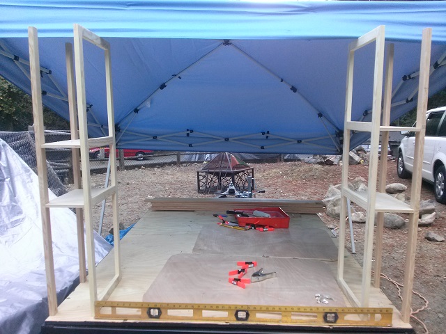

Here is a couple pictures of the shelves that go on each side of the 43x43 door.
I'll also attach a pic of the door.

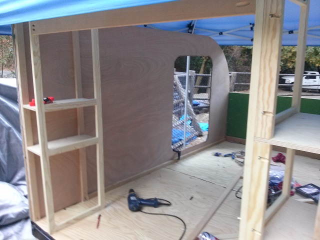

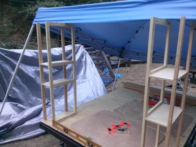

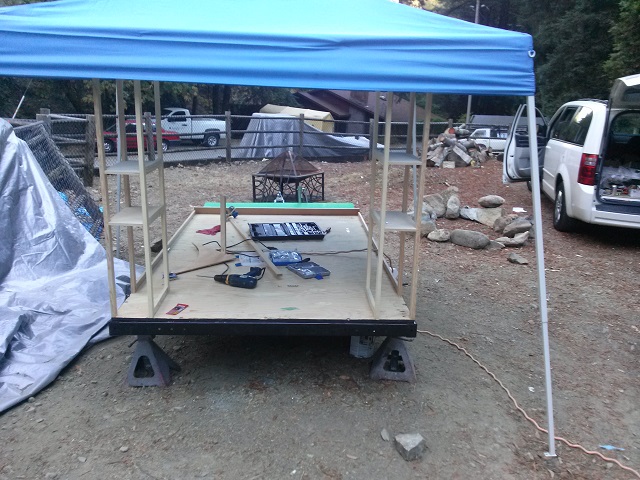

Postby dbuettner » Mon Oct 21, 2013 12:38 am

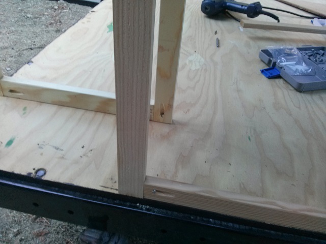

I made some progress this week, are some new picks
Im working on the corner cabinets as they will help support the sides during assemblely
I went with a ply floor and will use the side trim to help attach the sides
CAM00028 (1).jpg (83.67 KiB) Viewed 3207 times

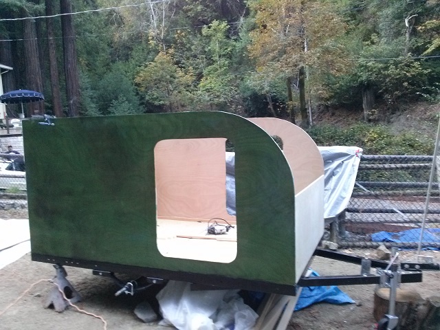

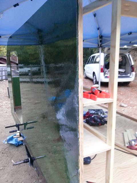

Postby dbuettner » Mon Oct 21, 2013 12:44 am
I screwed and glues the trim in place and now its time for the sides to go up. I used the roof tar on the bottom and inside edge of the sides and glued and screwed to the trim and cabinets as well as some black calking to seal the seams.
and the second panel is up.
inside of panel

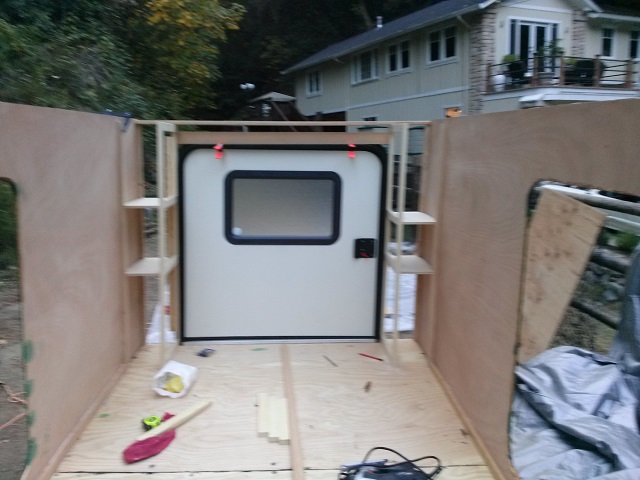

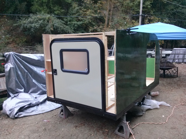

Postby dbuettner » Mon Oct 21, 2013 12:48 am
I wanted to test the fit of the rear door so I could get an idea of the fit. the door needs to be attached just right so it doesn't sag.
rear door from the inside
rear door from the outside
