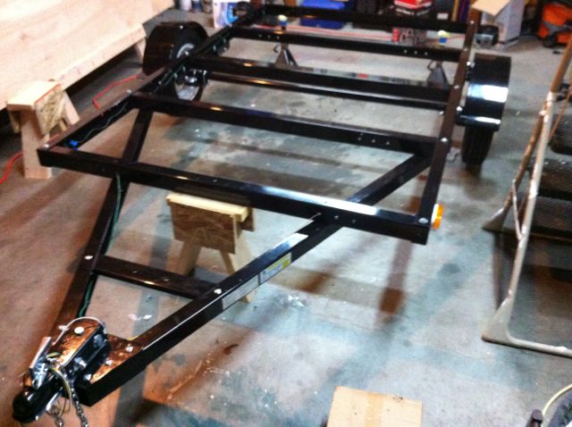

Postby Dave V » Sun Oct 13, 2013 10:55 pm
Let's try attaching the picture file....
The frame came together easily. It seems to have a lot of give to it and I got nervous about bolt together vs welding...

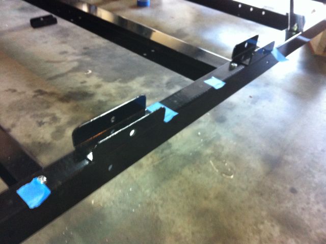

Postby Dave V » Sun Oct 13, 2013 11:00 pm
Then I flipped the frame and made some measurements to move the axle back.
about 12 inches made for some nice even spacing and made room for the doors...
The frame drilled easy.

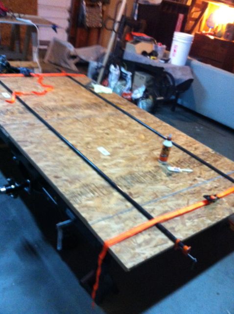

Postby Dave V » Sun Oct 13, 2013 11:21 pm
Using t&g subflooring, 1/2 inch thick. strong and will glue together nicely.
It's actually 3 sections of floor because of the 5x9 dimension. I put the seams over center of cross braces and made sure the tail end had enough support.
A couple of straps and pipe clamps held it tight while the glue set.
