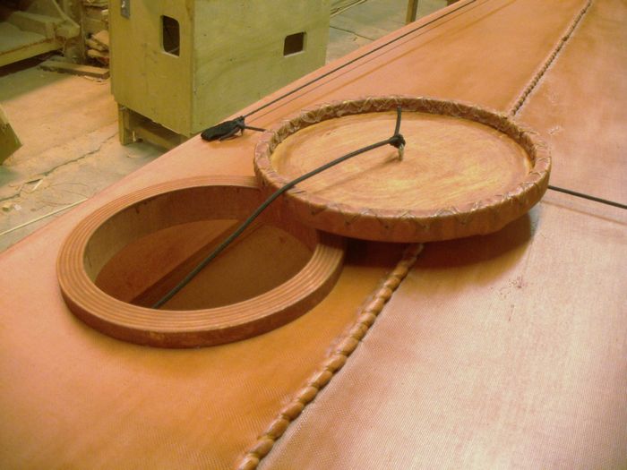

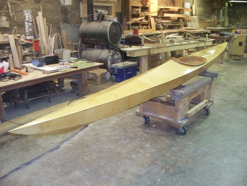

Baltic Birch is an awesome plywood.....here is a17' 6'' kayak I built using 1/8''...
And western red cedar is going to be used for cabinets, trim, etc...

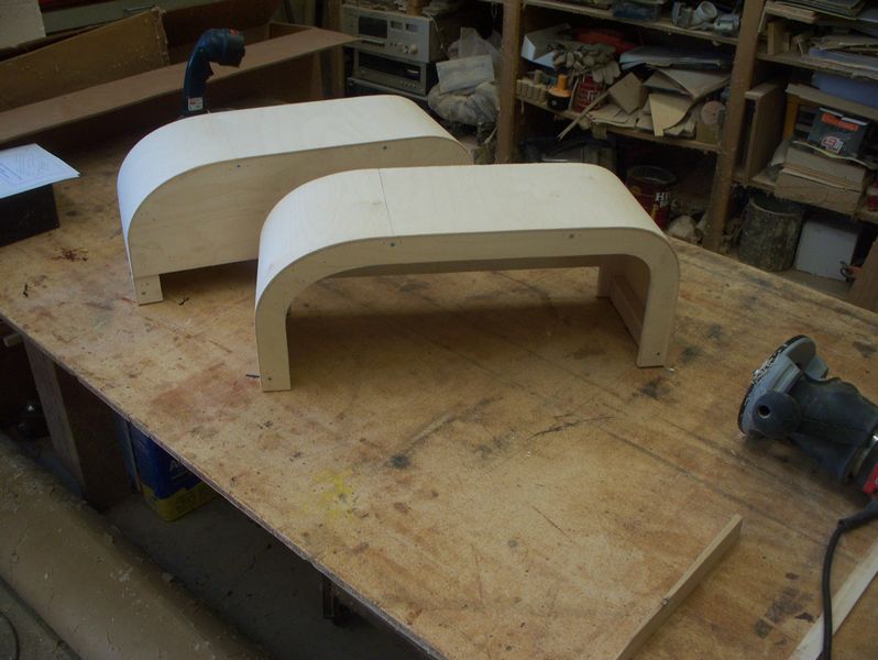

Nice job on the fenders looks like you have a real feel for plywood and what it will do.
Ron

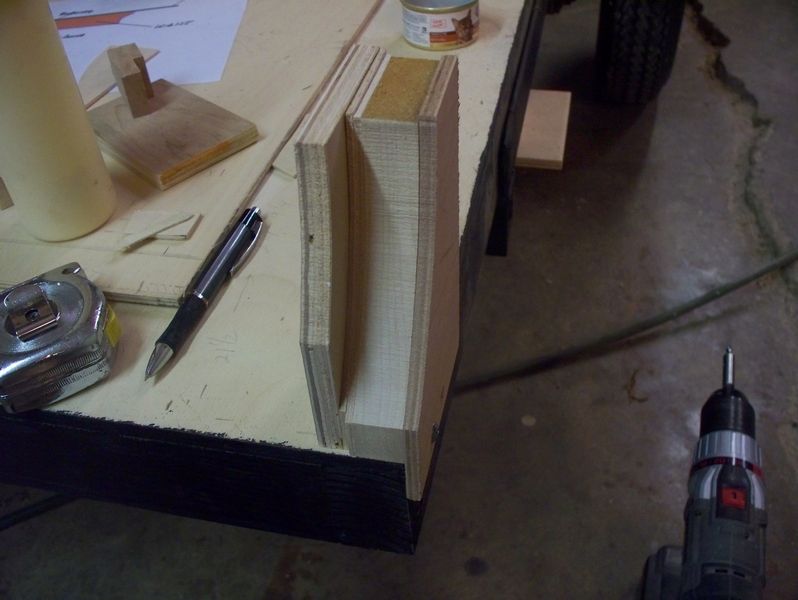

Postby oakinteriors1 » Fri Nov 01, 2013 6:06 am
The tight radius on the fender was traced around a gallon paint can....
I have gotten strips of this 1/8'' Baltic Birch to bend tighter with the aid of a heat gun...

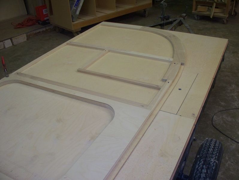

Postby oakinteriors1 » Sun Nov 03, 2013 8:27 pm
More progress this weekend....

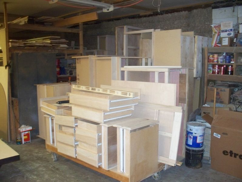

Postby oakinteriors1 » Mon Nov 04, 2013 5:18 pm
The lumber used for the framing is silver leaf maple...from the 500 board foot I purchased for a cabinet job I just finished...I just separated out the lightweight ones.....
Got this job installed last week now plenty of room and time to work on the trailer...

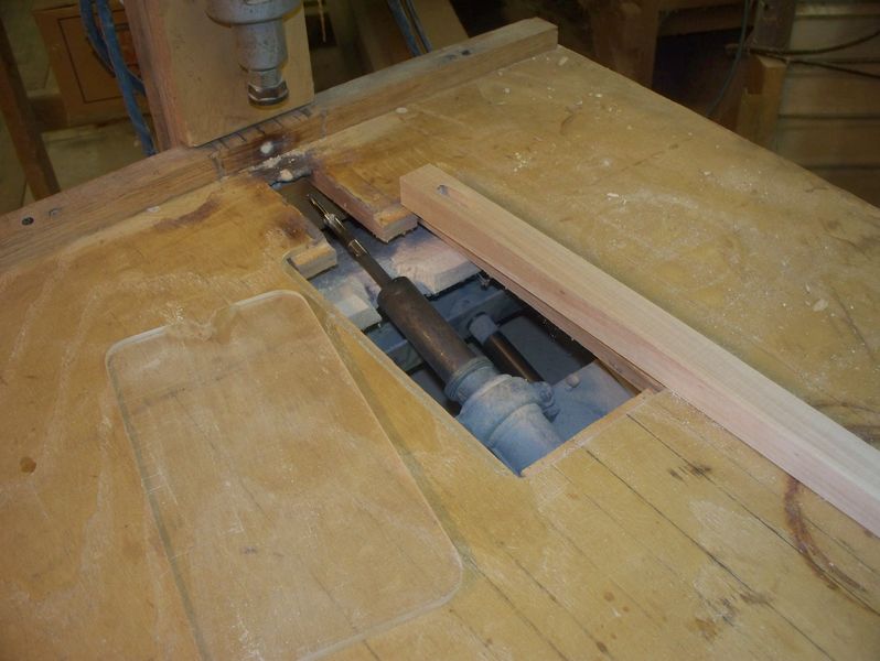

This is a pocket hole boring machine I built over 20 years ago for making face frames...

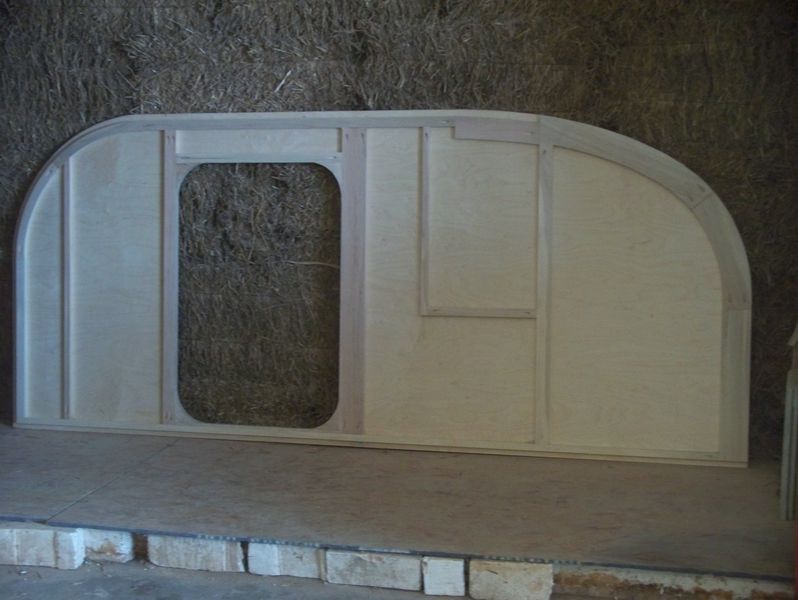

The outer skin on the sides is 1/4'' Baltic birch the inner skin is 1/8''..The galley hatch and roof skin construction will be similar to Steve Frederick's style....
A hatch- side wall mock-up...
Doors framed in and ready for the flush RV style handles...Need to frame in for the windows I intend on making...

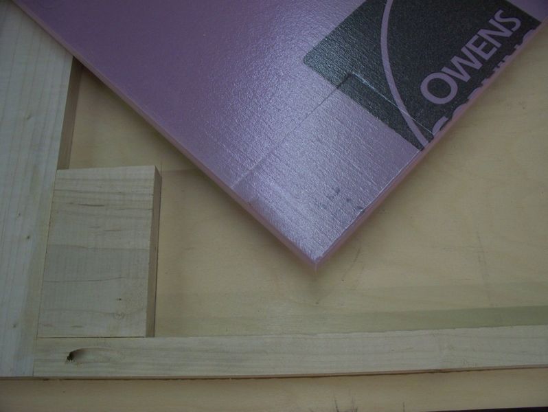

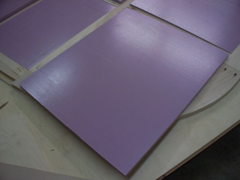

Postby oakinteriors1 » Wed Nov 06, 2013 10:26 am

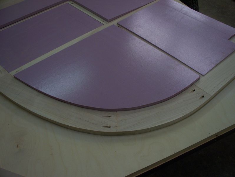

Wile adding foam to the walls I noticed all you had to do was press firmly on the area that has to be trimmed off and it leave an imprint on the backside (with the plastic on)...
No reason to use scribing pencil jigs.. Just press the foam down and cut around the impression...

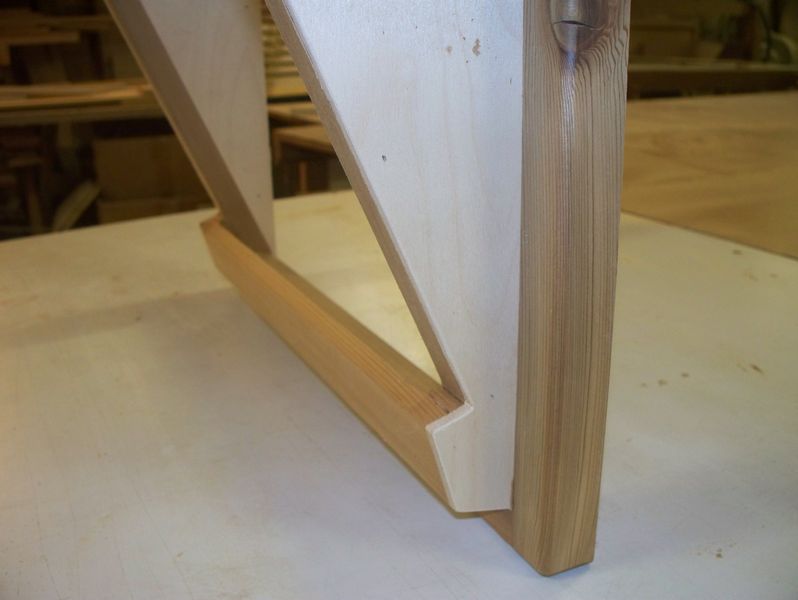

Postby oakinteriors1 » Wed Nov 06, 2013 10:34 am

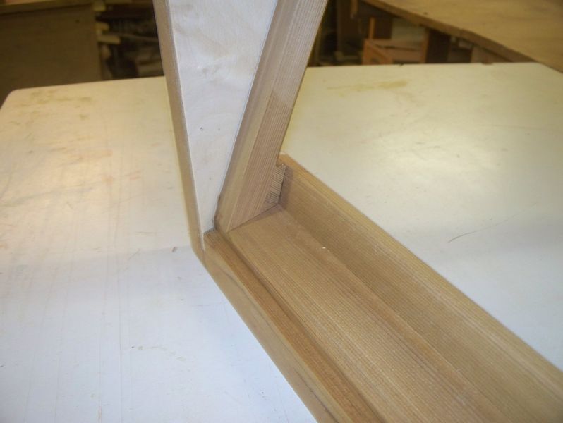

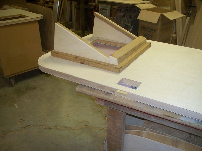

Working on Wiley Windows...I wanted to be able to raise the window a little with it still pressed against the outer wall...A wood pc. attached to the top of the plexi with a dowel pin that fits into a hole in the door skin will keep it from sliding back down..
The sill is angled 30 deg. and ought to allow the window to be raised an inch and a half and keep rain out..
