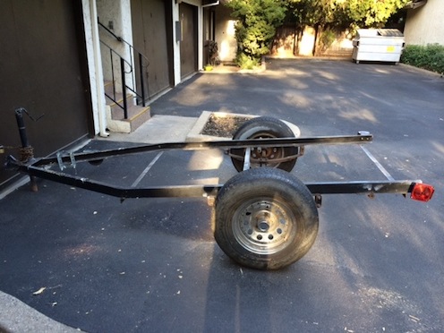

Hello all!

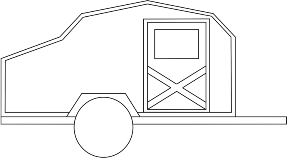

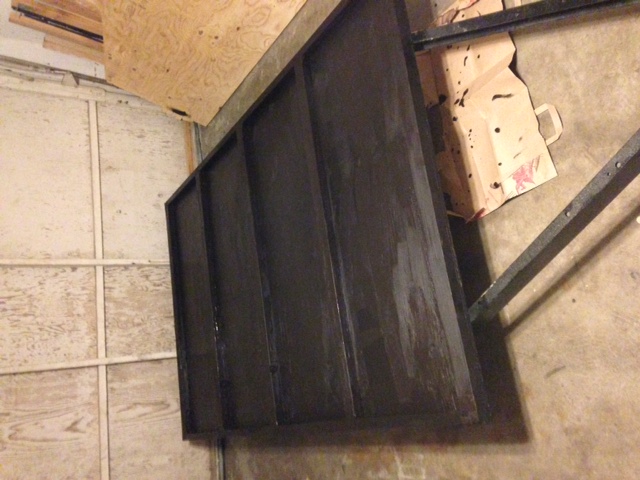

I have been planning my build for quite some time and have been using this forum for ideas. So far I have purchased my trailer (craigslist), and built the floor. I was planning on using a harbor freight trailer but I came across this one with full sized wheels and snagged it up. I am currently in the middle of widening my 4 ft axle an extra 15 inches. My plan is based on a barn that my grandparents once had. More to come.

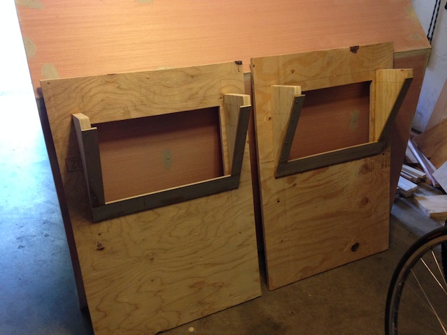

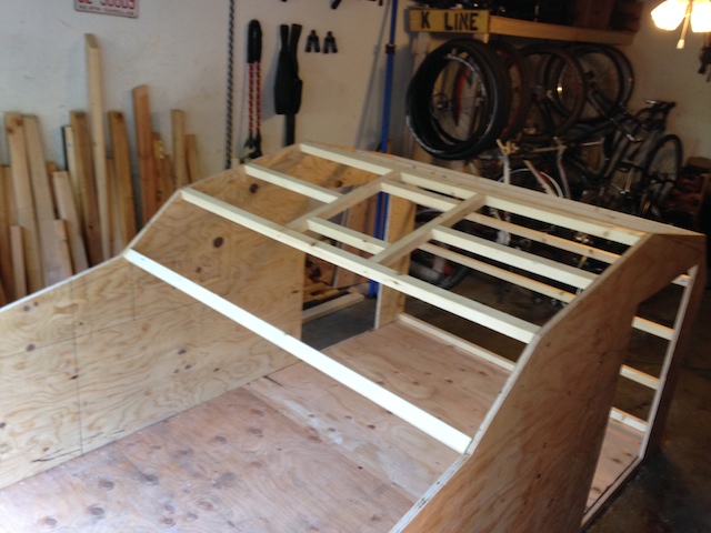

Postby andreuther » Sun Nov 17, 2013 7:00 pm
Thanks for the comments, I am excited to join the club. Of coarse it will be barn red! Here are some photos of my progress.

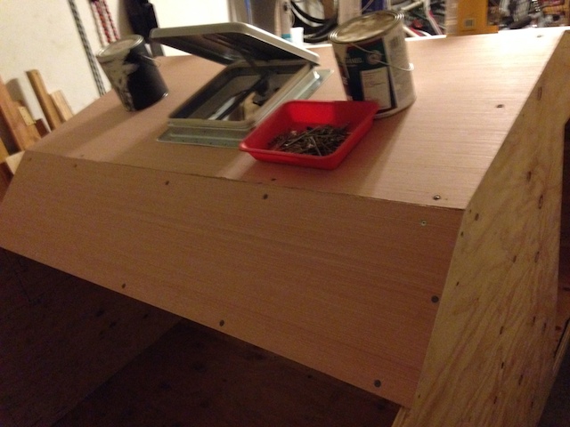

Postby andreuther » Sun Nov 17, 2013 7:01 pm
More pics.

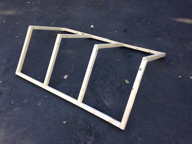

Postby andreuther » Sun Nov 17, 2013 7:02 pm
One more.

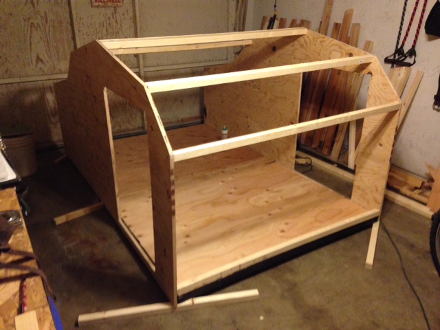

Postby bdosborn » Sun Nov 17, 2013 11:36 pm
Screws in end grain aren't terribly strong, you might want to add some braces to your hatch spars. There will be a lot of leverage acting on the joint when you open the hatch.
2009 6.5'X11' TTT - Boxcar
Boxcar Build
aVANger Build
bdosborn
Posts: 5594
Images: 806
Location: CO, Littleton
Re: Barndrop build
Postby andreuther » Mon Nov 18, 2013 1:12 am
I completely agree with you, however I also used glue. The screws were only used to hold the frame in place while the glue dried. The frame is quite rigid by itself, and with the skin it is stronger then it needs to be. I would take glue over a brace any day. Thanks for looking out!

Postby SLUG36 » Sat Nov 23, 2013 2:16 pm
you should be good on the hatch. when skinning it. the skin will lap the joint on the top.

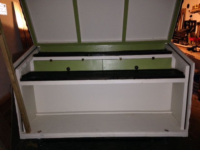

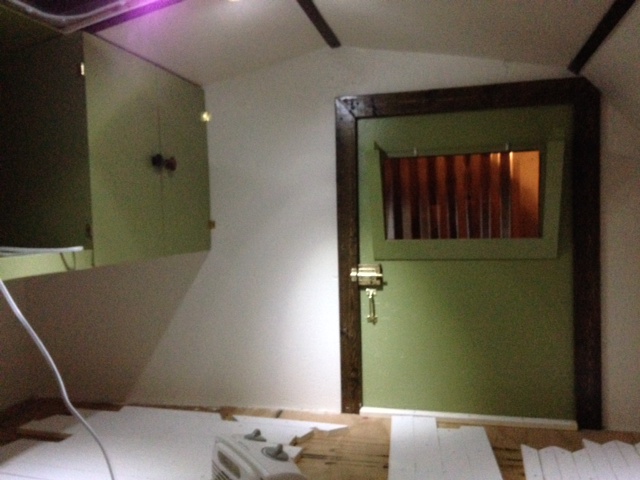

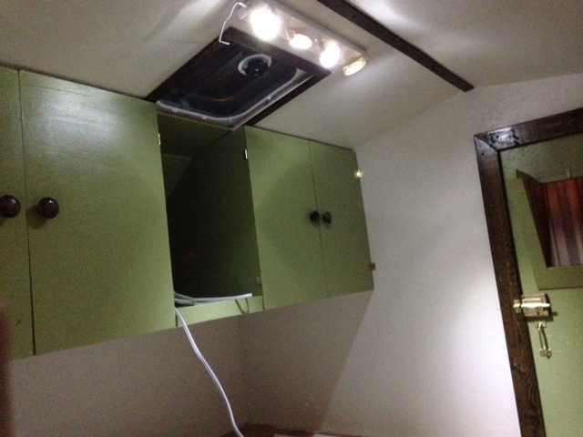

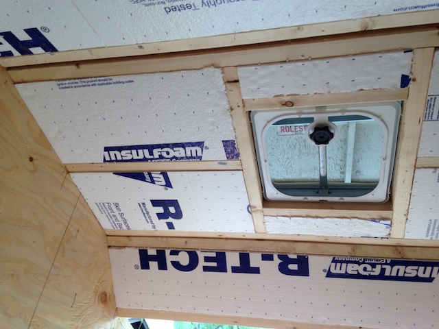

Postby andreuther » Fri Dec 06, 2013 11:52 pm
Well I have been busy. I still have a lot of trim work and calking left. Here are some updated photos.
