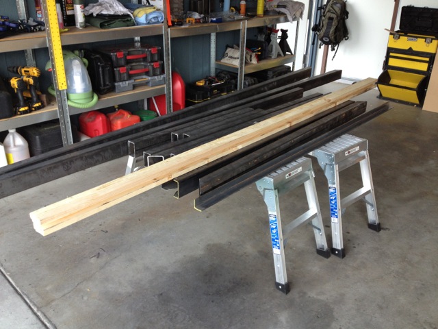

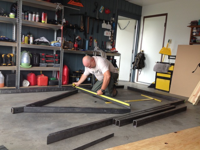

Got my steel

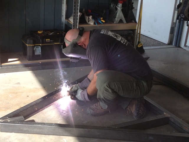

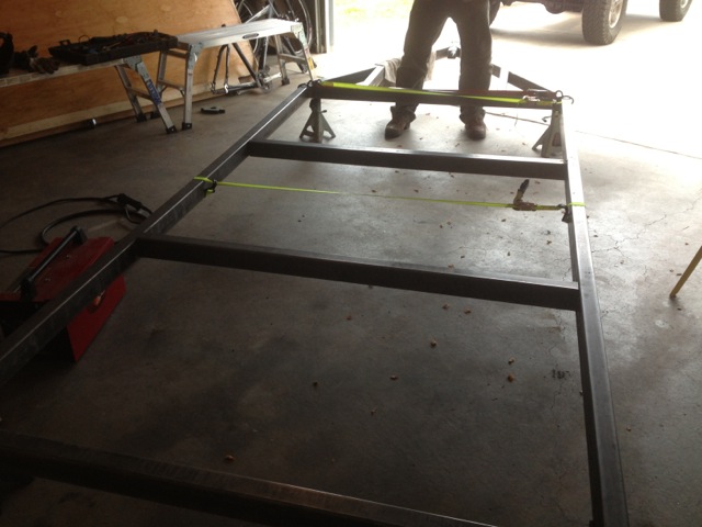

Laying out the frame
Yep it's only a 110 volt welder

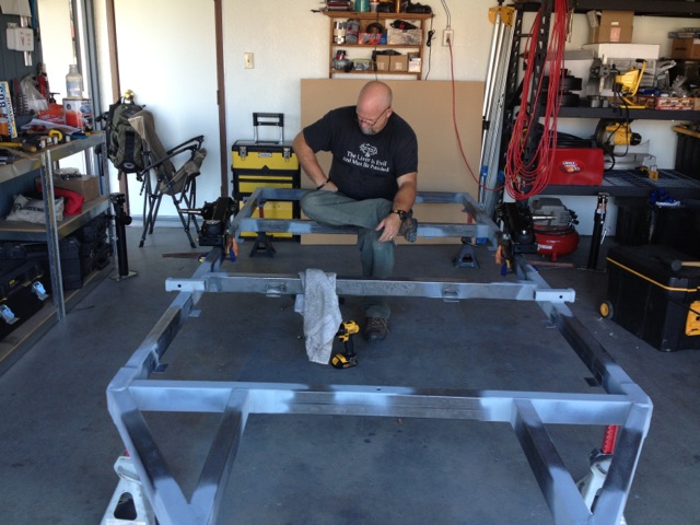

Frame tacked together

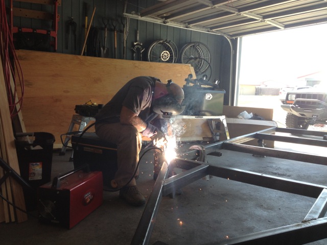

Welding it up
Laying out axels

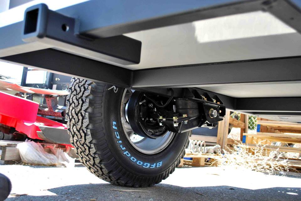

Postby nvygun » Sat Nov 09, 2013 11:36 am
Here is a picture of the axel's I used on my trailer. Since I plan on off roaring with this trailer I went with the 3500 lbs axels.
the bolt on axel on an Adventure Trailer

Postby AlgoDan » Sat Nov 09, 2013 11:42 am
Dam that suspension looks sweet, well done. Keep the pictures coming... :thumbsup: :beer:
nvygun wrote:Here is a picture of the axel's I used on my trailer. Since I plan on off roaring with this trailer I went with the 3500 lbs axels.

Postby jonnyo » Sun Nov 10, 2013 9:45 pm
wow...nice suspension.... i would like to do something like this...just not sure if i m skilled enought for it!!!

Postby KCStudly » Sun Nov 10, 2013 10:41 pm
Cool. I'm looking forward to more of your build story.
Did you have them de-rate the spring rubbers? Having the big brakes and robust suspension is a good call, but having stiff springs/rubbers on a much light camper would be harsh.
What do you think you final loaded weight will be?
Re: Battle Born Benroy
Postby aggie79 » Mon Nov 11, 2013 10:52 am
KCStudly wrote:Cool. I'm looking forward to more of your build story.
I with KC...can't wait to see further progress and :pictures: on your build!
KCStudly wrote:Did you have them de-rate the spring rubbers? Having the big brakes and robust suspension is a good call, but having stiff springs/rubbers on a much light camper would be harsh.
Isn't this the Timbren suspension unit? If so, I don't think they can de-rate the spring, but I believe you can get a 2000# spring on a 3500# suspension unit.

Postby KCStudly » Mon Nov 11, 2013 11:28 am
Yeah, what Tom said. ;)

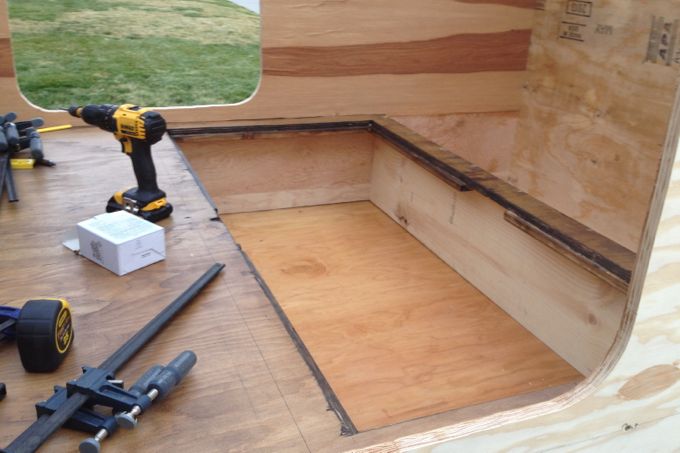

Postby nvygun » Mon Dec 23, 2013 9:10 pm

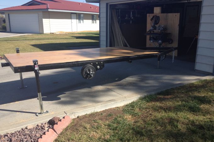

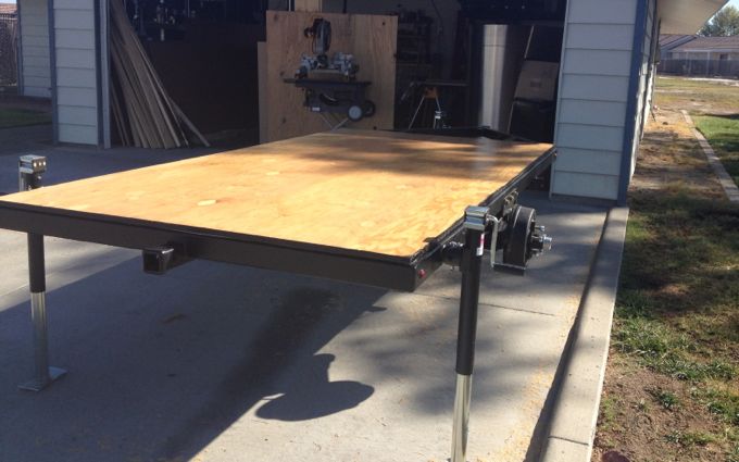

I've been having some trouble getting pictures uploaded but I think I may have it now. This is the next series of pictures of the finished frame and assembly to skinning.
Frame 2.jpg (59.01 KiB) Viewed 1322 times
Frame 1.jpg (48.19 KiB) Viewed 1322 times

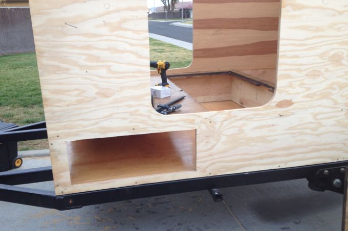

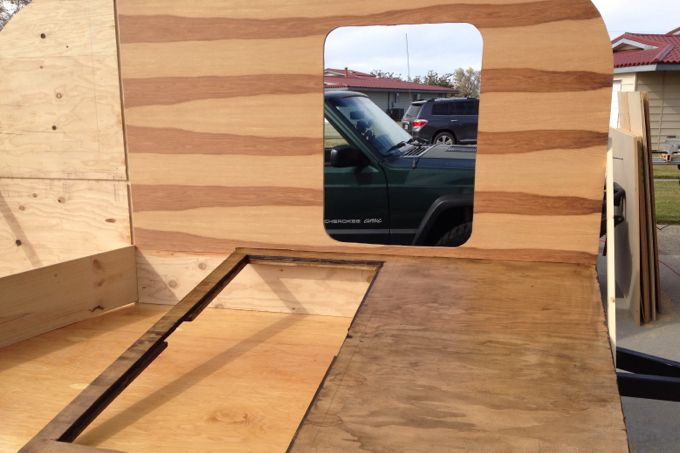

Postby nvygun » Mon Dec 23, 2013 9:16 pm

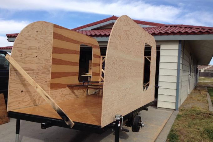

Here is the assembly of my teardrop. It is 5x10 plywood. I am using the extra foot underneth the trailer for storage and a 27 gallon water tank.
Assembly 1.jpg (52.02 KiB) Viewed 1321 times
Assembly 2.jpg (49.09 KiB) Viewed 1321 times
Assembly 3.jpg (64.11 KiB) Viewed 1321 times

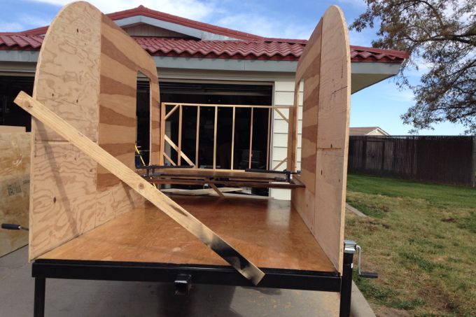

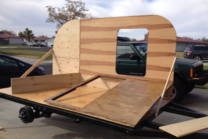

Postby nvygun » Mon Dec 23, 2013 9:19 pm
Few more assembly pictures.
Assembly 4.jpg (52.58 KiB) Viewed 1318 times
Assembly 7.jpg (43.85 KiB) Viewed 1318 times
Assembly 6.jpg (48.69 KiB) Viewed 1318 times
