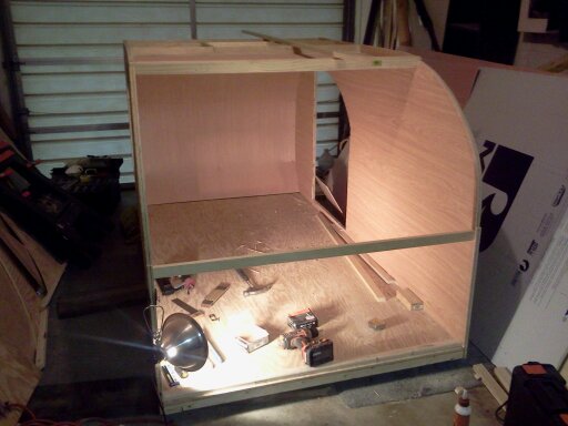

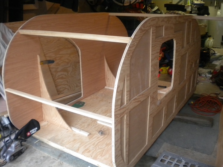

Postby rick e » Sun Nov 17, 2013 8:12 pm
I was able to do some cutting today. It gets dark so early.114383114382

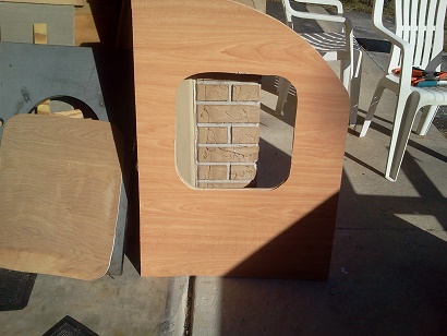

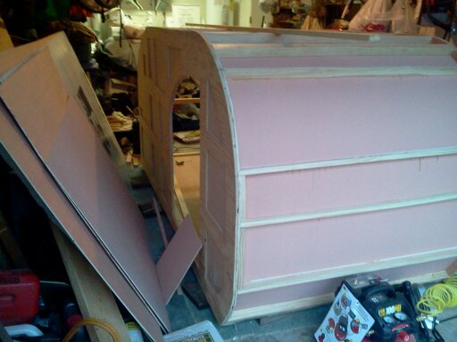

Postby rick e » Sun Nov 24, 2013 6:47 pm
114638114637
I left some room for a wider window. This cutout is from one I got on ebay and it is crap. I'm still looking.
Decided to remove the bottom radius from the door to ease trimming it.
I will clean up the outer cuts with the router and templates. Finally found it after searching all morning in the garage. Haven't found the bits yet.

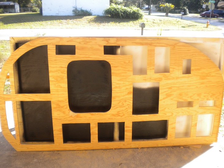

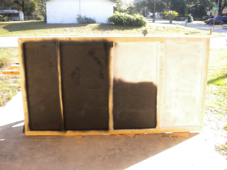

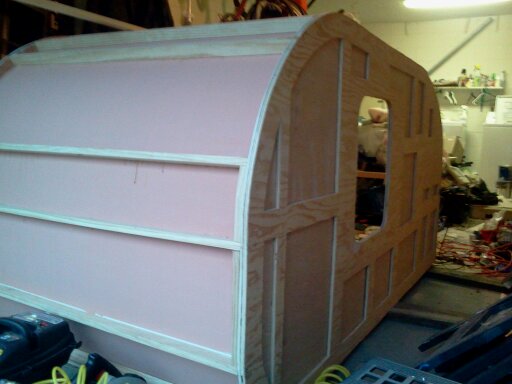

Postby rick e » Sun Dec 08, 2013 7:58 pm
Ready to start assembling the thing now. a lot of cutting. I had some spray rubberized leak seal I decided to use on the underside, bad idea. Had to go buy 2 more cans at $9 each. Could have bought a gallon for $8.00.

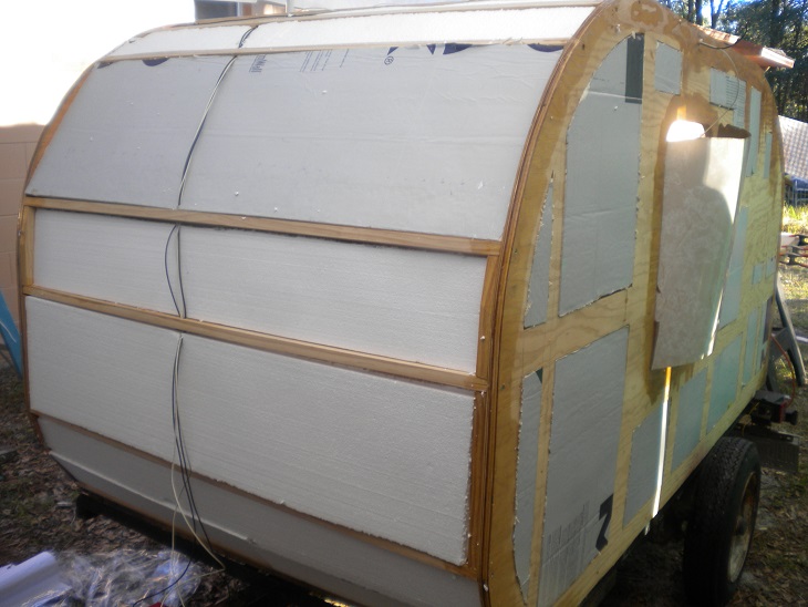

I am still thinking about how I want the inside cabinet and the galley. Local store only has 1/2 and 3/4 insulation. I haven't decided what to put in the roof yet. Someone here said they doubled it up.

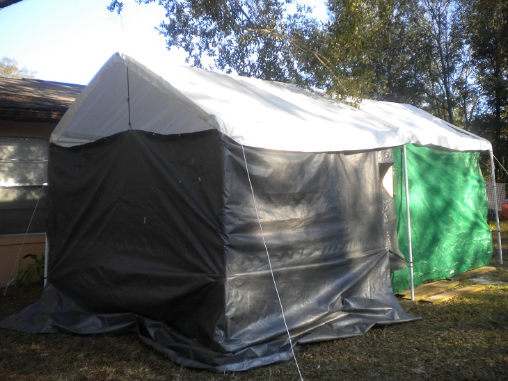

So this weekend should be in the 80's and I have my list of to-do's....CPES, wiring, interior cabinets and utility run. Also insulation, cutting those little shapes is a tedious job.
Probably will buy another canopy and move the whole process out back as I have threatened to do. The motorcycle is starting to show corrosion from being outdoors and needs to go back in the garage.

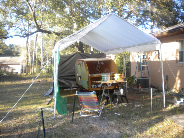

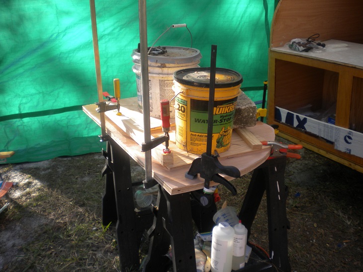

Postby rick e » Sun Feb 16, 2014 5:24 pm
the famous gravity clamp.
This is an appropriately named build. Slow progress is better then no progress though.
Fiberglassing the outer panels is taking some time and the weather has not cooperated.
I did move my shop outdoors and that is working out ok.
