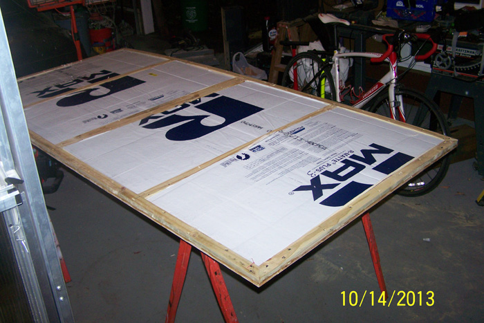

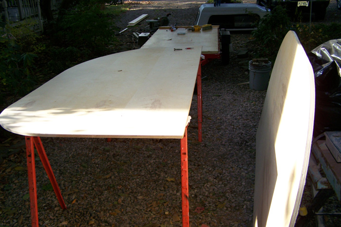

Postby FARMINGDALEHC » Sat Nov 16, 2013 9:03 pm

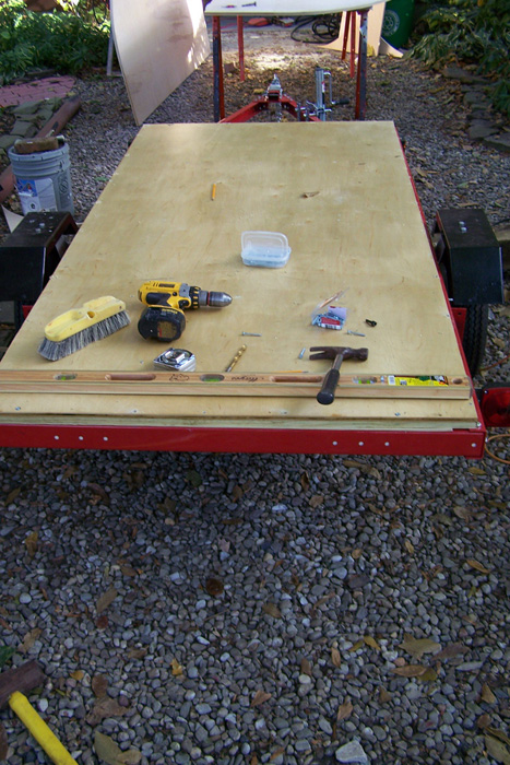

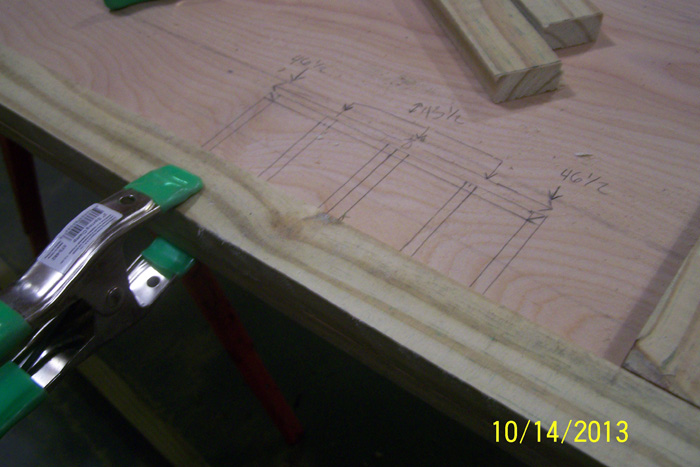

basic insulated floor plans
attaching 1x2 treated pine to 3/4 birch
hot floor
floor complete.jpg (159.77 KiB) Viewed 2627 times

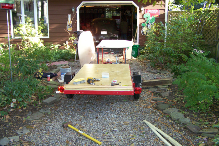

Postby FARMINGDALEHC » Sat Nov 16, 2013 9:07 pm
floor attached to harbor freight orange utility trailer insulated with 11r 2 inch insulation board. attached with self taping bolts
floor on trailer.jpg (238.02 KiB) Viewed 2627 times

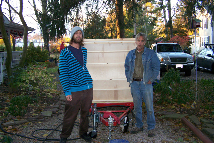

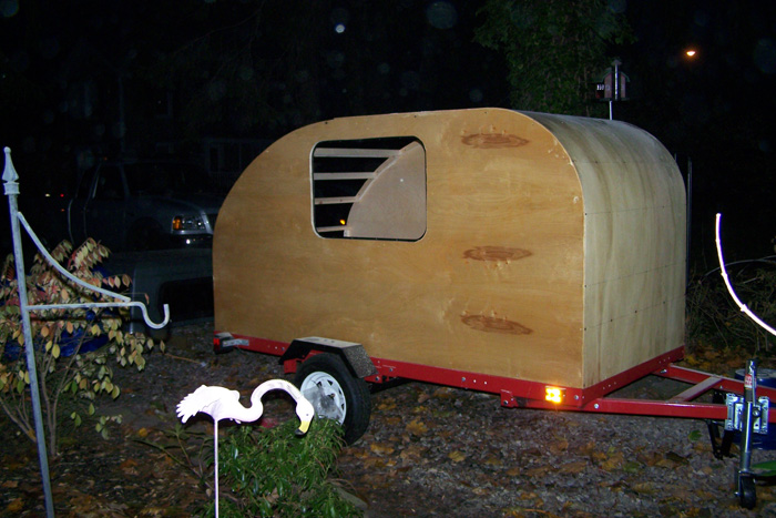

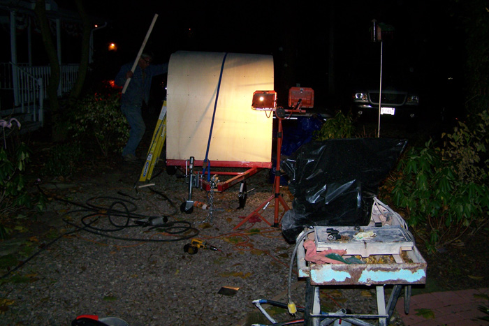

Postby FARMINGDALEHC » Sat Nov 16, 2013 9:11 pm

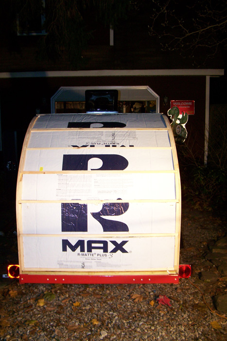

more action :applause:
closer

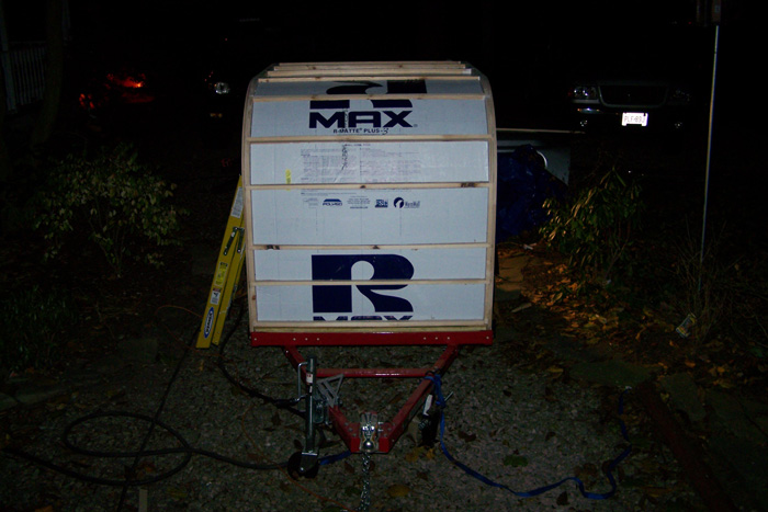

benroy outline
just a couplea doods

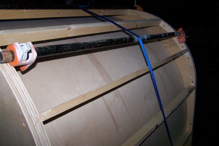

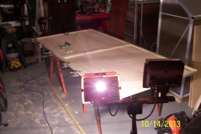

Postby FARMINGDALEHC » Sat Nov 16, 2013 9:16 pm
bending 1/4 inch birch to the interior of the sno drop
neeeds more? screws!
two layers of insulation board

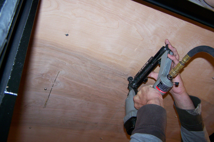

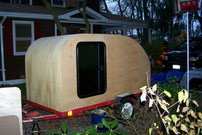

Postby FARMINGDALEHC » Sat Nov 16, 2013 9:19 pm
8)
outer skin was cake. 1/4 inch sand ply

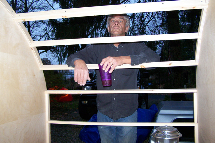

Postby FARMINGDALEHC » Tue Nov 19, 2013 10:41 pm
that sounds cool. i am far from delicate tho and being 6 3 200 pounds i might fall thru something like that after too many tequilla sunrises lol. my fabulous mother/roomate took some pictures of progress me and my other roomate/dad made over the weekend. recieved my shipment from vintage tech. super stoked on the quaility and the women i spoke too was a sweethart. picked up 4 sheets of .040 aluminum over the weekend hopefully get that up by next weekend. (i know most people use . 032 on the sides but i got a good quantity discount(bicycle mechanics build ona budget)) :wine:

Postby FARMINGDALEHC » Tue Nov 19, 2013 10:45 pm
insulated rear
closing the rest of the trailer in from the inside
:worship:
