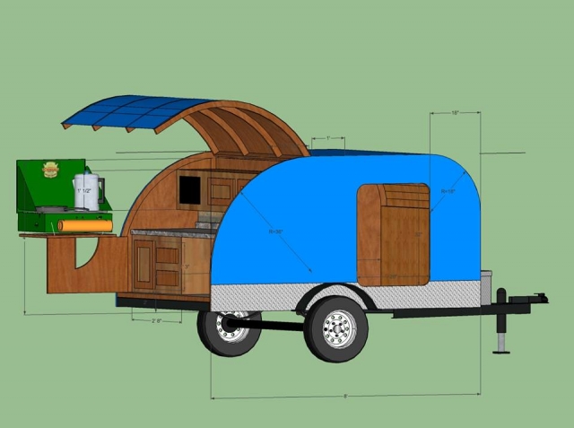

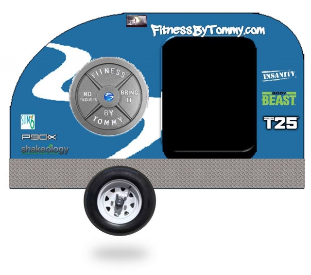

Here is the design sketch for the finished TD.

Here is the Google Sketch-Up Design

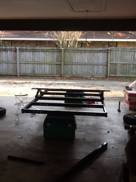

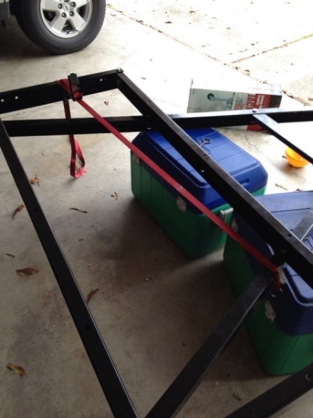

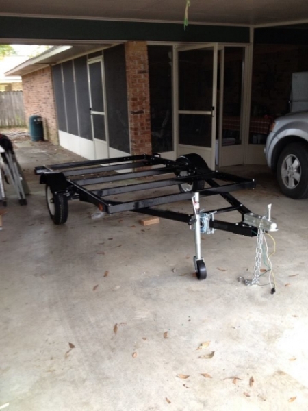

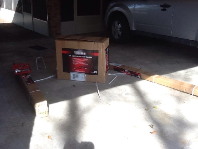

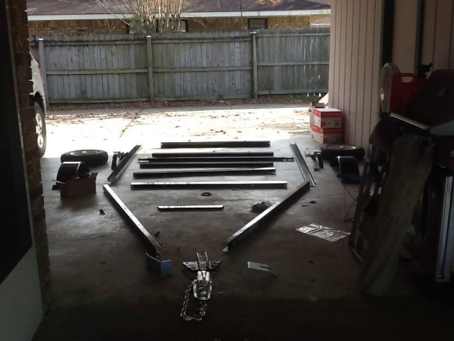

Northern Tool stopped selling it's 5x8 trailer and now sells this Ironton trailer. All of the specs are the same.
The trailer was a little out of square so I used a ratchet strap as a come-along
HEY IT'S A TRAILER!

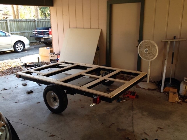

Missed a week of working on it due to a bad cold, but i finally got the floor framed up. I found out the trailer was out of square, so I had to loosen all the bolts put a ratchet strap across it diagonally, then beat it in to submission with a rubber mallet. Finally got it aligned. I have the front 2 openings framed for storage compartments.

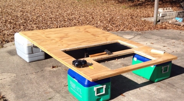

When I bought the plywood for my floor, the sheathing grade I saw at Lowes was crap. So I bought the hardwood ply that was primed and ready to paint. I wasn't thinking about the CPES that I was going to seal it with. So I spent most of the weekend sanding off the primer on one side to apply the CPES. After that I'm going to prime it again with 2 coats of Zinsser Oil-Based Primer, and then the Asphalt compound. I'll paint the upper surface with an oil-based paint just to help seal the moisture out, then cover it with vinyl flooring.
