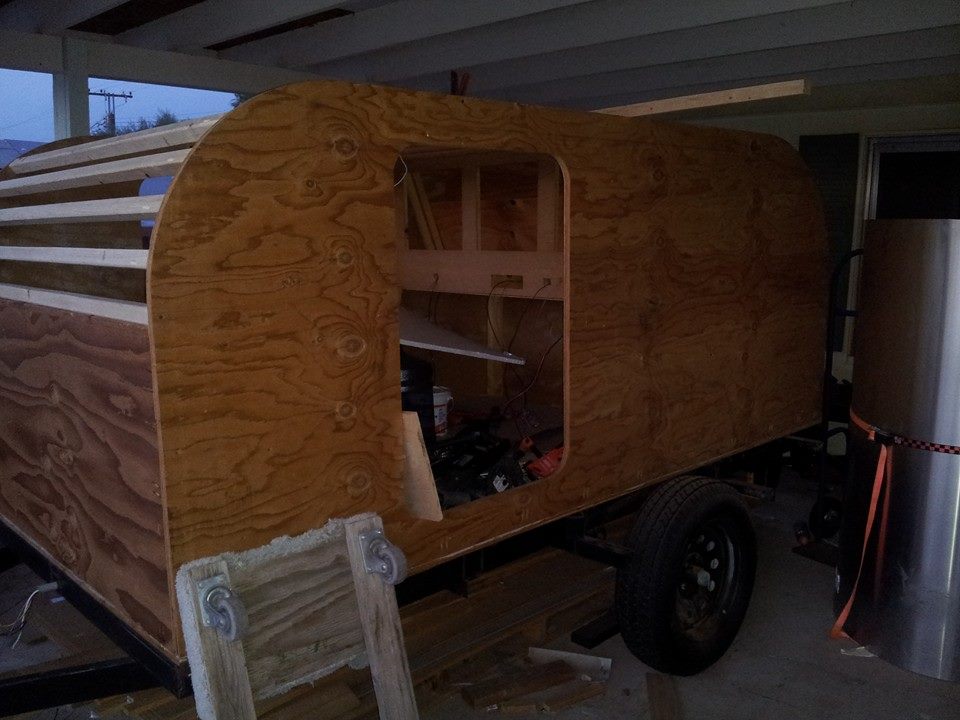

Well I had this whole spiel on my design, what ive done and what im doing but my computer booted me and it was all erased so your going to get the super short verson now. So ive had this project for a while (a few years time/money issues) I liked the moby 1 XTR so I am emulating its profile and some ideas along with other ideas I have recieved from manufacturers and self builds. My rig is 5x10 that started out as a salvaged flatbed trailer. By the time I am done it should have all the bells and whistles. as you can see the profile of my rig is very simalar to the XTR. Hence the name XTJ

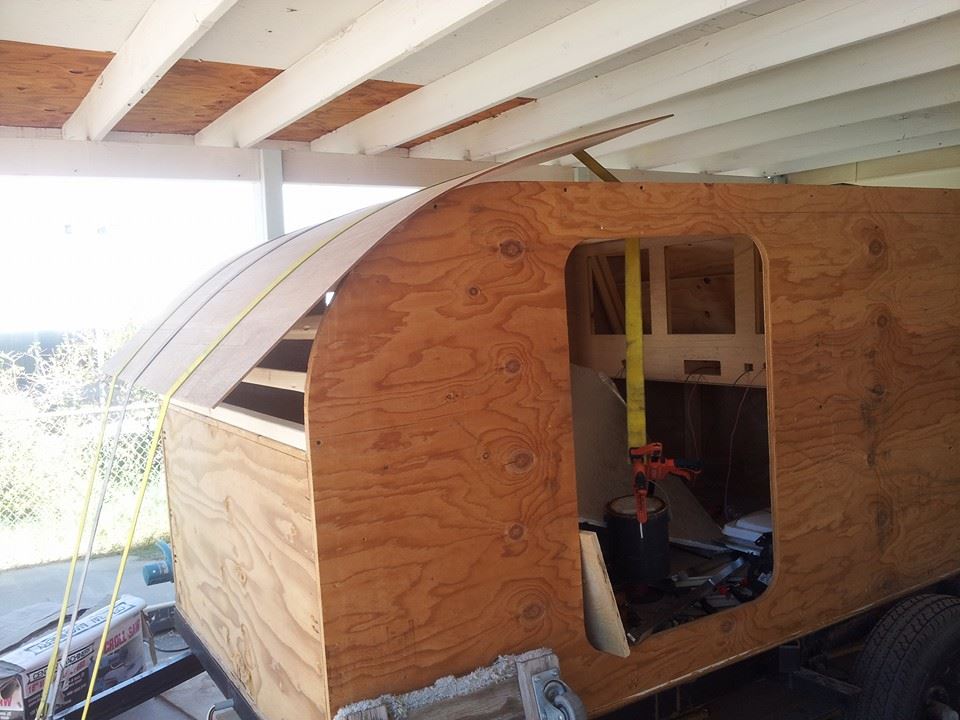

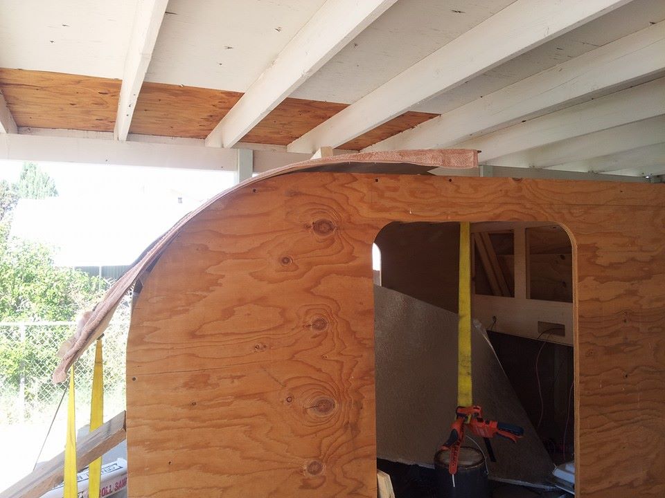

Well several months later and I am finally working on the trailer again. I had to stop work on the trailer due to building an addition onto our house. As far as an update, I had to tear out the 1x2 roof spars. When I started to put the plywood headliner in, the pressure from the flexing wood was too much. So I took them out and replaced them with 2x2's and some screws that had more bite to them. I also learned that my plyboard Is not as flexible as I thought and I should probably pre-bend the wood and/or score the back side of it before I try and install it again... Its funny Ive read dozens of posts about being patient with the luan (sp?) but of course I thought If I used enough staples I'd be ok. Which was WRONG.

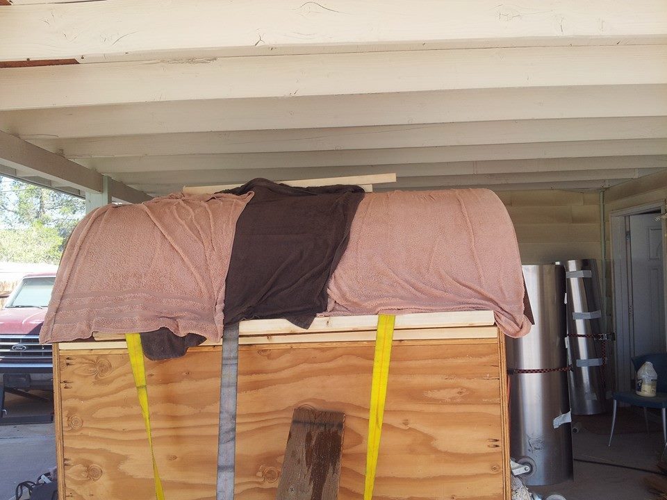

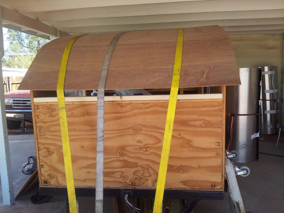

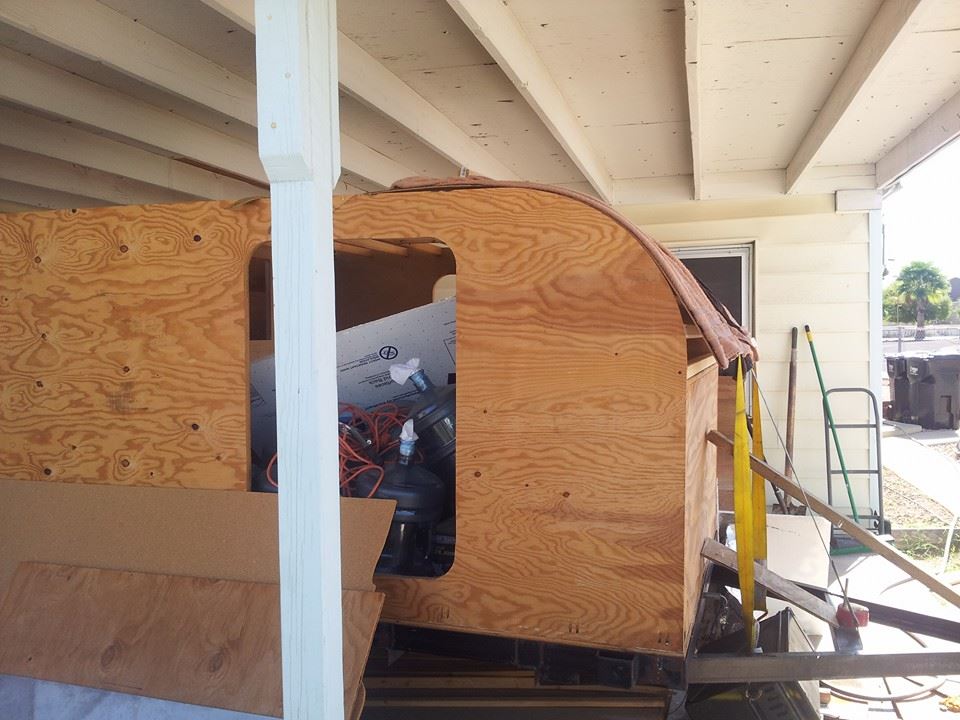

Pre-bending the headliner. Last time I tried to install it without doing so, things broke and I think I made up some new curse words.

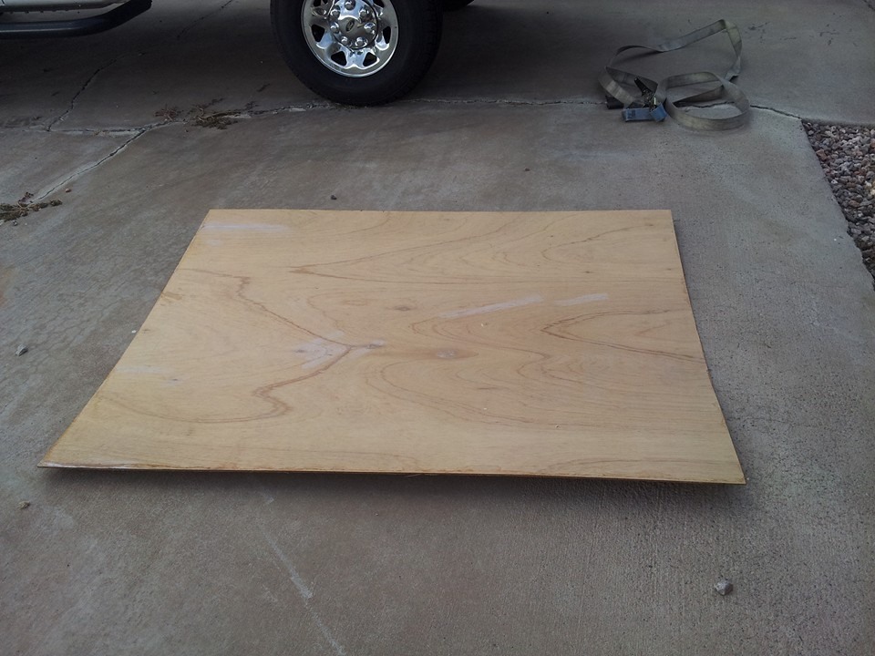

Postby mrjoe104 » Sun Oct 19, 2014 1:45 pm
headliner bend.jpg (147.8 KiB) Viewed 9957 times
After 3 days of wetting and bending this is the curve I ended up with... I am going to try scoring the back to make it a little more bendable for installation. If that doesn't work then I am going to work with the grain. The reason why I haven't already is because the trailer is 5x10 while my luan is 4x10. The trailer also narrows a few inches towards the back. So I would have to cut 2 pieces of luan down their 10' lengths without a table saw and try and taper them so the seam stays center with the trailer. Which I can see would make me super frustrated if it doesn't turn out right. Not to mention I would waist 2 sheets of luan, which would make the wife sooooooo happy when i have to buy more materials.
